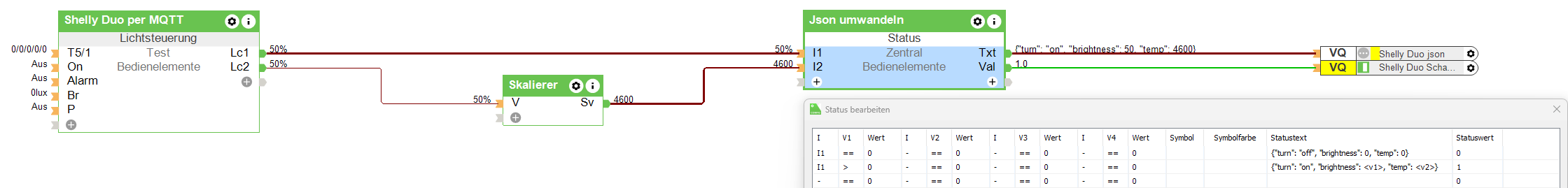

Hello, i have a question regarding shelly duo output virtual command. The on off command works fine but i cant seem to have the brightness and output commands to work, i think its a problem with the command writing. Does anyone have a working command for brightness and temperature control of the shelly duo in loxone?

With MQTT, you’ll have to publish a json with the values:
Hilfe für die Menschen der Ukraine: https://www.loxforum.com/forum/proje...Cr-die-ukraine -
Simply paste the example json AFTER the topic in the VO Command as a first test.

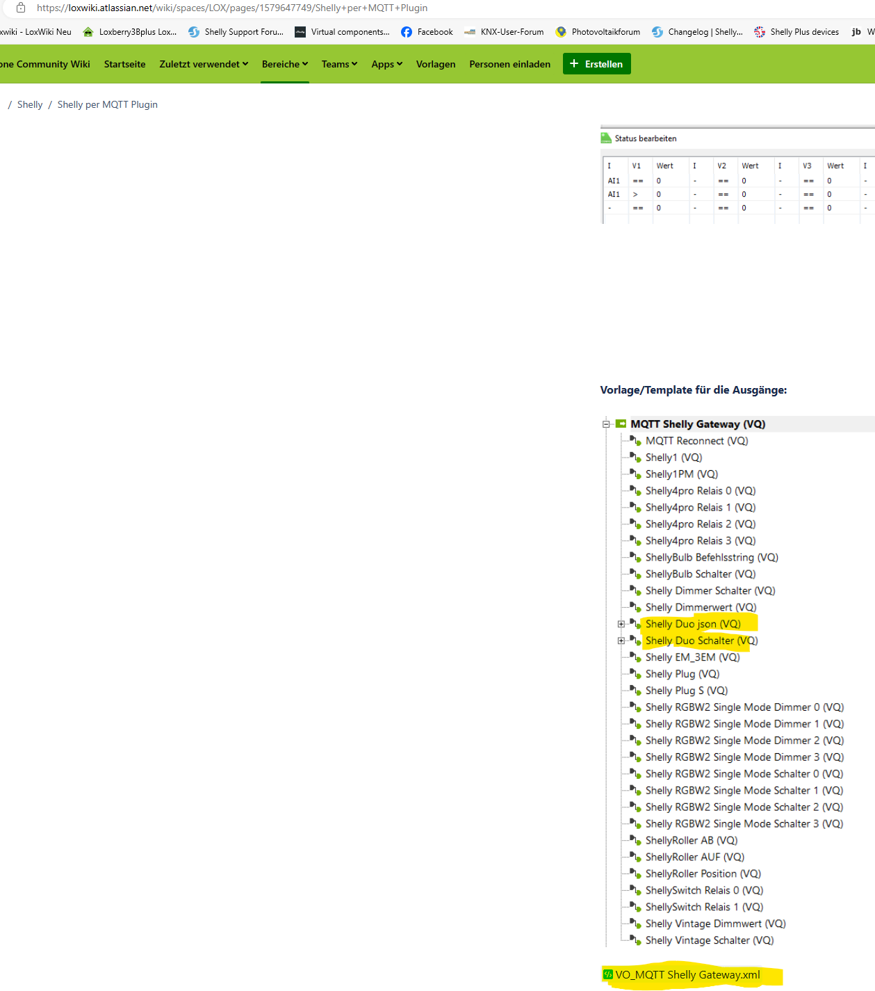

You can use the Quick Publisher in LoxBerry for testing.
I’ve no example, but possibly there is one in the Shelly article in LoxWiki.euZuletzt geändert von Christian Fenzl; 05.04.2024, 08:52.Hilfe für die Menschen der Ukraine: https://www.loxforum.com/forum/proje...Cr-die-ukraineKommentar
Thats what i have tried but it does not seem to work:
The output command for on is:
shellies/ShellyBulbDuo-<deviceid>/light/0/set {\r\n "brightness": 100, /* brightness, 0..100 */\r\n "white": 0, /* white level, 0..100 */\r\n "temp": 2700, /* color temperature in K, 2700..6500 */\r\n "turn": "on", /* "on", "off" or "toggle" */\r\n "transition": 500 /* One-shot transition, `0..5000` [ms] */\r\n}
There must be something wrong with the written command and i couldnt find any other resources to help.
You have to remove the comments from the example!Hilfe für die Menschen der Ukraine: https://www.loxforum.com/forum/proje...Cr-die-ukraineKommentar
tried it, still doesnt work: shellies/ShellyBulbDuo-<deviceid>/light/0/set {\r\n "brightness": 100, "white": 0,"temp": 2700, "turn": "on","transition": 500 , `0..5000` [ms] \r\n}.
