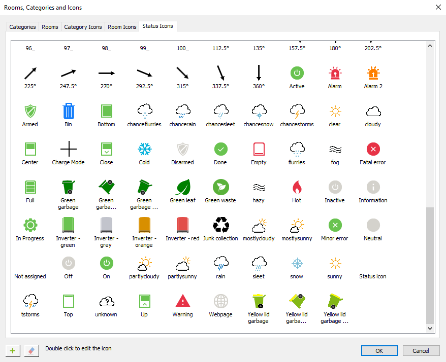

                    Look in the Periphery tree under Icons. Click on 'Status Symbols'; you have the ability to create your own symbols with the 'Edit Icons' tool in the main window.
                    eg. Wind direction arrows
                    Garbage bin 'animation'
                    Weather etc
Name: Status Symbols.png
Ansichten: 2448
Größe: 56,1 KB

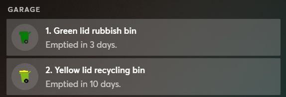

                    The State Block then has the ability to display the chosen graphic. Alongside the graphic, you can include the accurate litres remaining.

                      Tico, that is really useful information many thanks. Where do you get all these extra icons from? Is it a Loxone thing or just around on the net as i only have a handfull in the folder?
                      • Tico
                        • 31.08.2016
                        • 1035
                        I have a mix of downloaded images and self-made ones. To import an image, it needs to be resized to 32x32 pixels in PNG format.

                              Hi Tico, im looking to do a reminder to put my rubbish and recycle bins out, like you have indicated above.
                              Is there anyway you can share your config how you have yours working before the status block?
