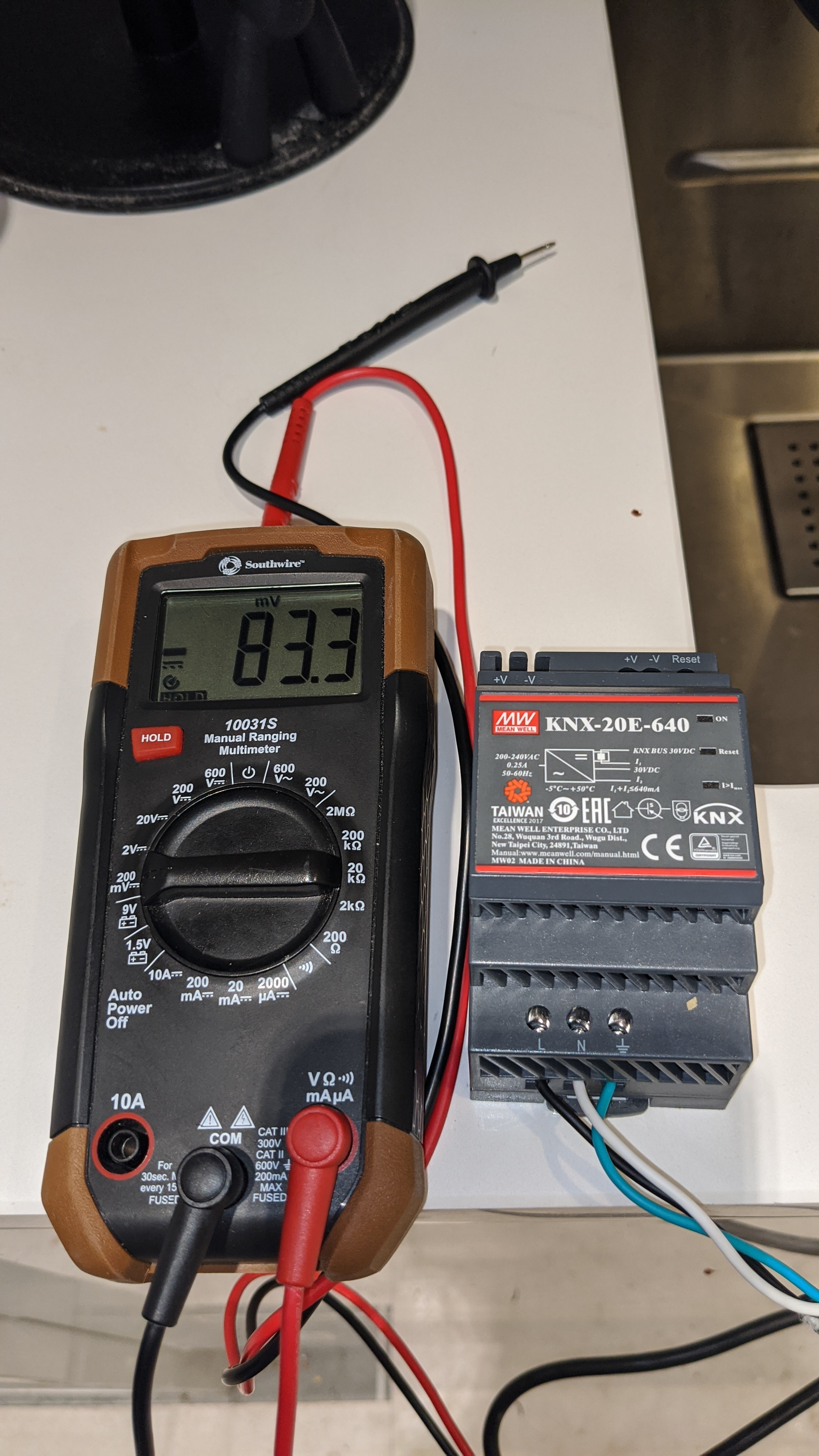

                  I notice that the input voltage range for the Meanwell KNX power supply is 180-264 VAC. Can I assume that your nominal house voltage is 110VAC in the USA? This is not likely to work.
                  Klicke auf die Grafik für eine vergrößerte Ansicht  Name: Voltage range.png Ansichten: 2 Größe: 108,4 KB ID: 257196
                  You will need an AC-AC transformer to suit the European standards of the Meanwell KNX voltage input requirements -

                    I connected my KNX power supply to a 110v outlet. Without anything connected, I measured only 83mv. In addition, none of the lights turned on. I tried the reset for 20 seconds but that cause any change. Is there something wrong with the power supply? In my earlier post, I had explained that the KNX power supply wasn't in use. The reason is because I thought there was something wrong with it. Does anyone else have this power supply? Is it working properly?
                    I was expecting a 30v output. Is it different with a KNX supply?

                      Did you read post #11? It won't work with 110VAC.

                        • 2613
                        a good point.
                        Zennio, ABB, Weinzierl and Jung have KNX Powersupplys with wide range Input capable of 110V .
                          • 2613
                          If you want to use your Meanwell KNX Powersupply together with a input voltage transformer (110v to ~230V) you still have to make sure that, you use the right output on the KNX Powersupply.
                          Most KNX Powersupplys ( even the Meanwell ) have two outputs , one for the main KNX Bus (that one with the small red/black connector) and that one with the screw terminls ( helper output, but not usable for the KNX Bus itself )
                          You have to use the output with the small red/black connector. The other output has no choke installed and so will preven data transmition.
