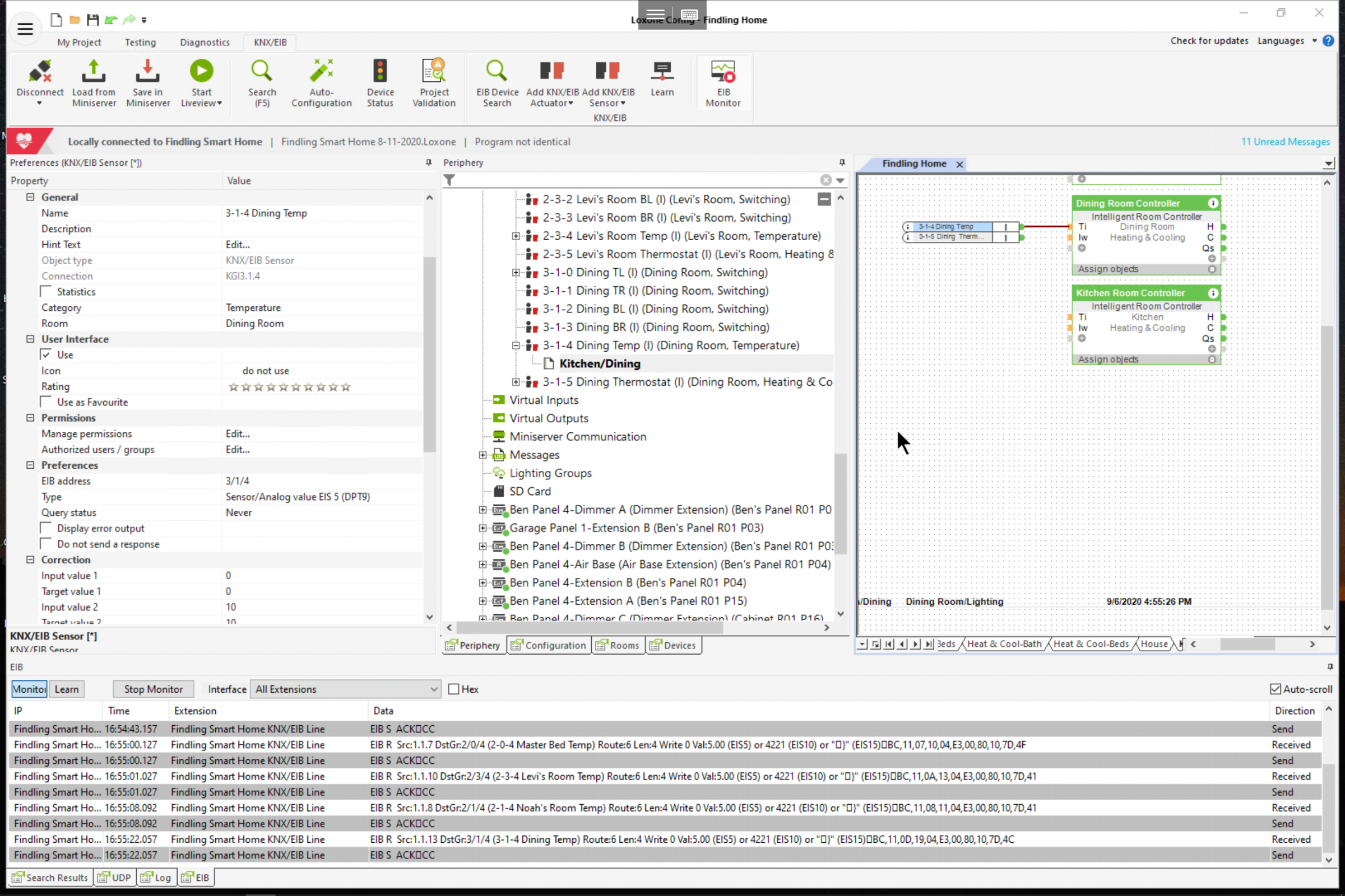

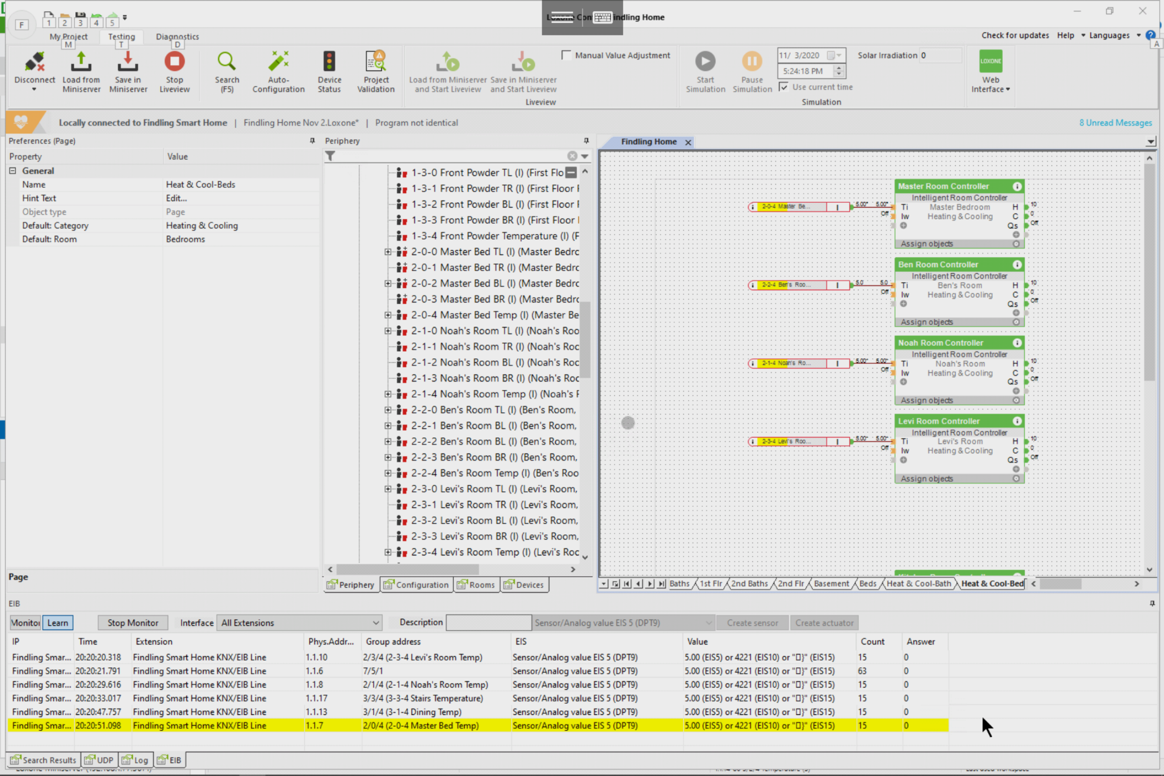

        Question Two: I am still having problems getting proper temperature values from the integrated thermostats. I had Loxone support help me setup ETS 5 for the temperature sensor. I have attached three screen shots. The first is my ETS 5 setup. The second is my EIB Monitor in Config and the third is a better display of the temperature settings. What have I done incorrectly?

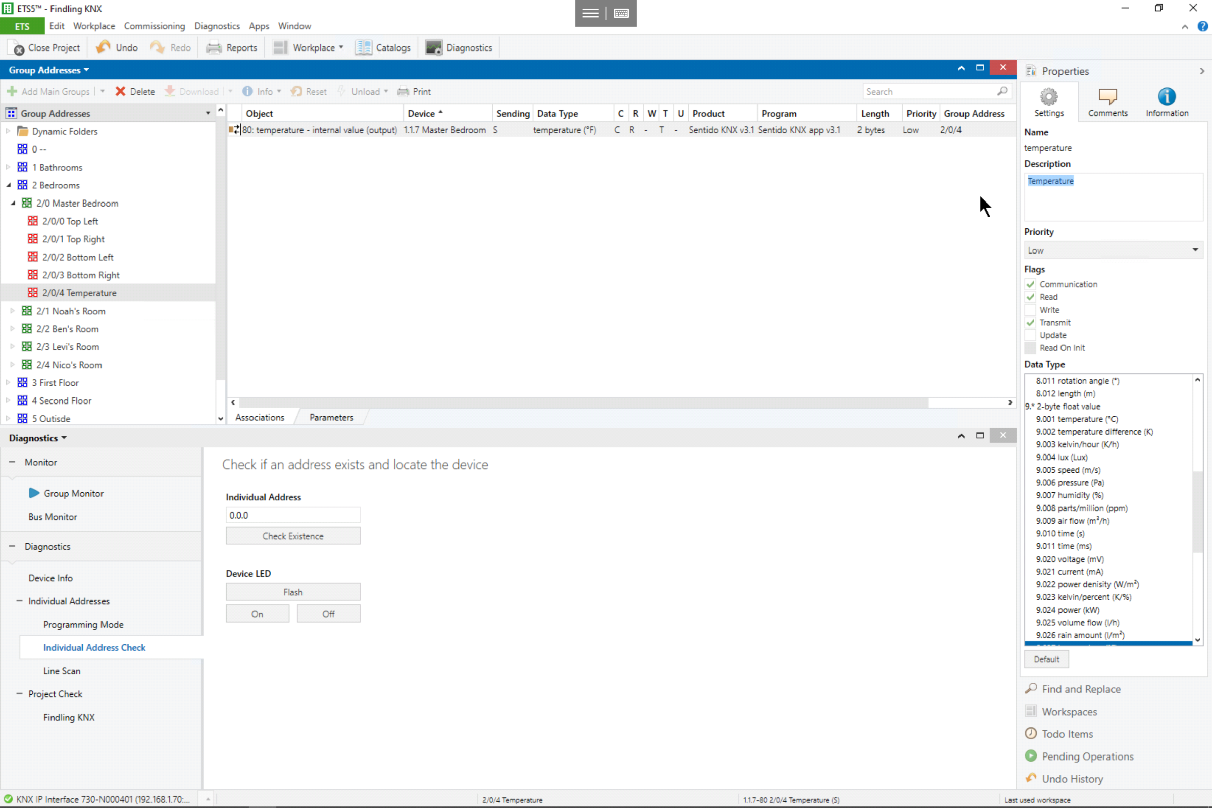

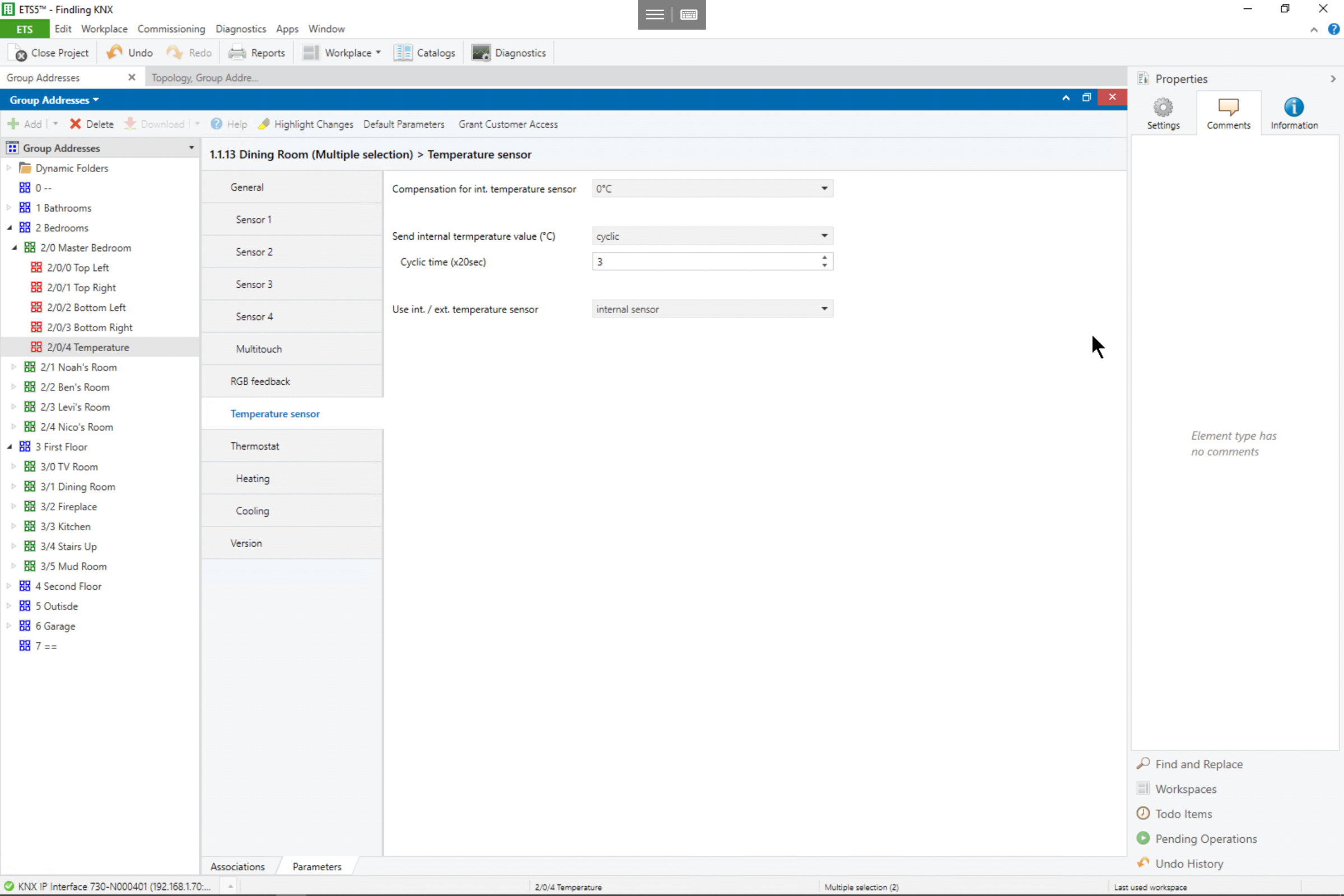

              I have installed KNX Sentido capacitance switches with integrated temperature. It has been explained that I should stick with Loxone for control and only use ETS5 for KNX configuration. In ETS5, I have configured the four capacitance sensors with individual addresses and the temperature sensor. The data type is set at 9.027 Temperature Sensor, Fahrenheit for each room. You can see a screenshot below.
              Loxone recognizes the group addresses and shows communication in the EIB monitor. I have included a screenshot of the EIB monitor. In Loxone, I have created an EIB sensor for each temperature KNX device. It doesn't appear that the KNX switches are properly configured in ETS5.

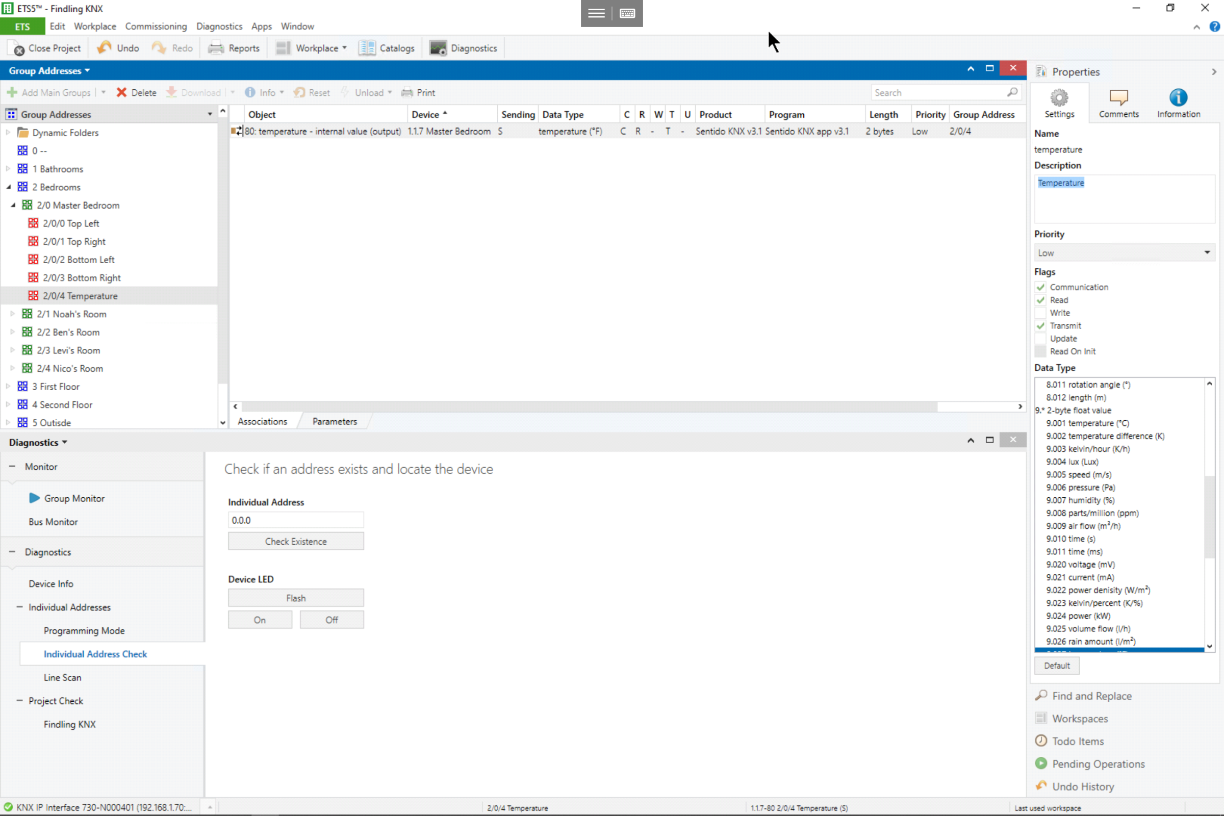

                Question Two: Have you tried changing the temperature setting in ETS to Celcius? I would be curious to see what occurs if the Data Type is saved to the switch as "9.001 temperature (°C)".

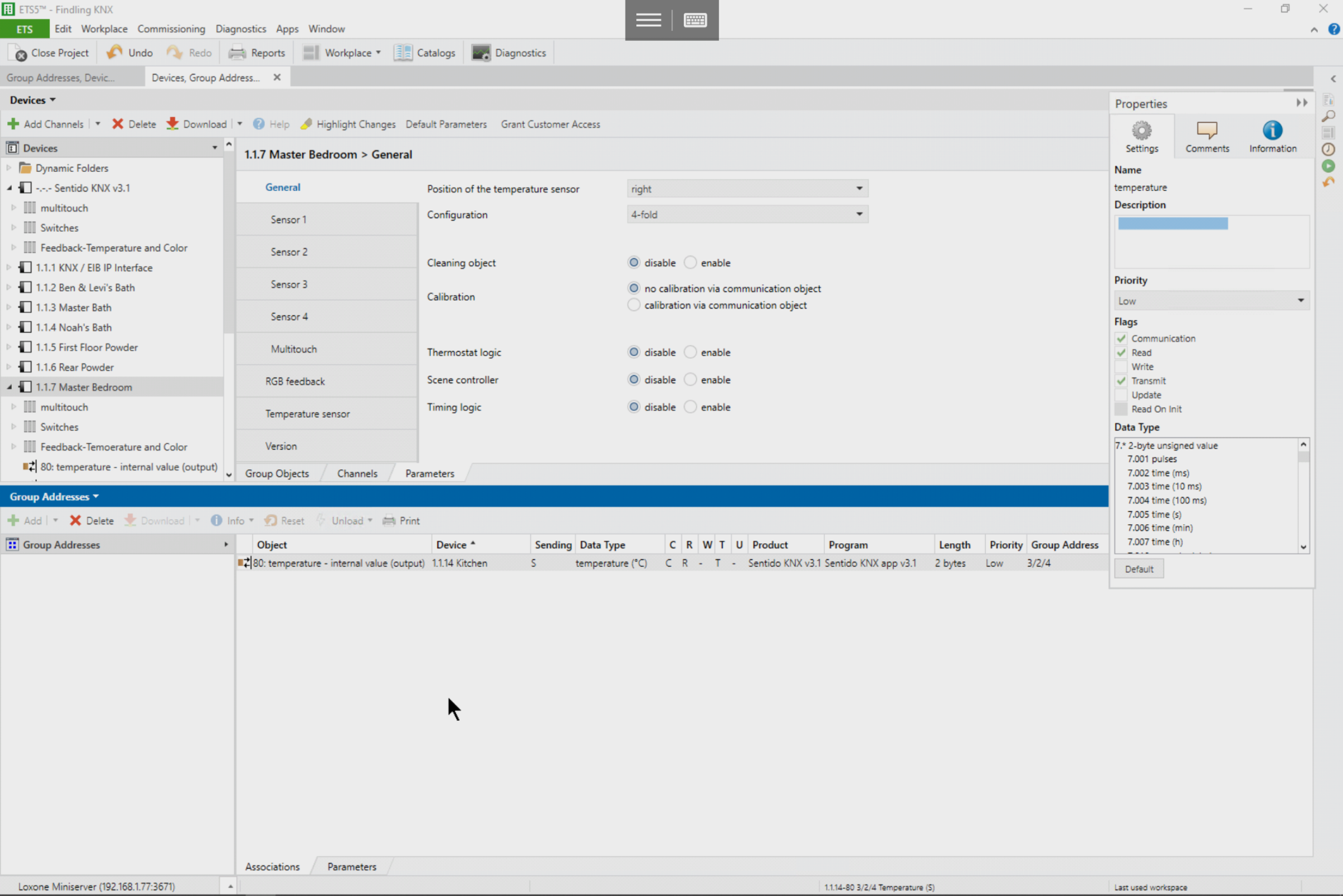

                  I made the change your suggested in ETS5 but it didn't change the output. Loxone config still shows 5℃. Any other ideas?

                      It doesn't look as a problem with Loxone but with the switches itself. Loxone receives 5 degree from the correct physical addresses, therefore they are sending this.
                      Check again, that in ETS you have assigned the group addresses to communication object 80 of the devices, and have saved it to the devices, and have saved to the Miniserver.
                      There is nothing else to configure in the switch for the temperature output.
                      If nothing helps, I would contact Basalte with your issue.
