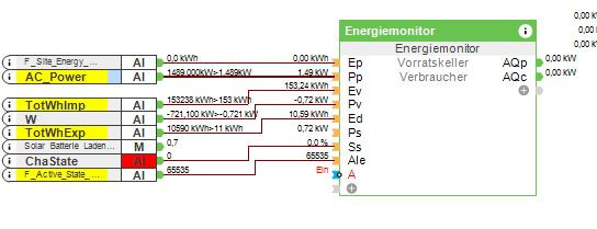

    i have one other problem
    on Pp i have connected my actual production (AC_Power) but on AQp is notting shown, also not on the visualisation.
    Klicke auf die Grafik für eine vergrößerte Ansicht  Name: inverter.JPG Ansichten: 0 Größe: 36,1 KB ID: 267160
    Zuletzt geändert von renezs; 27.09.2020, 19:10.

    at time i have some values from the inverter. But maybe not the right.
    The modbus device adress for the smart meter youn can choose over the webpage of the inverter. The preset her was 200.

  • Tico
    kommentierte 's Antwort
    One difference I did read with the new smart meter is the Modbus device address -
    Fronius Smart Meter 63A-3 has factory value 240.
    Fronius Smart Meter TS 65A-3 has factory value 1.
