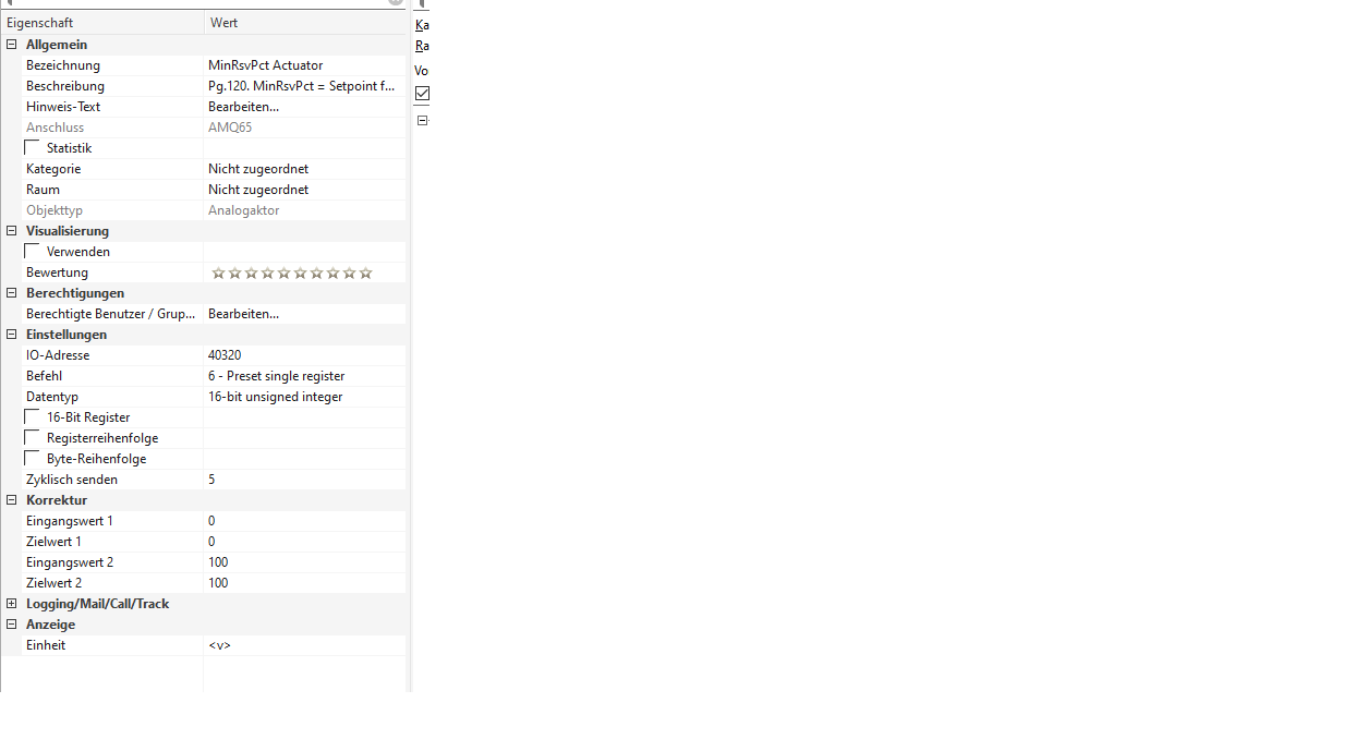

  • Tico
    antwortet
    I looked into the Excel spreadsheet for the Gen24 Modbus values. Yes, there are some very different numbers published for the relevant actuators. Every sensor/actuator has a different Modbus address to the Fronius Hybrid. It appears Fronius has just added 40 to the relevant Hybrid value to define the Gen24 value. I attempted to attach the spreadsheet I'm referring to, but needed to change the file extension. Change it back to .xlsx.
    Gen 24 (all values +40 from Fronius Hybrid)
    WChaMax = 40356 (40355 in Lox Config),
    WChaMax_SF = 40372 (40371 in Lox Config),
    StorCtl_Mod = 40359 (40358 in Lox Config),
    InWRte = 40367 (40366 in Lox Config),
    OutWRte = 40366 (40365 in Lox Config),
    InOutWRte_SF = 40379 (40378 in Lox Config),
    MinRsvPct = 40361 (40360 in Lox Config),
    MinRsvPct_SF = 40375 (40374 in Lox Config),
    Fronius Hybrid
    WChaMax = 40316 (40315 in Lox Config),
    WChaMax_SF = 40332 (40331 in Lox Config),
    StorCtl_Mod = 40319 (40318 in Lox Config),
    InOutWRte_SF = 40339 (40338 in Lox Config),
    InWRte = 40327 (40326 in Lox Config),
    OutWRte = 40326 (40325 in Lox Config),
    MinRsvPct = 40321 (40320 in Lox Config),
    MinRsvPct_SF = 40335 (40334 in Lox Config),
    Zuletzt geändert von Tico; 09.05.2022, 23:22.

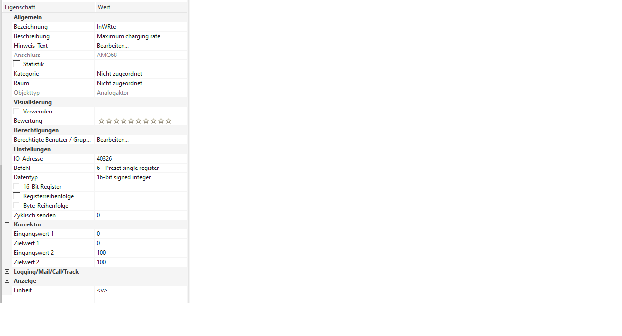

  • Tico
    antwortet
    The picture of the Technician mode with the 'Wechselrichter-Steuerung uber Modbus' is correct. Just confirm that the IP address 6.0.0.21 is the address of the Miniserver, otherwise it won't work. Or simply deselect 'Steuerung einschranken'.
    In the third screenshot, I don't know why you have InOutWRte_SF being divided by WChaMax. InOutWRte_SF should be a value that changes between -2, -1, 0, 1, 2. That value will be connected to AI2 of the formula blocks.
    I suggest you create a Virtual Output between 1 to 100 that plugs into the Formula blocks. If InOutWRte_SF is equal to -2 (like the picture in post #64), the result of the formula should see a value between 0 and 10000.
    Virtual Output = 100, value written to Actuator is 10000
    Virtual Output = 10, value written to Actuator is 1000
    For Minimum Reserve, the Scale Factor always remains at -2. You can set it permanently as per the following picture.
Name: Minimum reserve.png
Ansichten: 1165
Größe: 21,2 KB
    Zuletzt geändert von Tico; 07.05.2022, 15:59.

  • Tico
    antwortet
    Those registers all look fine. I can't see what values you're trying to write to the Actuators. It would help to see a screenshot of your Config layout.
    The attached screenshot shows what the Config looks like when setting a Charge Limit of -10% (ie. Force discharging the battery). The result is a discharge from the battery of ~665 Watts (10% of WChaMax, 6656 Watts). This is from a Fronius Solar Battery.
    Also ensure you enable 'Control via Modbus' as the top priority in the Modbus settings of the inverter. Your value for WChaMax on the BYD battery will also be a different than the Fronius Solar Battery.
Name: Charge Limit minus 10 percent.png
Ansichten: 1323
Größe: 35,4 KB
    Einen Kommentar schreiben:

    ich bin gerade am verzweifeln und hoffe, dass mir hier jemand helfen kann.
    Folgende Hardware ist vorhanden:
    - Fronius Gen 24 Plus 10kW an 11,7kW Photovoltaik über zwei Stränge angebunden
    - BYD HV mit 10kWh
    - Notstrombox mit Fronius Smart Meter
    Das Auslesen der Daten für den Energiemonitor funktioniert prima, nur bekomme ich folgende Parameter nicht geschrieben:
    - InWRte
    - OutWRte
    - StorCtl_Mod
    - MinRsVPct Actuator
    Für alle habe ich Parametrierung von Modbus angehängt.
    Ich habe mir die Liste von Fronius angeschaut und komme damit auch nicht weiter, dort stehen irgendwie andere IO Adressen, als die die hier und in Loxwiki verwendet werden. Ich habe so ziemlich alle Kombinationen durch, keine funktioniert. Irgend etwas muss ich übersehen, ich weiß nur nicht was.
    Kann mir jemand sagen wo der Fehler liegt, ich bin echt am verzweifeln... bisher konnte ich alle Geräte noch zur Kommunikation bewegen, aber dieser hier wehrt sich.
    Vielen Dank vorab.
    PS: Aktuell habe ich noch keine richtige Logik verbaut, sondern einfach nur Stumpf virtuelle Eingänge parametriert um damit herum zu spielen.
    Saibot
    For English speaking guys:
    Hello all,
    I am just getting desperate and hope someone here can help me.
    The following hardware is available:
    - Fronius Gen 24 Plus 10kW connected to 11.7kW photovoltaic via two strings.
    - BYD HV with 10kWh
    - Emergency power box with Fronius Smart Meter
    Reading the data for the energy monitor works great, only I don't get the following parameters written:
    - InWRte
    - OutWRte
    - StorCtl_Mod
    For all of them I have attached parameterization from Modbus.
    I have looked at the list from Fronius and can't get any further with it either, there are somehow other IO addresses than the ones used here and in Loxwiki. I've been through pretty much all the combinations, none of them work. I must be missing something, I just don't know what.
    Can anyone tell me where the error is, I'm really getting desperate.... So far I have been able to get all the devices to communicate, but this one is fighting back.
    Thanks a lot in advance.
    PS: Currently I haven't installed any real logic yet, but just bluntly parameterized virtual inputs to play around with.
    Greetings
    Saibot
