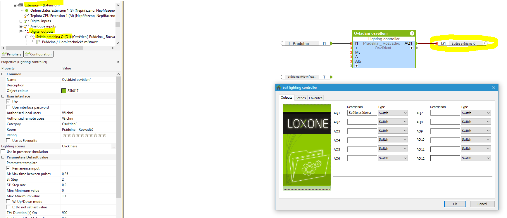

              To control the lights, you may need to evaluate the structure JSON obtained from .../data/LoxAPP3.json, but that's are where I'm lost a bit too. I only found it it's possible to manipulate the light by taking the ID/name of a subcontrol in a LightController. This is what I found in the LoxAPP3.json:
                      "0eb22d79-02c6-710c-fffffae984b19f22":{
                          "name":"Ovládání osvětlení",
                          "type":"LightController",
                          "uuidAction":"0eb22d79-02c6-710c-fffffae984b19f22",
                          "room":"0d745096-0051-03ed-fffffae984b19f22",
                          "cat":"0d745096-0013-030d-fffffae984b19f22",
                          "defaultRating":0,
                          "isFavorite":false,
                          "isSecured":false,
                          "details":{
                              "movementScene":1
                          "states":{
                              "activeScene":"0eb22d79-02c6-7109-ffffa6ea96de1476",
                              "sceneList":"0eb22d79-02c6-70cb-ffffa6ea96de1476"
                          "subControls":{
                              "0eb22d79-02c6-710c-fffffae984b19f22/AI1":{
                                  "name":"Světlo prádelna",
                                  "type":"Switch",
                                  "uuidAction":"0eb22d79-02c6-710c-fffffae984b19f22/AI1",
                                  "defaultRating":0,
                                  "isFavorite":false,
                                  "isSecured":false,
                                  "states":{
                                      "active":"0eb22d79-02c6-70fd-ffffa6ea96de1476"
                      "0d7afacb-024f-1d69-fffffae984b19f22":{
                          "name":"Světlo prádelna O",
                          "type":"InfoOnlyDigital",
                          "uuidAction":"0d7afacb-024f-1d69-fffffae984b19f22",
                          "defaultRating":10,
                          "isFavorite":true,
                          "isSecured":false,
                          "details":{
                              "text":{
                                  "off":"Off",
                                  "on":"On"
                              "color":{
                                  "off":"#BE1624",
                                  "on":"#73BA1B"
                          "states":{
                              "active":"0d7afacb-024f-1d69-fffffae984b19f22"
              and from there, I found out that it can be turned on/off:
              If the command is accepted, you get something like this (Code 200 is important):
               {"LL": { "control": "dev/sps/io/0eb22d79-02c6-710c-fffffae984b19f22/AI1/on", "value": "1", "Code": "200"}}
              To get the light, that's a different story. I haven't figured out any better way than to take the Miniserver/Extension Digital output itself (I am not able to determine programatically from the structure file the associated output). In my case, as per following screenshot:
              Loxone Config
              it is:
              which can be requested by
              returning value "value" carries the state:
               {"LL": { "control": "dev/sps/io/0d7afacb-024f-1d69-fffffae984b19f22/astate", "value": "0", "Code": "200"}}
              or
               {"LL": { "control": "dev/sps/io/0d7afacb-024f-1d69-fffffae984b19f22/astate", "value": "1", "Code": "200"}}
              Hope this helps. And if there's anyone willing to share some more light to this, I'd be also glad to read his/her experience.
