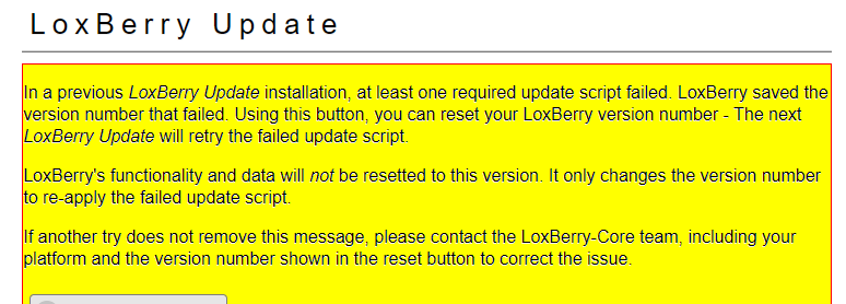

                  I have 3 LoxBerry systems at home and my oldeset was on on 1.4 until yesterday.
                  I decided to upgrade it finally and I took the challenge to upgrade it in-place.
                  The upgrade went almost fine with some minor errors resulting in message:
                  Click image for larger version  Name:	Clipboard01.png Views:	0 Size:	42.4 KB ID:	250500
                  So I clicked Reset to version 1.99.99 but it didn't help.
                  So I upgraded to 2.0.1.3 and then upgraded every plugin to newest version.

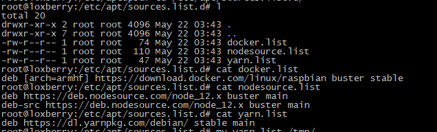

                    As root user in the Shell, Go to
                    /etc/apt/sources.list.d/
                    Do ls -l and look for a File that seems to be dependent to rpimonitor.
                    Delete that file, or move it (only that one) to another directory.
                    Run sudo apt-get update
                    Still any error?
                    If no, retry LoxBerry Update.
                    Regards, Christian

                      Thanks Christian for your answer,
                      Here is how it looks:
Ansichten: 1326
Größe: 21,2 KB
                      I believe docker is for docker but no idea what those other two are for (nodesource and yarn).

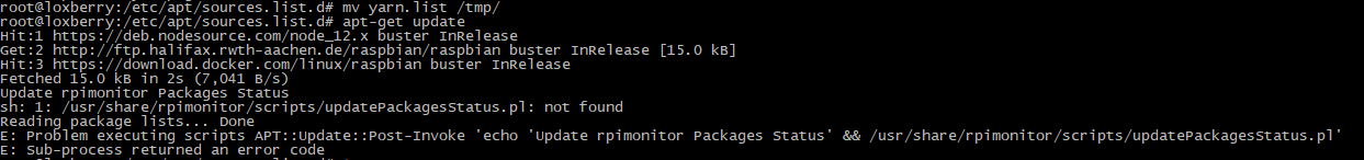

                      I've tried to move out yarn first but no any good:
Ansichten: 1257
Größe: 22,6 KB

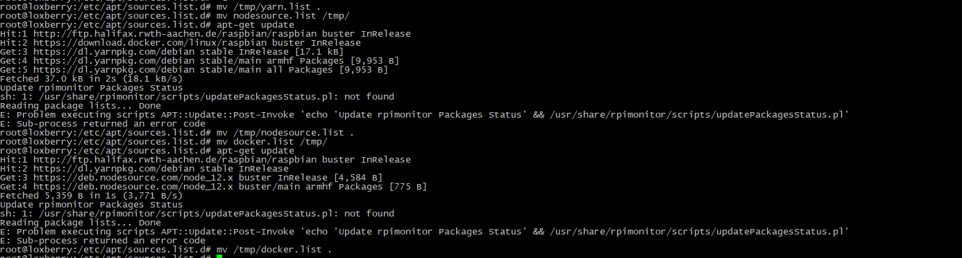

                      Then I've tried to move other sources as well:
Ansichten: 1260
Größe: 60,4 KB
                      Unfortunately this doesn't seem to help.

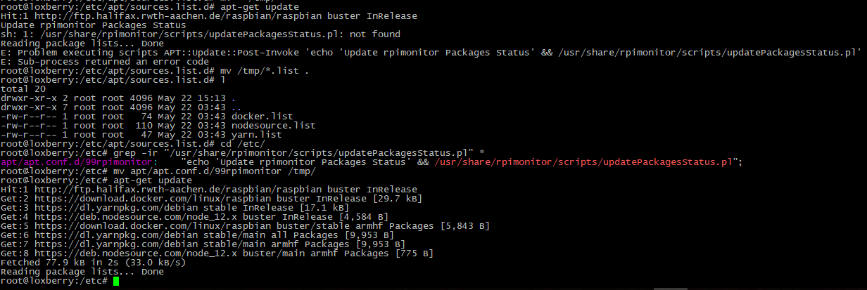

                        Ok, I've probably handled that issue, this way:
Ansichten: 1309
Größe: 68,6 KB
                        So, I now press "Reset to 2.0.0.0" in update module?
                        Or shall I handle this state in another way?
                          You can remove the FAILED_SCRIPT key in general.cfg, as the rpimonitor thing was the only issue.
