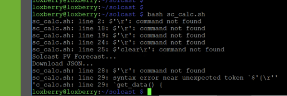

      Danke wenn ich dein Script ausführe am Loxberry bekomme ich immer eine Fehlermeldung in line 2 4 ,...
      weist du was das ist?
      Hallo nochmals. Sorry war zuerst nur am Handy und habe dann den Anhang vergessen. Im Anhang der Screen von dem Fehler was ich bekomme wenn ich das Script ausführe.
      Zuletzt geändert von StoRmtec; 29.11.2019, 21:18.
      • StoRmtec
        StoRmtec kommentierte
        Mit dem VI Editor
        Er meldet jede Leerzeile als /r. Day ist ein Format Fehler.
      • StoRmtec
        Danke hismastersvoice Es hat jetzt geklappt muss im VS Code einen Fehler gehabt haben.

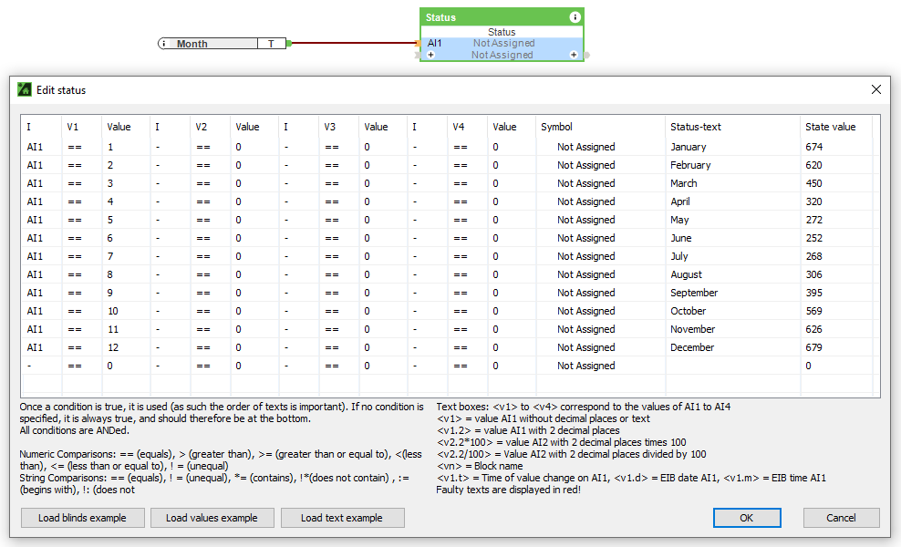

              I have been communicating with StoRmtec on a possible method to solve his mountain issue (and it's a very big mountain!). I've produced a 3D CAD file with the position of the mountain with reference to his house. An accurate sunrise is possible to determine throughout the year, including when it's delayed by the mountain shadow. This CAD model can be used to populate a Status Block of 'Mountain Sunrise' times.
              Approaching Autumn/Winter, the 'Mountain Sunrise' Status block includes the effects of the terrain. The attached Status Block shows a very coarse set of data for monthly values. Daily or weekly values should be used instead.
              As a mechanism to calculate the percentage of the Solcast forecast -
              1. Loxone has 'Time of sunrise' and 'Time of sunset'. The difference gives minutes of sunlight. Like Solcast, Loxone assumes a flat earth with no terrain effects.
              2. Loxone can use the Status Block 'Mountain Sunrise' for the terrain affected sunrise and 'Time of sunset'. The difference gives minutes of 'real sunlight'.
              Value 2 as a proportion of value 1 gives a percentage less than 100%.
              Apply the percentage to the Solcast forecast.
              Unfortunately, you will lose some attributes of the Solcast forecast. ie. Solcast uses weather changes throughout the day to fine-tune the forecast. Applying a percentage assumes a consistent production throughout the day. Ultimately, it's still just a forecast...

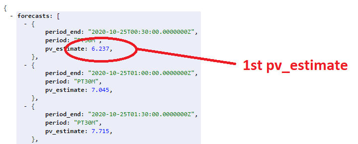

                      #150
                      Hallo hismastersvoice. Ich verwende Ihr Solcast-Skript schon seit einiger Zeit sehr erfolgreich. Nochmals vielen Dank.
                      Ich möchte eine kleine Änderung vornehmen, um die erste 'pv_estimate' zusammen mit den vorhandenen Daten auszugeben. Ich habe mit der Anpassung des bestehenden 'NEXT 3H' an 'NEXT 30MINS' experimentiert. Hier fehlen mir ausreichende Programmierkenntnisse.
Ansichten: 542
Größe: 17,8 KB
