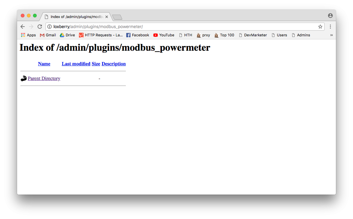

            I installed the plugin but I get a blank page when I want to go to the settings. What am I doing wrong?
              What do you expect in response?
              With so limited information, no one can help you.
              What else do you have installed. Is it a Raspberry or a virtual machine... and... and...

                    • 7631
                    #39
                    Looks like that the Files are not copyed to the directory.
                    Do you have tried to uninstall and reinstall?

                      #40
                      Yeah, tried that. Same result.

                      Try this version and please feedback...
                        #42
                        Gast BTW (not connected to this issue), you should run the 1.0.1 update because LoxBerry installs some libs that may be required.
                          The error is at 1.0 and at 1.0.1
                          The new version should fix it.

                        Don't know what you did but thank you for fixing it so fast!
                        Also updated to 1.0.1 afterwards.
