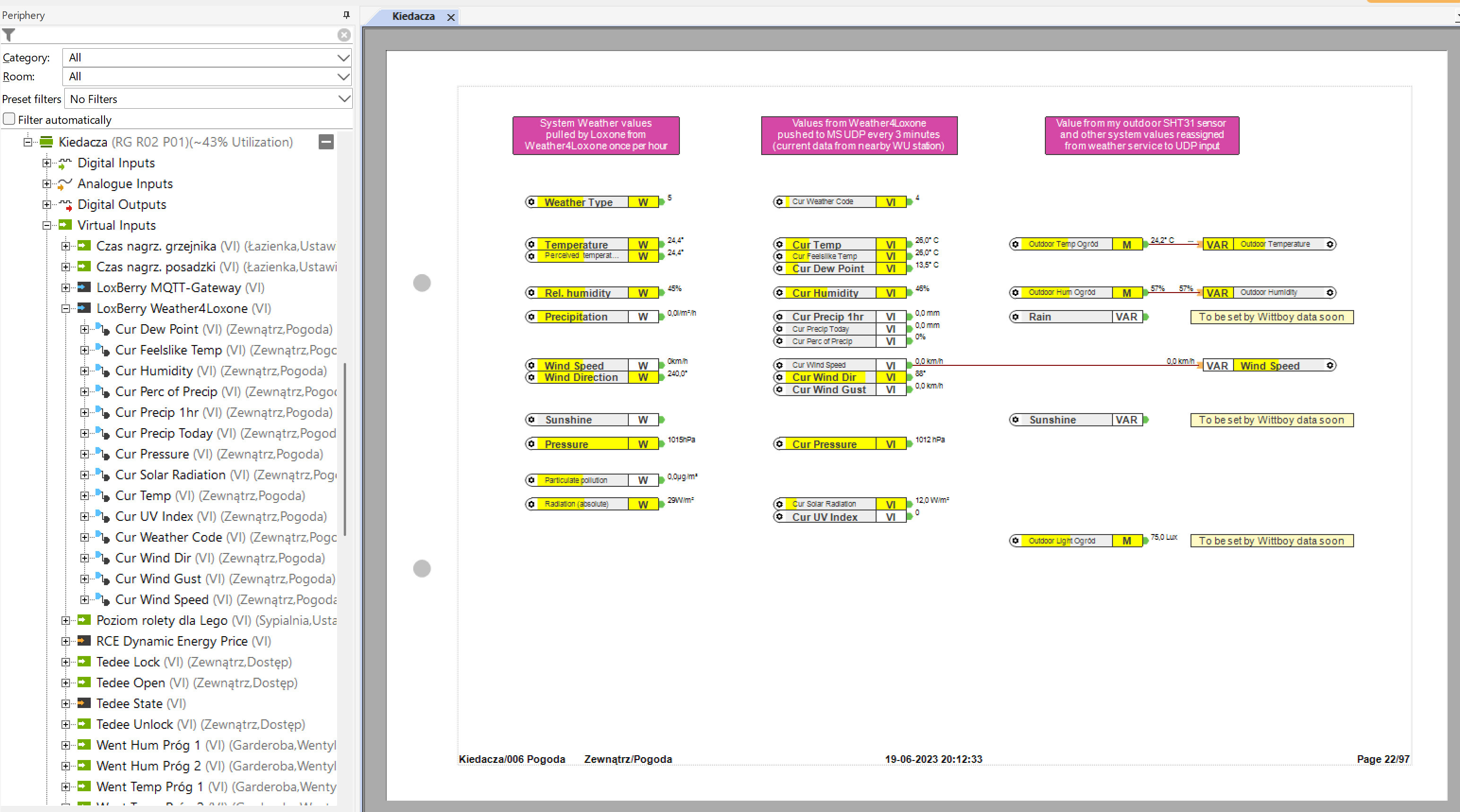

    Prof.Mobilux This is exactly what I have now.
Ansichten: 769
Größe: 122,4 KB

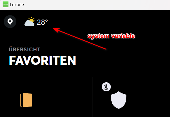

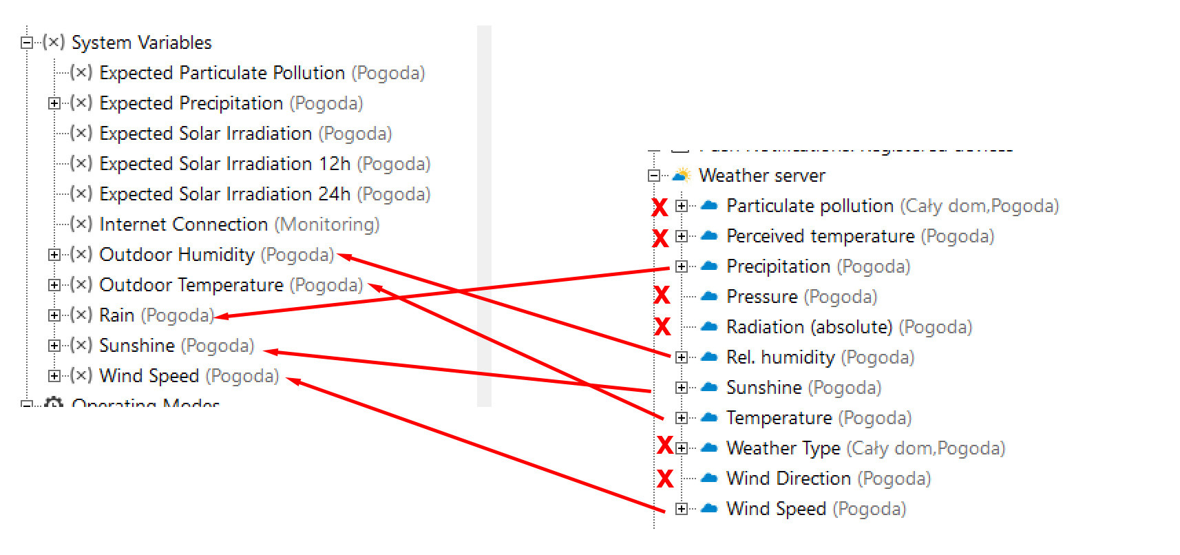

    But as I wrote before, the problem is that not all weather values are defined as system variables and I don't see a way to add custom system variables (like you can add in Weather inputs):
Ansichten: 742
Größe: 331,0 KB
    That's why I was looking to find a way to "fix" Weather service data pulled from the plugin.
    But now I hardly see a way.
    So I believe you'd suggest using values from plugin such as cur_w_dirdes, cur_tt_fl, cur_pr, etc?

      Exactly. Use UDP inputs instead for everything else then temperature. This data is always up to date. No f*cking 60 minutes old data. I only use the system variable for temperature, because this way the Loxone App uses this data for displaying current weather in the upper left corner. All other values can be used from the UDP inputs.

        Prof.Mobilux Thank you very much. I believe I finally understand how it works.
        I've added all interesting UDP inputs and it seems to work fine:
Ansichten: 805
Größe: 952,6 KB
Ansichten: 733
Größe: 146,2 KB

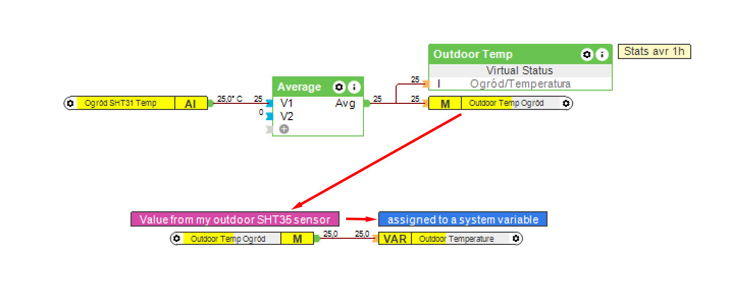

        Now I have finally exact current weather data in Loxone from a nearby WU station, and soon - from my own Wittboy weather station overwritten from FOSHK plugin.
        Then I will use them in my diagrams and also assign to all available system variables.
        Thank you very much again!

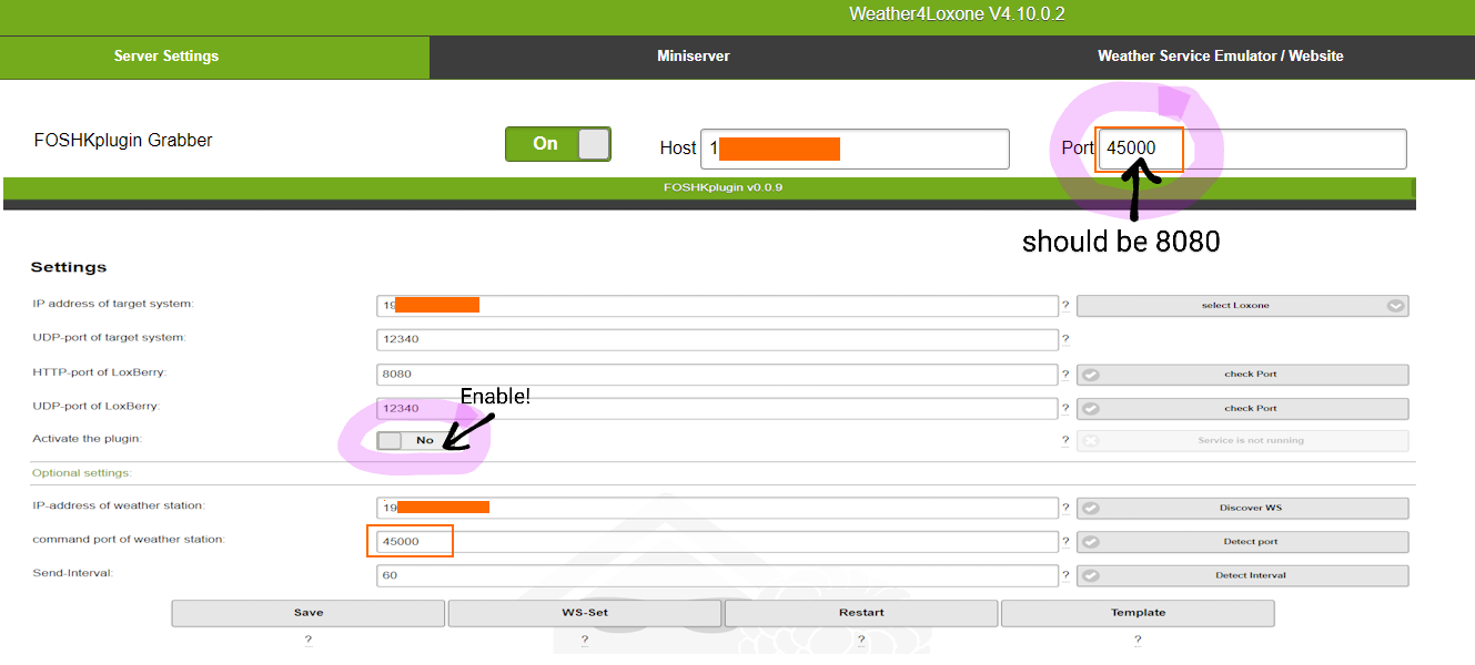

                Hi!
                You have to adjust the port for FOSHKplugin in W4L & activate FOSHKplugin. See attached image.
Ansichten: 612
Größe: 98,9 KB
                Oliver

                  I've changed it from 45000 to 8080 and i get right away this error
                  27.06.2023 10:30:34 TASK STARTED
                  Weather4Lox GRABBER_FOSHK process started
                  INFO: LoxBerry Version 3.0.0.6 ( is_arch_x86_64.cfg is_x64.cfg is_hwmodel_x86_64_vm.cfg )
                  INFO: Weather 4 Loxone Version 4.10.0.2
                  INFO: Loglevel: 7
                  This is /opt/loxberry/bin/plugins/weather4lox/grabber_foshk.pl Version 4.10.0.2
                  INFO: Fetching Data from FOSHK Plugin at 19x.xxx.xxx.xxx​:8080
                  URL: http://192.168.10.76:8080/observatio...t/json/units=m
                  Status: 500 Can't connect to 192.168.10.76:8080 (Connection refused)
                  CRITICAL: Failed to fetch data from 19x.xxx.xxx.xxx​:8080. Status Code: 500
                  27.06.2023 10:30:34 TASK FINISHED
                  • olicat
                    olicat kommentierte
                    Hi!
                    Make sure FOSHKplugin is running and 192.168.10.76 is the correct address of the host running FOSHKplugin.
                    To test the availability of FOSHKplugin point your web browser to http://192.168.10.76:8080.
                    Oliver
                  • killeriq
                    killeriq kommentierte
                    not loading...strange
                    I might try to restart it all WS and Router....i guess there shouldn't be any FW blocking on local network
                    I remember even on Loxberry2 i had issues to get it working...
