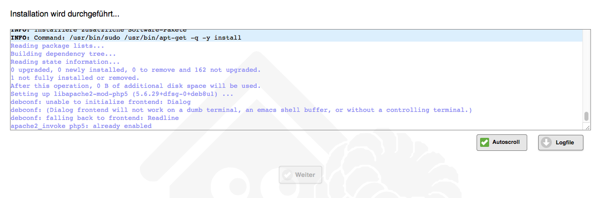

              So... jetzt läuft die Installation nicht mal durch. (Anbei auch ein Scrennshot)
              Hier das was ich aus dem Logfile bekomme
              <INFO> Starte Plugin-Installation <OK> Plugin-Archiv erfolgreich hochgeladen <INFO> Extrahiere Plugin-Archiv <INFO> Command: /usr/bin/unzip -d /tmp/uploads/1KVvthpz0J /tmp/uploads/1KVvthpz0J/1KVvthpz0J.zip Archive: /tmp/uploads/1KVvthpz0J/1KVvthpz0J.zip inflating: /tmp/uploads/1KVvthpz0J/postupgrade.sh inflating: /tmp/uploads/1KVvthpz0J/preinstall.sh inflating: /tmp/uploads/1KVvthpz0J/preupgrade.sh inflating: /tmp/uploads/1KVvthpz0J/README.md creating: /tmp/uploads/1KVvthpz0J/config/ inflating: /tmp/uploads/1KVvthpz0J/config/example.cfg creating: /tmp/uploads/1KVvthpz0J/cron/ inflating: /tmp/uploads/1KVvthpz0J/cron/cron.15min inflating: /tmp/uploads/1KVvthpz0J/cron/cron.hourly creating: /tmp/uploads/1KVvthpz0J/daemon/ inflating: /tmp/uploads/1KVvthpz0J/daemon/daemon creating: /tmp/uploads/1KVvthpz0J/data/ inflating: /tmp/uploads/1KVvthpz0J/data/info.txt extracting: /tmp/uploads/1KVvthpz0J/data/squeezelite inflating: /tmp/uploads/1KVvthpz0J/data/squeezelite-armv6hf inflating: /tmp/uploads/1KVvthpz0J/data/squeezelite-x86 creating: /tmp/uploads/1KVvthpz0J/icons/ inflating: /tmp/uploads/1KVvthpz0J/icons/icon_128.png inflating: /tmp/uploads/1KVvthpz0J/icons/icon_256.png inflating: /tmp/uploads/1KVvthpz0J/icons/icon_512.png extracting: /tmp/uploads/1KVvthpz0J/icons/icon_64.png creating: /tmp/uploads/1KVvthpz0J/log/ inflating: /tmp/uploads/1KVvthpz0J/log/ABOUT creating: /tmp/uploads/1KVvthpz0J/templates/ creating: /tmp/uploads/1KVvthpz0J/templates/de/ inflating: /tmp/uploads/1KVvthpz0J/templates/de/help.txt inflating: /tmp/uploads/1KVvthpz0J/templates/de/language.txt creating: /tmp/uploads/1KVvthpz0J/templates/en/ inflating: /tmp/uploads/1KVvthpz0J/templates/en/help.txt inflating: /tmp/uploads/1KVvthpz0J/templates/en/language.txt creating: /tmp/uploads/1KVvthpz0J/templates/multi/ inflating: /tmp/uploads/1KVvthpz0J/templates/multi/help.html inflating: /tmp/uploads/1KVvthpz0J/templates/multi/help_lms2udp.html inflating: /tmp/uploads/1KVvthpz0J/templates/multi/lms2udp.html inflating: /tmp/uploads/1KVvthpz0J/templates/multi/settings.html inflating: /tmp/uploads/1KVvthpz0J/templates/multi/templatebuilder.html inflating: /tmp/uploads/1KVvthpz0J/templates/multi/topmenu.html inflating: /tmp/uploads/1KVvthpz0J/templates/multi/virtualout.xml creating: /tmp/uploads/1KVvthpz0J/uninstall/ inflating: /tmp/uploads/1KVvthpz0J/uninstall/uninstall creating: /tmp/uploads/1KVvthpz0J/webfrontend/ creating: /tmp/uploads/1KVvthpz0J/webfrontend/cgi/ creating: /tmp/uploads/1KVvthpz0J/webfrontend/cgi/bin/ inflating: /tmp/uploads/1KVvthpz0J/webfrontend/cgi/bin/lms2udp.pl inflating: /tmp/uploads/1KVvthpz0J/webfrontend/cgi/bin/udpreceiver.pl inflating: /tmp/uploads/1KVvthpz0J/webfrontend/cgi/index.cgi inflating: /tmp/uploads/1KVvthpz0J/webfrontend/cgi/kill_squeezelite.sh creating: /tmp/uploads/1KVvthpz0J/webfrontend/cgi/lib/ inflating: /tmp/uploads/1KVvthpz0J/webfrontend/cgi/lib/Basics.pm inflating: /tmp/uploads/1KVvthpz0J/webfrontend/cgi/lms2udp.cgi inflating: /tmp/uploads/1KVvthpz0J/webfrontend/cgi/restart_lms2udp.sh inflating: /tmp/uploads/1KVvthpz0J/webfrontend/cgi/sq2lox.php inflating: /tmp/uploads/1KVvthpz0J/webfrontend/cgi/start_instances.cgi inflating: /tmp/uploads/1KVvthpz0J/webfrontend/cgi/templatebuilder.cgi creating: /tmp/uploads/1KVvthpz0J/webfrontend/html/ creating: /tmp/uploads/1KVvthpz0J/webfrontend/html/images/ inflating: /tmp/uploads/1KVvthpz0J/webfrontend/html/images/dice.png extracting: /tmp/uploads/1KVvthpz0J/webfrontend/html/images/dice_30_30.png extracting: /tmp/uploads/1KVvthpz0J/webfrontend/html/images/dice_50_50.png inflating: /tmp/uploads/1KVvthpz0J/webfrontend/html/images/icon_128.png inflating: /tmp/uploads/1KVvthpz0J/webfrontend/html/images/icon_256.png inflating: /tmp/uploads/1KVvthpz0J/webfrontend/html/images/icon_512.png extracting: /tmp/uploads/1KVvthpz0J/webfrontend/html/images/icon_64.png inflating: /tmp/uploads/1KVvthpz0J/webfrontend/html/images/VTI.png inflating: /tmp/uploads/1KVvthpz0J/webfrontend/html/style.css inflating: /tmp/uploads/1KVvthpz0J/apt inflating: /tmp/uploads/1KVvthpz0J/plugin.cfg inflating: /tmp/uploads/1KVvthpz0J/postinstall.sh <OK> Plugin-Archiv erfolgreich entpackt <INFO> Author: Christian Fenzl <INFO> Email: christiantf@gmx.at <INFO> Version: 0.4.0 <INFO> Name: squeezelite <INFO> Folder: squeezelite <INFO> Title: Squeezelite Player <INFO> Interface: 1.0 <OK> Alle Konfigurationsparameter vorhanden <OK> Freien Datenbank-Eintrag gefunden <INFO> Verwende Plugin-Name: squeezelite <INFO> Verwende Installationsverzeichnis: squeezelite <INFO> Starte Skript PREINSTALL <INFO> Command: /bin/sh "/tmp/uploads/1KVvthpz0J/preinstall.sh" "1KVvthpz0J" "squeezelite" "squeezelite" "0.4.0" "/opt/loxberry" <INFO> Squeezelite Plugin makes sure everything is encoded in Unix style (running dos2unix)... <INFO> dos2unix has finished <OK> Skript ohne Fehler ausgeführt <INFO> Installiere Konfigurationsdateien '/tmp/uploads/1KVvthpz0J/config/example.cfg' -> '/opt/loxberry/config/plugins/squeezelite/example.cfg' <OK> Alle Dateien erfolgreich installiert <INFO> Installiere Templatedateien '/tmp/uploads/1KVvthpz0J/templates/de' -> '/opt/loxberry/templates/plugins/squeezelite/de' '/tmp/uploads/1KVvthpz0J/templates/de/help.txt' -> '/opt/loxberry/templates/plugins/squeezelite/de/help.txt' '/tmp/uploads/1KVvthpz0J/templates/de/language.txt' -> '/opt/loxberry/templates/plugins/squeezelite/de/language.txt' '/tmp/uploads/1KVvthpz0J/templates/en' -> '/opt/loxberry/templates/plugins/squeezelite/en' '/tmp/uploads/1KVvthpz0J/templates/en/language.txt' -> '/opt/loxberry/templates/plugins/squeezelite/en/language.txt' '/tmp/uploads/1KVvthpz0J/templates/en/help.txt' -> '/opt/loxberry/templates/plugins/squeezelite/en/help.txt' '/tmp/uploads/1KVvthpz0J/templates/multi' -> '/opt/loxberry/templates/plugins/squeezelite/multi' '/tmp/uploads/1KVvthpz0J/templates/multi/settings.html' -> '/opt/loxberry/templates/plugins/squeezelite/multi/settings.html' '/tmp/uploads/1KVvthpz0J/templates/multi/templatebuilder.html' -> '/opt/loxberry/templates/plugins/squeezelite/multi/templatebuilder.html' '/tmp/uploads/1KVvthpz0J/templates/multi/help.html' -> '/opt/loxberry/templates/plugins/squeezelite/multi/help.html' '/tmp/uploads/1KVvthpz0J/templates/multi/topmenu.html' -> '/opt/loxberry/templates/plugins/squeezelite/multi/topmenu.html' '/tmp/uploads/1KVvthpz0J/templates/multi/lms2udp.html' -> '/opt/loxberry/templates/plugins/squeezelite/multi/lms2udp.html' '/tmp/uploads/1KVvthpz0J/templates/multi/virtualout.xml' -> '/opt/loxberry/templates/plugins/squeezelite/multi/virtualout.xml' '/tmp/uploads/1KVvthpz0J/templates/multi/help_lms2udp.html' -> '/opt/loxberry/templates/plugins/squeezelite/multi/help_lms2udp.html' <OK> Alle Dateien erfolgreich installiert <INFO> Installiere DAEMON '/tmp/uploads/1KVvthpz0J/daemon/daemon' -> '/opt/loxberry/system/daemons/plugins/squeezelite' <OK> Alle Dateien erfolgreich installiert <INFO> Setze Berechtigungen: /bin/chmod 755 /opt/loxberry/system/daemons/plugins/squeezelite <OK> Berechtigungen erfolgreich gesetzt <INFO> Installiere Cron-Job-Dateien '/tmp/uploads/1KVvthpz0J/cron/cron.15min' -> '/opt/loxberry/system/cron/cron.15min/squeezelite' '/tmp/uploads/1KVvthpz0J/cron/cron.hourly' -> '/opt/loxberry/system/cron/cron.hourly/squeezelite' <OK> Alle Cronjob-Dateien erfolgreich installiert <INFO> Setze Berechtigungen: /bin/chmod -R 755 /opt/loxberry/system/cron/ <OK> Berechtigungen erfolgreich gesetzt <INFO> Installiere Daten-Dateien '/tmp/uploads/1KVvthpz0J/data/info.txt' -> '/opt/loxberry/data/plugins/squeezelite/info.txt' '/tmp/uploads/1KVvthpz0J/data/squeezelite' -> '/opt/loxberry/data/plugins/squeezelite/squeezelite' '/tmp/uploads/1KVvthpz0J/data/squeezelite-armv6hf' -> '/opt/loxberry/data/plugins/squeezelite/squeezelite-armv6hf' '/tmp/uploads/1KVvthpz0J/data/squeezelite-x86' -> '/opt/loxberry/data/plugins/squeezelite/squeezelite-x86' <OK> Alle Dateien erfolgreich installiert <INFO> Installiere Log-Dateien '/tmp/uploads/1KVvthpz0J/log/ABOUT' -> '/opt/loxberry/log/plugins/squeezelite/ABOUT' <OK> Alle Dateien erfolgreich installiert <INFO> Installiere CGI-Dateien '/tmp/uploads/1KVvthpz0J/webfrontend/cgi/bin' -> '/opt/loxberry/webfrontend/cgi/plugins/squeezelite/bin' '/tmp/uploads/1KVvthpz0J/webfrontend/cgi/bin/udpreceiver.pl' -> '/opt/loxberry/webfrontend/cgi/plugins/squeezelite/bin/udpreceiver.pl' '/tmp/uploads/1KVvthpz0J/webfrontend/cgi/bin/lms2udp.pl' -> '/opt/loxberry/webfrontend/cgi/plugins/squeezelite/bin/lms2udp.pl' '/tmp/uploads/1KVvthpz0J/webfrontend/cgi/index.cgi' -> '/opt/loxberry/webfrontend/cgi/plugins/squeezelite/index.cgi' '/tmp/uploads/1KVvthpz0J/webfrontend/cgi/kill_squeezelite.sh' -> '/opt/loxberry/webfrontend/cgi/plugins/squeezelite/kill_squeezelite.sh' '/tmp/uploads/1KVvthpz0J/webfrontend/cgi/lib' -> '/opt/loxberry/webfrontend/cgi/plugins/squeezelite/lib' '/tmp/uploads/1KVvthpz0J/webfrontend/cgi/lib/Basics.pm' -> '/opt/loxberry/webfrontend/cgi/plugins/squeezelite/lib/Basics.pm' '/tmp/uploads/1KVvthpz0J/webfrontend/cgi/lms2udp.cgi' -> '/opt/loxberry/webfrontend/cgi/plugins/squeezelite/lms2udp.cgi' '/tmp/uploads/1KVvthpz0J/webfrontend/cgi/restart_lms2udp.sh' -> '/opt/loxberry/webfrontend/cgi/plugins/squeezelite/restart_lms2udp.sh' '/tmp/uploads/1KVvthpz0J/webfrontend/cgi/sq2lox.php' -> '/opt/loxberry/webfrontend/cgi/plugins/squeezelite/sq2lox.php' '/tmp/uploads/1KVvthpz0J/webfrontend/cgi/start_instances.cgi' -> '/opt/loxberry/webfrontend/cgi/plugins/squeezelite/start_instances.cgi' '/tmp/uploads/1KVvthpz0J/webfrontend/cgi/templatebuilder.cgi' -> '/opt/loxberry/webfrontend/cgi/plugins/squeezelite/templatebuilder.cgi' <OK> Alle Dateien erfolgreich installiert <INFO> Setze Berechtigungen: /bin/chmod -R 755 /opt/loxberry/webfrontend/cgi/plugins/squeezelite/ <OK> Berechtigungen erfolgreich gesetzt <INFO> Installiere HTML-Dateien '/tmp/uploads/1KVvthpz0J/webfrontend/html/images' -> '/opt/loxberry/webfrontend/html/plugins/squeezelite/images' '/tmp/uploads/1KVvthpz0J/webfrontend/html/images/dice.png' -> '/opt/loxberry/webfrontend/html/plugins/squeezelite/images/dice.png' '/tmp/uploads/1KVvthpz0J/webfrontend/html/images/dice_30_30.png' -> '/opt/loxberry/webfrontend/html/plugins/squeezelite/images/dice_30_30.png' '/tmp/uploads/1KVvthpz0J/webfrontend/html/images/dice_50_50.png' -> '/opt/loxberry/webfrontend/html/plugins/squeezelite/images/dice_50_50.png' '/tmp/uploads/1KVvthpz0J/webfrontend/html/images/icon_128.png' -> '/opt/loxberry/webfrontend/html/plugins/squeezelite/images/icon_128.png' '/tmp/uploads/1KVvthpz0J/webfrontend/html/images/icon_256.png' -> '/opt/loxberry/webfrontend/html/plugins/squeezelite/images/icon_256.png' '/tmp/uploads/1KVvthpz0J/webfrontend/html/images/icon_512.png' -> '/opt/loxberry/webfrontend/html/plugins/squeezelite/images/icon_512.png' '/tmp/uploads/1KVvthpz0J/webfrontend/html/images/icon_64.png' -> '/opt/loxberry/webfrontend/html/plugins/squeezelite/images/icon_64.png' '/tmp/uploads/1KVvthpz0J/webfrontend/html/images/VTI.png' -> '/opt/loxberry/webfrontend/html/plugins/squeezelite/images/VTI.png' '/tmp/uploads/1KVvthpz0J/webfrontend/html/style.css' -> '/opt/loxberry/webfrontend/html/plugins/squeezelite/style.css' <OK> Alle Dateien erfolgreich installiert <INFO> Installiere Icons '/tmp/uploads/1KVvthpz0J/icons/icon_128.png' -> '/opt/loxberry/webfrontend/html/system/images/icons/squeezelite/icon_128.png' '/tmp/uploads/1KVvthpz0J/icons/icon_256.png' -> '/opt/loxberry/webfrontend/html/system/images/icons/squeezelite/icon_256.png' '/tmp/uploads/1KVvthpz0J/icons/icon_512.png' -> '/opt/loxberry/webfrontend/html/system/images/icons/squeezelite/icon_512.png' '/tmp/uploads/1KVvthpz0J/icons/icon_64.png' -> '/opt/loxberry/webfrontend/html/system/images/icons/squeezelite/icon_64.png' <OK> Icons konnten erfolgreich installiert werden <INFO> Aktualisiere APT-Paketdatenbank <INFO> Command: /usr/bin/sudo /usr/bin/apt-get -q -y update Hit http://mirrordirector.raspbian.org jessie InRelease Hit http://archive.raspberrypi.org jessie InRelease Hit http://mirrordirector.raspbian.org jessie/main armhf Packages Hit http://mirrordirector.raspbian.org jessie/contrib armhf Packages Hit http://mirrordirector.raspbian.org jessie/non-free armhf Packages Hit https://deb.nodesource.com jessie InRelease Hit http://archive.raspberrypi.org jessie/main armhf Packages Hit http://mirrordirector.raspbian.org jessie/rpi armhf Packages Hit https://deb.nodesource.com jessie/main Sources Hit http://archive.raspberrypi.org jessie/ui armhf Packages Hit https://deb.nodesource.com jessie/main armhf Packages Get:1 https://deb.nodesource.com jessie/main Translation-en [162 B] Get:2 https://deb.nodesource.com jessie/main Translation-en [162 B] Get:3 https://deb.nodesource.com jessie/main Translation-en [162 B] Get:4 https://deb.nodesource.com jessie/main Translation-en [162 B] Ign http://mirrordirector.raspbian.org jessie/contrib Translation-en Ign http://mirrordirector.raspbian.org jessie/main Translation-en Ign http://mirrordirector.raspbian.org jessie/non-free Translation-en Ign http://mirrordirector.raspbian.org jessie/rpi Translation-en Ign http://archive.raspberrypi.org jessie/main Translation-en Ign http://archive.raspberrypi.org jessie/ui Translation-en Get:5 https://deb.nodesource.com jessie/main Translation-en [162 B] Ign https://deb.nodesource.com jessie/main Translation-en Reading package lists... <OK> APT-Paketdatenbank wurde erfolgreich aktualisiert <INFO> Installiere zusätzliche Software-Pakete <INFO> Command: /usr/bin/sudo /usr/bin/apt-get -q -y install Reading package lists... Building dependency tree... Reading state information... 0 upgraded, 0 newly installed, 0 to remove and 162 not upgraded. 1 not fully installed or removed. After this operation, 0 B of additional disk space will be used. Setting up libapache2-mod-php5 (5.6.29+dfsg-0+deb8u1) ... debconf: unable to initialize frontend: Dialog debconf: (Dialog frontend will not work on a dumb terminal, an emacs shell buffer, or without a controlling terminal.) debconf: falling back to frontend: Readline apache2_invoke php5: already enabled

                Das Log ist nicht vollständig.
                Du bist auf einem Raspberry, nicht in einer LoxBerry-VM, richtig?
                sonst mal:
                - Mit Putty anmelden
                - su root
                - apt-get update
                - apt-get upgrade
                Wenn bei apt-get update oder upgrade ein Fehler kommt, dann dem Hinweis folgen.
                Ich kann leider im Plugin-Setup nichts machen, dass die apt-get install Routine von LoxBerry manchmal nicht sauber durchläuft.
                  #159
                  Ich hab gerade einen Fehler gefunden, der nur im VM-Image auftreten dürfte:
                  Es wird vom Plugin wiringpi mitinstalliert, was es auf x86/x64 Plattformen nicht gibt. Wenn das fehlt, werden auch die anderen Pakete nicht installiert, und dann funktioniert die Startseite des Plugins nicht.
                  Bist du auf Raspberry oder VM?

                      Wahrscheinlich tritt bei dir auf, was es vorher auch schon gegeben hat:
                       E: dpkg was interrupted, you must manually run 'sudo dpkg --configure -a' to correct the problem.  <ERROR> APT-Paketdatenbank konnte nicht aktualisiert werden
                      Bitte als root anmelden, und ausführen:
                      dpkg --configure -a
