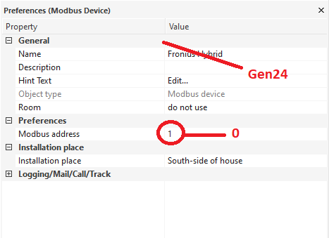

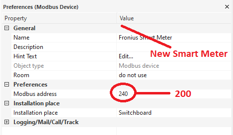

        I understand the Modbus address for both Gen24 and Smart Meter will be different. Try both 0 and 200 respectively -
Name: Gen24 Modbus address.png
Ansichten: 1007
Größe: 13,4 KB
Name: New Smart Meter.png
Ansichten: 814
Größe: 14,4 KB

          0 geht leider nicht und 200 oder 240 geht auch nicht.
          Ich habe jetzt den Gen24 auf 1 gesetzt und dort werden mir Daten angezeigt aber nicht vom Smart Meter, egal ob ich 200 oder 240 eintrage. Auf der Gen24 Seite kann man ja auch unter Modbus TCP eine "Zähleradresse" eingeben, zwischen 1 und 247 - was ist denn damit gemeint?
          EDIT:
          Habe es jetzt ans Laufen bekommen mit "Zähleradresse" auf 200. Muss dann aber wohl noch div. IO-Adressen ändern.

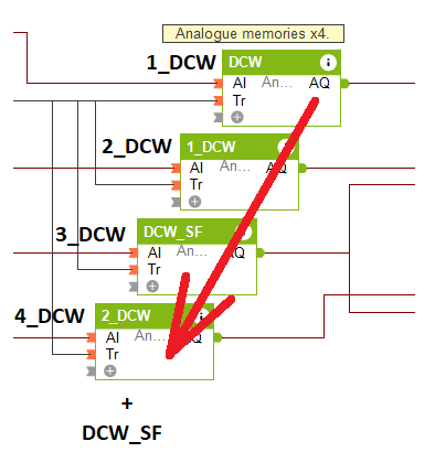

                  I should qualify - the calculation to 'sign' the DCW value is not required, but the application of the Scale Factor is still very much required (DCW_SF).
                  You still have the problem of 4 different DCW values that arrive at the Miniserver with slight timing differences. These values are very inter-related. The wiki entry has a method to optimise the values injecting into the Miniserver simultaneously (paragraph 1.e.). This technique will need applying to 1_DCW, 2_DCW, 3_DCW, 4_DCW and DCW_SF.
Name: DCW problem.png
Ansichten: 879
Größe: 19,0 KB
                  When the trigger fires on the 5 x Analogue memories, you will have a consistent 'snapshot' of the energy state of the whole system.

                  I've attached a file for the Gen24. I can't test this, so you need to check.
                  I have put Constants (C) as placeholders that you need to replace with the Modbus sensors. It is important that you create 6 new Modbus sensors in the following order (append the old ones with _old before starting to differentiate) -
                  DCW
                  1_DCW
                  2_DCW
                  3_DCW
                  4_DCW
                  DCW_SF
                  The order of creation is the same order they are polled in the Config. Watch in Liveview and ensure the values refresh in sequence down the page. The trigger at 5 seconds should occur after the last value of DCW_SF has refreshed (it won't change very often though).

                  The main problem with Modbus is the Scale Factor. It can change values by 10x, 100x or 1000x. The timing when receiving sensor data versus receiving the associated Scale Factor is a fundamental limitation of Modbus. Did you re-create the sensors from scratch in the order suggested at post #56?
                  You need to watch the flow of data from the .Loxone file posted at #56.
                  Timing should be approx -
                  0.0 sec - DCW value change
                  0.5 sec - 1_DCW value change
                  1.0 sec - 2_DCW value change
                  1.5 sec - 3_DCW value change
                  2.0 sec - 4_DCW value change
                  2.5 sec - DCW_SF value change (but will change rarely)
                  5.0 sec - Analogue memories trigger 5 seconds after DCW value change
                  10 sec - DCW value change
                  10.5 sec - 1_DCW value change etc.
                  Can you confirm 3_DCW is always 0 when 4_DCW has a value? Likewise, can you confirm 4_DCW is always 0 when 3_DCW has a value?

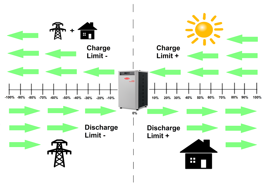

                  Triple-M refers to the registers InWRte, OutWRte and StorCtl_Mod. They are expressed as a percentage and refer to a proportion of the maximum charge rate or discharge rate of the battery/inverter (not to be confused with SoC, which is also referenced as a percentage).
                  Refer to Section 2 of the linked wiki article -
Ansichten: 1064
Größe: 104,2 KB
                  There is an important distinction between setting a negative Charge Limit or setting a positive Discharge Limit (both of which draw power from the battery).
                  Charge Limit - (negative), the battery will discharge over and above the set percentage if household needs are present.
                  Discharge Limit + (positive), the battery should follow the expected behaviour. ie. +5% should see around 400W (unless household loads are less than 400W. In this case, the battery discharge will match the household load). Note that StorCtl_Mod should be set to value = 2 (activating Discharge Limit).
                  If this is not occuring, it might be a change in the operating regime for the Gen24/BYD battery. The wiki is written from experience with the Symo Hybrid/Fronius Solar Battery.
