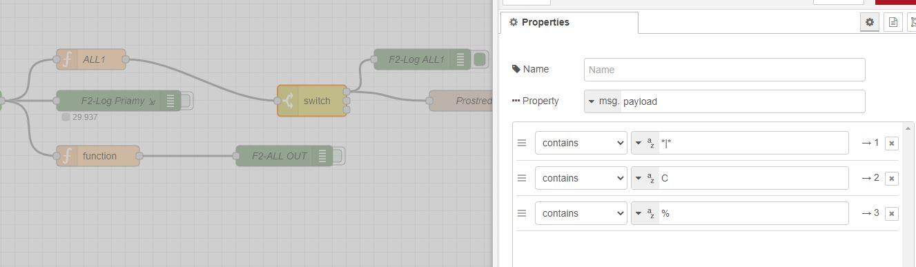

    EDIT:
    Found "Switch" node , but not sure how to make ignore complete "Value" if it contains those characters
    Tried this way, but is still sending those msg , but getting close
Ansichten: 643
Größe: 105,8 KB
    Zuletzt geändert von killeriq; 28.09.2020, 09:53.
    • killeriq
      • 91
      #79
      Programie Danke fur tip, ich habe es so gemacht
      This way it sents all with "|" character in msg into output 1 and all the rest goes to 2, seems like now is all withot any error, so i can setup the rest . thank for help
Ansichten: 653
Größe: 68,6 KB

        • Programie
          Programie kommentierte
          The InfluxDB node requires the second variant (ALL2): You have to give an array with two elements. The first one is a map of values, the second one is a map of tags. Therefore your first variant (ALL1) won't work.
          AFAIK, there is no way to expand/collapse the whole tree in the debug pane. At least I couldn't find any button or keyboard shortcut related to that.
          Edit: Just checked the InfluxDB node documentation and saw that the first variant is also supported. Do you see any errors in the logs of the InfluxDB server?
