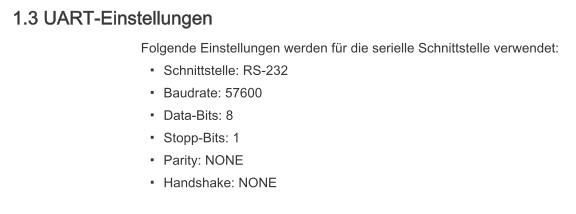

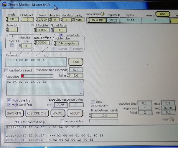

                      Hello together,
                      I just checked out the modbus- plugin for Loxberry.
                      I tried to connect a "Froeling wood heating system" called "Dual Compact".
                      Anyway, connecting with the windows tool, "Simply Modbus Master" I can read out for example the temperature of the heating circuit -> refer to the attachment
                      By using the Modbus Gateway plugin for the Loxberry, I am not able to read a value.
                      Do anybody know what's the issue here?
                      The second point, I do not understand, why the window tool subtract an offset? In my example "30001"?
                      Thanks in advance

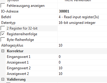

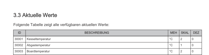

                      Update:
                      The issue was this offset. The IO- Address in Loxone is the given address from Fröling list subtract the 1 ID.
                      Here an example:
                      Fröling Loxone
                      ID Beschreibung IO- Address Command Order of registers
                      30001 Kesseltemperatur (30001-30001=) 0 4 - reading input register yes
                      30002 Abgastemperatur (30001-30001=) 1 4 - reading input register yes
                      31001 Außentemperatur (31001-30001=) 1000 4 - reading input register yes
                      Now it is possible to include a Fröling heating system into Loxone by using the Modbus Plugin.

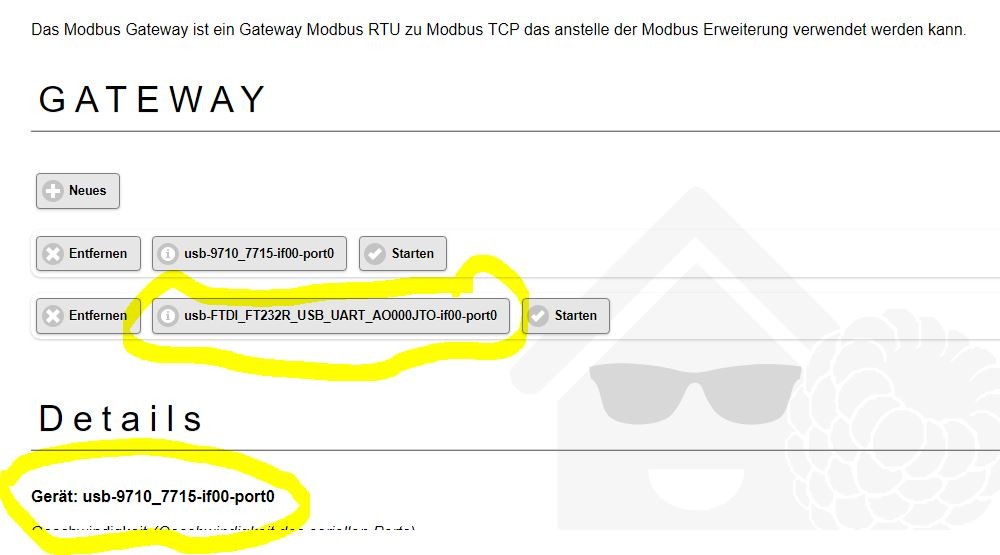

                      • Oki8085
                        • 27.07.2018
                        • 14
                        #29
                        Hello,
                        now I get a new Issue.
                        How can I use 2 Modbus Gateways simultaneously?
                        I add the second one (I have one RS232 and one RS485 adapter on the USBs connected).
                        I could not change the marked adapters setting?
                        Klick on it does not work. -> The detailed view still remains.
                        Thank you for answers

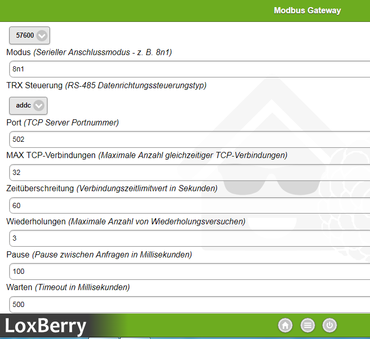

                        • ROLE
                          • 21.10.2018
                          • 57
                          #30
                          Hi all,
                          I try now to include a Finder Powermeter 7E which i successfully integrated via Modbus Gateway to connect via Loxberry Modbus Gateway. The reason is, that I have a distance to my PV plant what easiely could be over Raspberry and WIFI.
                          Now whats the problem:
                          • I use a USB-RS485 adapter which is found just in time by Raspberry - Loxberry - Modbus Gatew
                          • Configuration of Modbus Gateway in Loxberry is done like shown in the attached picture.
                          • The powermeter is configured in the same way. Same Baud rate, address 8
                          • Gateway is configurated in Loxone Config like shown
                          • Power Meter is configrated also
                          • and the LOG File shows this:
                          23 Mar 2019 08:46:37 conn[192.168.0.145]: state now is CONN_TTY
                          23 Mar 2019 08:46:37 conn_loop(): select(): max_sd = 4, t_out = 000000:099650
                          23 Mar 2019 08:46:37 conn_loop(): select() returns 0
                          23 Mar 2019 08:46:37 tty: state now is TTY_RQST
                          23 Mar 2019 08:46:37 conn_loop(): select(): max_sd = 4, t_out = 000060:000000
                          23 Mar 2019 08:46:37 conn_loop(): select() returns 1
                          23 Mar 2019 08:46:38 tty: written 8 bytes
                          23 Mar 2019 08:46:38 tty: request written (total 8 bytes)
                          23 Mar 2019 08:46:38 tty: state now is TTY_RESP
                          23 Mar 2019 08:46:38 tty: estimated 7 bytes, waiting 515624 usec
                          23 Mar 2019 08:46:38 conn_loop(): select(): max_sd = 4, t_out = 000000:515624
                          23 Mar 2019 08:46:38 conn_loop(): select() returns 0
                          23 Mar 2019 08:46:38 tty: response timeout
                          23 Mar 2019 08:46:38 tty: attempt to retry request (1 of 3)
                          23 Mar 2019 08:46:38 tty: state now is TTY_RQST
                          23 Mar 2019 08:46:39 conn_loop(): select() returns 0
                          23 Mar 2019 08:46:39 tty: response timeout
                          23 Mar 2019 08:46:39 tty: attempt to retry request (2 of 3)
                          23 Mar 2019 08:46:39 tty: state now is TTY_RQST
                          23 Mar 2019 08:46:39 tty: written 8 bytes

                          23 Mar 2019 08:46:49 conn_loop(): select() returns 1
                          23 Mar 2019 08:46:49 conn[192.168.0.145]: state now is CONN_RQST_FUNC
                          23 Mar 2019 08:46:49 conn[192.168.0.145]: read request fc 3
                          23 Mar 2019 08:46:49 conn[192.168.0.145]: state now is CONN_RQST_TAIL
                          23 Mar 2019 08:46:49 conn[192.168.0.145]: request: [08][03][10][10][00][01][eb][2b][00][00][00][06][08][03][10][12][00][01][eb][2c][00][00][00][06][08][03][10][14][00][01][eb][2d][00][00][00][06][08][03][10][16][00][01][eb][2e][00][00][00][06][08][03][10][18][00][01][eb][2f][00][00][00][06][08][03][10][1a][00][01][eb][30][00][00][00][06][08][03][10][1c][00][01][eb][31][00][00][00][06][08][03][10][1e][00][01][eb][32][00][00][00][06][08][03][10][20][00][01][eb][33][00][00][00][06][08][03][10][22][00][01][eb][34][00][00][00][06][08][03][10][24][00][01][eb][35][00][00][00][06][08][03][10][26][00][01][eb][36][00][00][00][06][08][03][10][28][00][01]
                          23 Mar 2019 08:46:49 conn[192.168.0.145]: state now is CONN_TTY
                          23 Mar 2019 08:46:49 conn_loop(): select(): max_sd = 4, t_out = 000000:099808
                          23 Mar 2019 08:46:49 conn_loop(): select() returns 0
                          23 Mar 2019 08:46:49 tty: state now is TTY_RQST
                          23 Mar 2019 08:46:49 conn_loop(): select(): max_sd = 4, t_out = 000060:000000
                          23 Mar 2019 08:46:49 tty: written 8 bytes
                          23 Mar 2019 08:46:49 tty: request written (total 8 bytes)
                          23 Mar 2019 08:46:49 tty: state now is TTY_RESP
                          23 Mar 2019 08:46:49 tty: estimated 7 bytes, waiting 515624 usec
                          23 Mar 2019 08:46:49 conn_loop(): select(): max_sd = 4, t_out = 000000:515624
                          23 Mar 2019 08:46:49 tty: response timeout
                          23 Mar 2019 08:46:49 tty: attempt to retry request (1 of 3)
                          23 Mar 2019 08:46:50 conn_loop(): select() returns 0
                          23 Mar 2019 08:46:50 tty: response timeout
                          23 Mar 2019 08:46:50 tty: attempt to retry request (2 of 3)
                          23 Mar 2019 08:46:50 tty: state now is TTY_RQST
                          23 Mar 2019 08:46:50 tty: written 8 bytes
                          23 Mar 2019 08:46:50 tty: request written (total 8 bytes)
                          23 Mar 2019 08:46:50 tty: state now is TTY_RESP
                          23 Mar 2019 08:46:50 tty: estimated 7 bytes, waiting 515624 usec
                          23 Mar 2019 08:46:50 conn_loop(): select(): max_sd = 4, t_out = 000000:515624
                          23 Mar 2019 08:46:50 tty: attempt to retry request (3 of 3)
                          23 Mar 2019 08:46:51 conn_loop(): select() returns 0
                          23 Mar 2019 08:46:51 tty: response timeout
                          23 Mar 2019 08:46:51 conn[192.168.0.145]: state now is CONN_RESP
                          23 Mar 2019 08:46:51 tty: state now is TTY_PAUSE
                          23 Mar 2019 08:46:51 conn_loop(): select(): max_sd = 5, t_out = 000000:100000
                          23 Mar 2019 08:46:51 conn_loop(): select() returns 1
                          23 Mar 2019 08:46:51 conn[192.168.0.145]: state now is CONN_HEADER
                          23 Mar 2019 08:46:51 conn_loop(): select(): max_sd = 5, t_out = 000000:099898
                          23 Mar 2019 08:46:51 conn[192.168.0.145]: state now is CONN_RQST_FUNC
                          23 Mar 2019 08:46:51 conn[192.168.0.145]: read request fc 3
                          23 Mar 2019 08:46:51 conn[192.168.0.145]: state now is CONN_RQST_TAIL
                          23 Mar 2019 08:46:51 conn[192.168.0.145]: request: [08][03][10][2a][00][01][eb][38][00][00][00][06][08][03][10][2c][00][01][eb][39][00][00][00][06][08][03][10][2e][00][01][eb][3a][00][00][00][06][08][03][10][30][00][01][eb][3b][00][00][00][06][08][03][10][32][00][01][eb][3c][00][00][00][06][08][03][10][34][00][01][eb][3d][00][00][00][06][08][03][10][36][00][01][eb][3e][00][00][00][06][09][04][00][34][00][02][eb][3f][00][00][00][06][08][03][10][00][00][01][eb][40][00][00][00][06][08][03][10][02][00][01]
                          23 Mar 2019 08:46:51 conn[192.168.0.145]: state now is CONN_TTY
                          23 Mar 2019 08:46:51 conn_loop(): select(): max_sd = 4, t_out = 000000:099798
                          23 Mar 2019 08:46:51 tty: state now is TTY_RQST
                          23 Mar 2019 08:46:51 conn_loop(): select(): max_sd = 4, t_out = 000060:000000
                          23 Mar 2019 08:46:51 tty: written 8 bytes
                          23 Mar 2019 08:46:51 tty: request written (total 8 bytes)
                          23 Mar 2019 08:46:51 tty: state now is TTY_RESP
                          23 Mar 2019 08:46:51 tty: estimated 7 bytes, waiting 515624 usec
                          23 Mar 2019 08:46:51 conn_loop(): select(): max_sd = 4, t_out = 000000:515624
                          23 Mar 2019 08:46:51 tty: attempt to retry request (1 of 3)

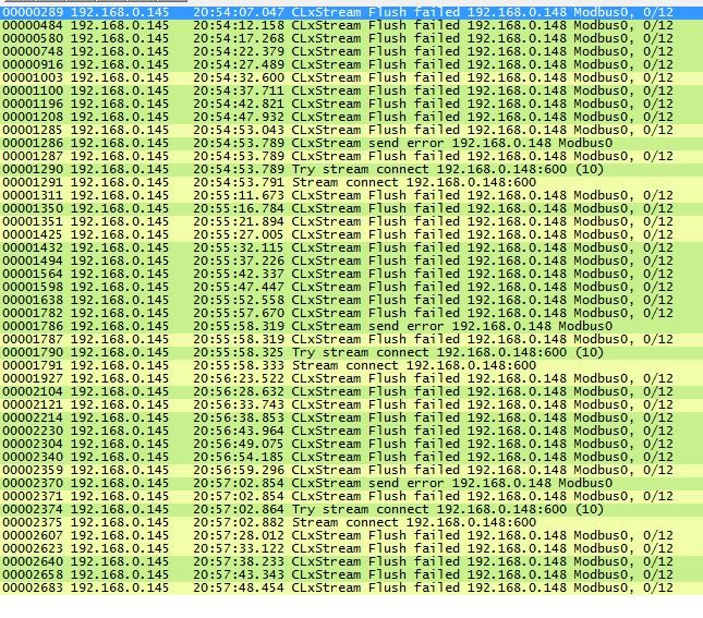

                          • The Monitor in Loxone Config shows the following:
                          Klicke auf die Grafik für eine vergrößerte Ansicht  Name: Unbenannt.JPG Ansichten: 0 Größe: 261,1 KB ID: 195175
                          But I cannot see values of whatever in my Loxone. Are there any hints?
                          Thanks in advance!!
                          Roman
                          Zuletzt geändert von ROLE; 23.03.2019, 21:02.
                          • ogrimo30
                            ogrimo30 kommentierte
                            hast du das Problem lösen können?
                            Ich kämpfe ich glaube im Moment mit einem ähnlichen Problem.
                            Lg
                          • ROLE
                            ROLE kommentierte
                            Hallo ogrimo30,
                            ich habe eine zweite unabhängige Loxberry Installation gemacht und dort das Modbus Plugin installiert. Hat auch nicht funktioniert. Die Lösung war dann wie in diesem Beitrag beschrieben über den Umweg Node Red https://www.loxforum.com/forum/proje...672#post208672
                            Einziges Thema war dann, dass die Werte nur weitergegeben werden wenn sie sich auch ändern.
                            Vom Entwickler hab ich trotz englischsprachiger Anfragen keine Rückmeldung bekommen.
                            Zuletzt geändert von ROLE; 09.10.2019, 07:49.
