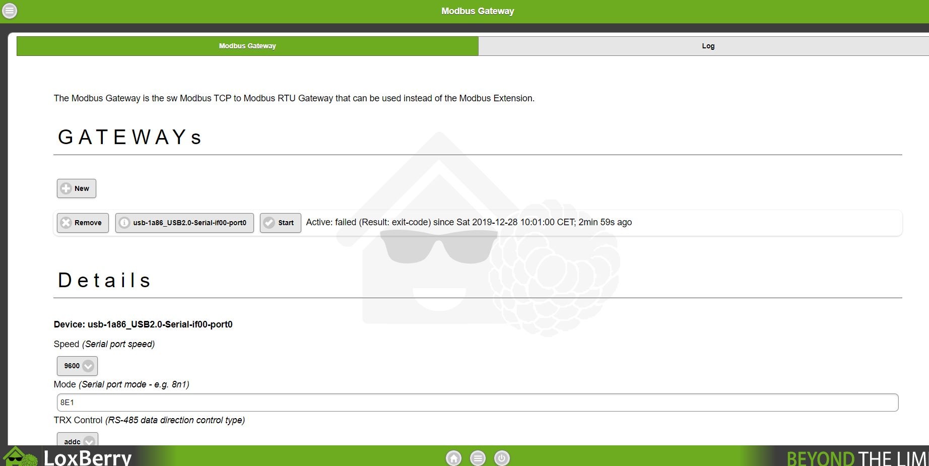

                  #57
                  Thanks for the quick reply.
                  Unfortunately I installed a fresh version of loxberry and modbus plugin and after the first reboot ..."Active: failed (Result: exit-code) since Tue 12/24/2019 19:25:23 CET; 19s ago"
                  If I press "start" manually everything is ok.
                  M.S.
                  • Gagi
                    Gagi kommentierte
                    Could you check the log file of the modbus plugin after the reboot ? It hopefully provides some more information why it failed to start.

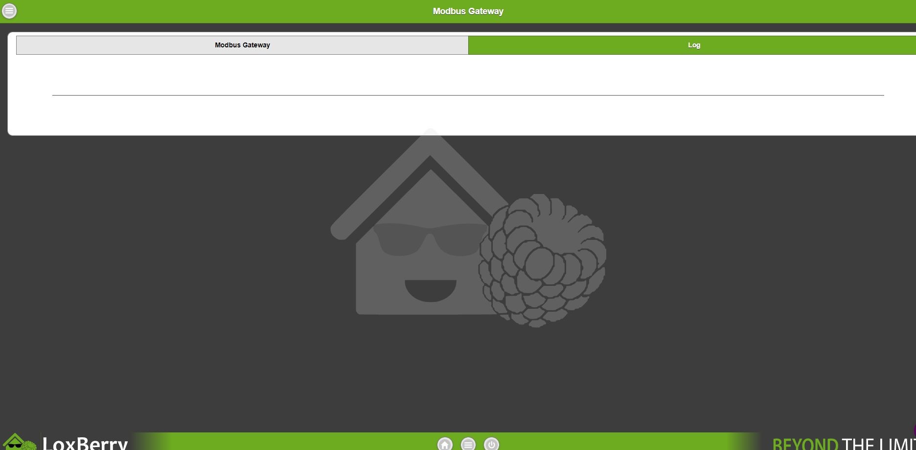

                  #58
                  There is no log file after reboot.
                  It creates after manual start only.

                    #59
                    Hi, could you check the systemd log for any errors?

                      17 Jan 2020 22:34:41 tty: state now is TTY_READY
                      17 Jan 2020 22:34:46 conn[192.168.1.77]: state now is CONN_RQST_FUNC
                      17 Jan 2020 22:34:46 conn[192.168.1.77]: state now is CONN_RQST_TAIL
                      17 Jan 2020 22:34:46 conn[192.168.1.77]: request: [01][03][00][32][00][01]
                      17 Jan 2020 22:34:46 conn[192.168.1.77]: state now is CONN_TTY
                      17 Jan 2020 22:34:46 tty: state now is TTY_RQST
                      17 Jan 2020 22:34:47 tty: state now is TTY_RESP
                      17 Jan 2020 22:34:47 tty: estimated 7 bytes, waiting 515624 usec
                      17 Jan 2020 22:34:47 tty: response timeout
                      17 Jan 2020 22:34:47 tty: attempt to retry request (1 of 3)
                      17 Jan 2020 22:34:47 tty: state now is TTY_RQST
                      17 Jan 2020 22:34:48 tty: response timeout
                      17 Jan 2020 22:34:48 tty: attempt to retry request (2 of 3)
                      17 Jan 2020 22:34:48 tty: state now is TTY_RQST
                      17 Jan 2020 22:34:48 tty: state now is TTY_RESP
                      17 Jan 2020 22:34:48 tty: estimated 7 bytes, waiting 515624 usec
                      17 Jan 2020 22:34:48 tty: attempt to retry request (3 of 3)
                      17 Jan 2020 22:34:49 tty: response timeout
                      17 Jan 2020 22:34:49 conn[192.168.1.77]: state now is CONN_RESP
                      17 Jan 2020 22:34:49 tty: state now is TTY_PAUSE
                      17 Jan 2020 22:34:49 conn[192.168.1.77]: state now is CONN_HEADER
                      17 Jan 2020 22:34:49 conn[192.168.1.77]: state now is CONN_RQST_FUNC
                      17 Jan 2020 22:34:49 conn[192.168.1.77]: state now is CONN_RQST_TAIL
                      17 Jan 2020 22:34:49 conn[192.168.1.77]: request: [01][03][00][1b][00][02][01][77][00][00][00][06][01][03][00][1f][00][02]
                      17 Jan 2020 22:34:49 conn[192.168.1.77]: state now is CONN_TTY
                      17 Jan 2020 22:34:49 tty: state now is TTY_RQST
                      17 Jan 2020 22:34:49 tty: state now is TTY_RESP
                      17 Jan 2020 22:34:49 tty: estimated 9 bytes, waiting 517708 usec
                      17 Jan 2020 22:34:49 tty: attempt to retry request (1 of 3)
                      17 Jan 2020 22:34:50 tty: response timeout
                      17 Jan 2020 22:34:50 tty: attempt to retry request (2 of 3)
                      17 Jan 2020 22:34:50 tty: state now is TTY_RQST
                      17 Jan 2020 22:34:50 tty: state now is TTY_RESP
                      17 Jan 2020 22:34:50 tty: estimated 9 bytes, waiting 517708 usec
                      17 Jan 2020 22:34:50 tty: attempt to retry request (3 of 3)
                      17 Jan 2020 22:34:51 tty: response timeout
                      17 Jan 2020 22:34:51 conn[192.168.1.77]: state now is CONN_RESP
                      17 Jan 2020 22:34:51 tty: state now is TTY_PAUSE
                      17 Jan 2020 22:34:51 conn[192.168.1.77]: state now is CONN_HEADER
                      17 Jan 2020 22:34:51 tty: state now is TTY_READY
                      17 Jan 2020 22:34:52 Terminated by signal: SIGTERM
                      17 Jan 2020 22:35:20 mbusd-0.3.1 started...
                      17 Jan 2020 22:35:20 conn_open(): accepting connection from 192.168.1.77
                      habe das Original Loxone Energymeter 3 Phasig
