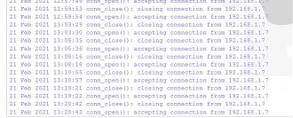

          Hello Together,
          after setup a new Loxberry v2, I switched from the "Modbus Powermeter" (EOL) to the "Modbus Gateway". Everything works fine so far after a manual start of the interface on the plugin page. But after a reboot I get the same error as user "Coolms" and I need to make a manual "start" again:
          Hab heute von User zmata das Modbus PRE-RELEASE Gateway Plugin für V1 in der Wiki entdeckt. Beschreibung vom Autor und Download: http://www.loxwiki.eu/display/LOX
          Unfortunately I installed a fresh version of loxberry and modbus plugin and after the first reboot ..."Active: failed (Result: exit-code) since Tue 12/24/2019 19:25:23 CET; 19s ago"
          If I press "start" manually everything is ok.
          Where can I find the requested "systemd log" to help solving that issue?
          Greetings Stephan
          @zmata: Thank you very much for the great plugin!

              I have the same problem with the Pre-Release 0.0.9

            Hello Dominik,
            thanks for your reply. I'm still using 0.0.8. Do you think 0.0.9 may fix the behavior?
            systemctl status after manual start:

            journalctl:
            (Failed startup after reboot, manual start at 14:21:52 succesfully)

            I hope the log is helpfull. Maybe the startup needs just a few seconds more...
            Would be great if you can fix this!
            Stephan

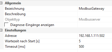

              bei mir funktioniert die Abfrage leider auch nicht. Kann mir jemand helfen, sonst muss ich wohl doch die >200€ für die Modbus Extension investieren...
              Abfragen möchte ich einen Schneider Energiemeter (iEM3200)
              Adresse am Gerät ist 1. Verkabelung müsste auch passen (habs aber auch schon gedreht zum testen)
              Hier meine Einstellungen:

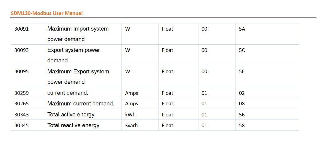

              #70

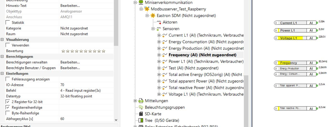

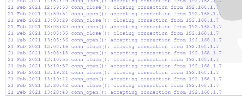

              Hi everybody,
              I do have some problems/questions, I realy don´t understand....
              I do use the ModbusGateway, connected to an Eastron SDM120 Modbus MID for 1 phase.
              Default settings of it: 2400 and 8n1 (as I know...)
              I did take the template for the Eastron SDM630 for my Miniserver and I do get some data. Thats nice, but:
              1) do I need to change it to 9600, I read it somewhere...?
              2) my log, why?
              Klicke auf die Grafik für eine vergrößerte Ansicht  Name: Lox-Log.JPG Ansichten: 0 Größe: 106,4 KB ID: 292499

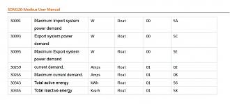

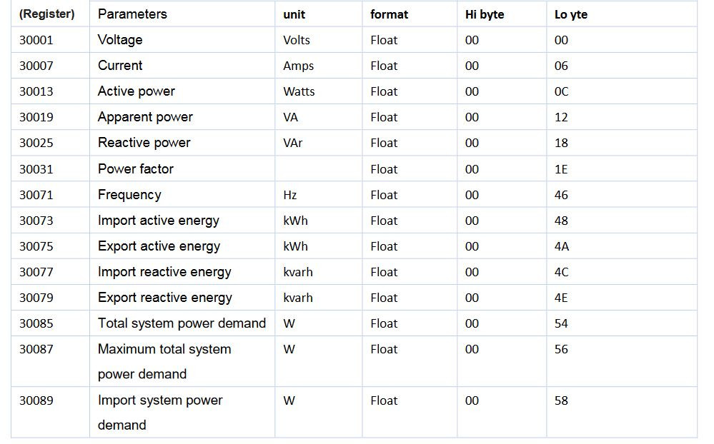

              At the end: Perhaps I am blind, but where I can find "KW used at all"? I would like to see, how much was used. Not at this moment, at the end of day or month....
              Is it "total active energy"?
              Klicke auf die Grafik für eine vergrößerte Ansicht  Name: Modbus01.JPG Ansichten: 0 Größe: 86,6 KB ID: 292500
              How to set "hi byte" to 01?
              Sorry for it.
              Irgendwer eine Idee? AlexAn Du vielleicht?
              Some ideas?
              Greetings
              Mike
              Zuletzt geändert von connor100; 22.02.2021, 10:52.
              • phil84
                • 05.12.2017
                • 65
                #71
                Hi Mike,
                I just implemented the Modbus Plugin yesterday and first it also was not working (caused by the wrong settings). You need to set following settings:
                Bus velocity: 9600 (depends what you have set at the SDM120; by pressing the button you can have a look on the settings)
                Modus: 8n1
                TRX control: rts (this was the wrong setting for my implementation)
                All other settings can handover from the standard from the plugin.
                Regards
                Philipp
