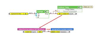

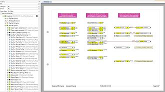

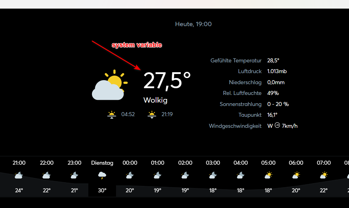

    Prof.Mobilux This is exactly what I have now.
Ansichten: 807
Größe: 122,4 KB
    But as I wrote before, the problem is that not all weather values are defined as system variables and I don't see a way to add custom system variables (like you can add in Weather inputs):
Ansichten: 780
Größe: 331,0 KB
    That's why I was looking to find a way to "fix" Weather service data pulled from the plugin.
    But now I hardly see a way.
    So I believe you'd suggest using values from plugin such as cur_w_dirdes, cur_tt_fl, cur_pr, etc?
      • 5329
      #1052
      Exactly. Use UDP inputs instead for everything else then temperature. This data is always up to date. No f*cking 60 minutes old data. I only use the system variable for temperature, because this way the Loxone App uses this data for displaying current weather in the upper left corner. All other values can be used from the UDP inputs.

      • TomekWaw
        • 25.07.2019
        • 450
        #1053
        Prof.Mobilux Thank you very much. I believe I finally understand how it works.
        I've added all interesting UDP inputs and it seems to work fine:
Ansichten: 845
Größe: 952,6 KB
Ansichten: 762
Größe: 146,2 KB
        Now I have finally exact current weather data in Loxone from a nearby WU station, and soon - from my own Wittboy weather station overwritten from FOSHK plugin.
        Then I will use them in my diagrams and also assign to all available system variables.
        Thank you very much again!

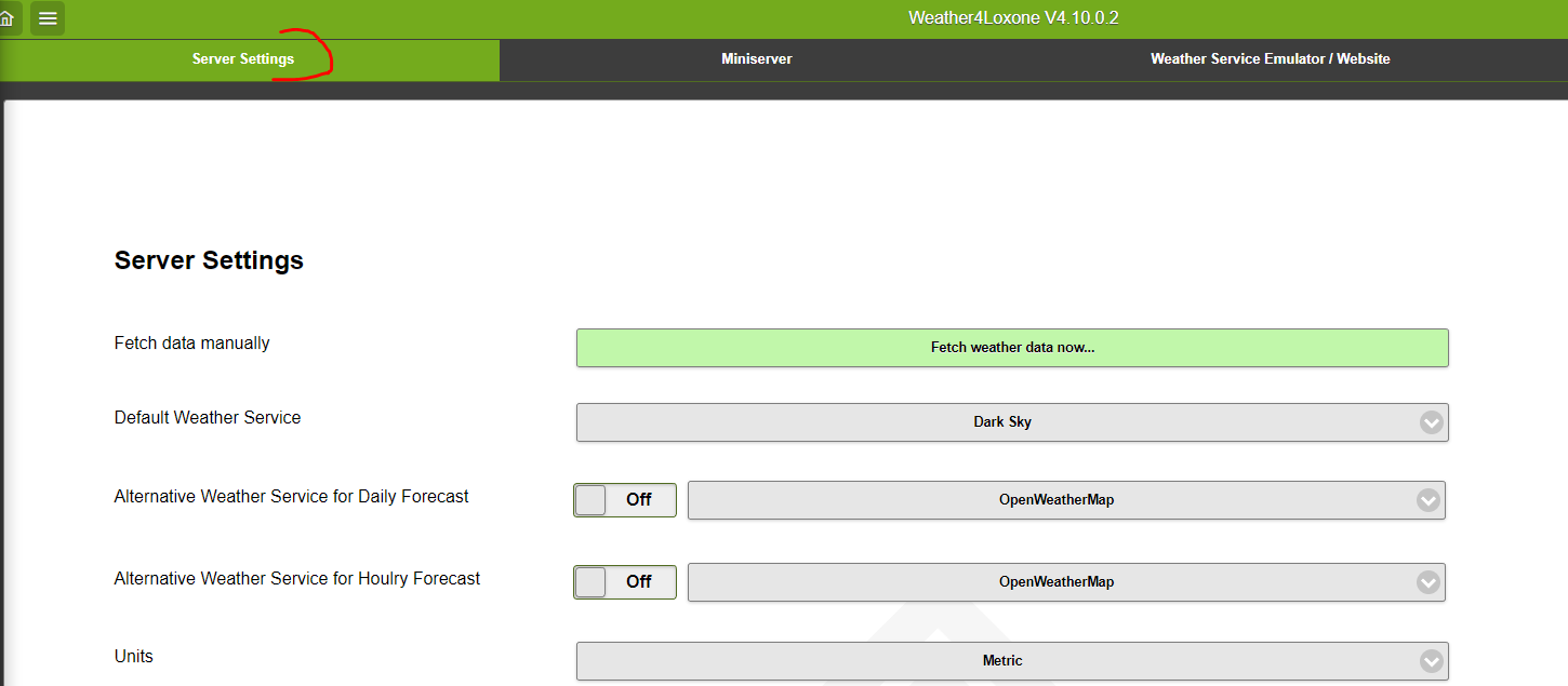

          Hello,
          Anything i try to change on the "Server Settings" page and then i hit SAVE, it end up with this error bellow. Not sure which LOG file should i check
          It's fresh new install of LoxBerry 3. Thanks
          Software error:
          Wide character in subroutine entry at /opt/loxberry/webfrontend/htmlauth/plugins/weather4lox/index.cgi line 1229.
          Depending of what you have done, report this error to the plugin developer or the LoxBerry-Core team.
          Further information you may find in the error logs.
Ansichten: 658
Größe: 50,1 KB
          This LOG?

            • 4025
            #1055
            Hello killeriq
            DarkSky API doesn't work anymore, that's the reason.
            Use a different weather service please.
            • killeriq
              killeriq kommentierte
              thanks, was able to save!

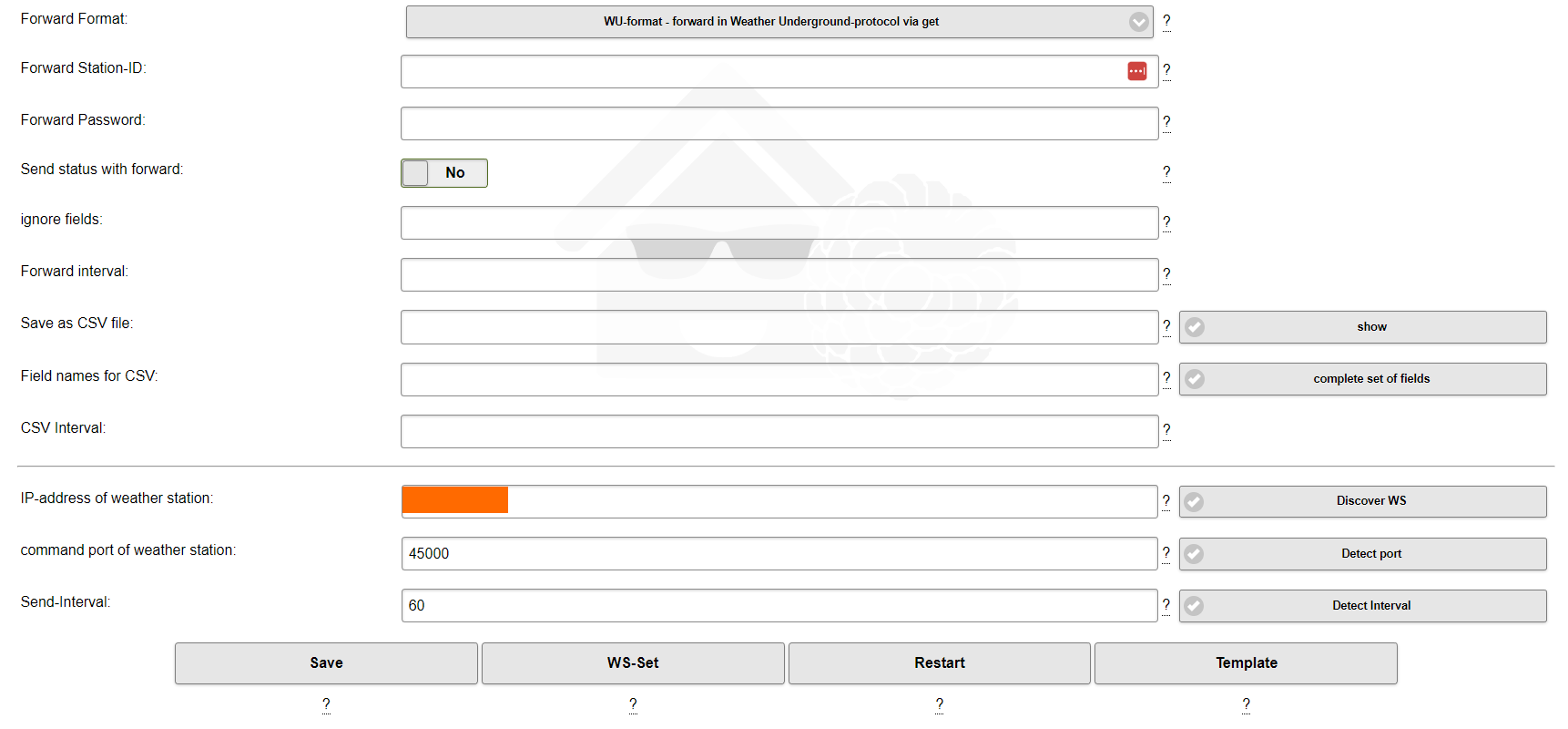

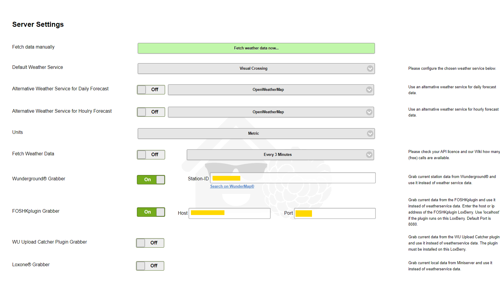

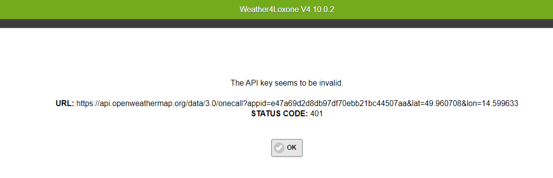

            Seems like also " OpenWeatherMap" is not working...even API key is correct , even i created extra new one (just in case)
Ansichten: 615
Größe: 23,7 KB
            Tried
            WeatherBit
            Visual Crossing
            Where i'm able to SAVE, great...but would like to grab data from my local station
            So therefor i've installed "FOSHKplugin" where seems i'm connected as on LoxBerry2 , but the weather is not yet showing in the Loxone App (Weather), is there anything else i need to do? Or just wait till it loads (not sure how fast is it)
            Checked the Loxone and seems the "FOSHKplugin" is sending data from My Local WeatherStation to Loxone and Loxone is receiving them / UDP
            Sorry for questions...but LoxBerry2 setup was some time ago and no clue what else might be wrong on 3.x version.
            Thanks
Ansichten: 518
Größe: 133,0 KB
Ansichten: 516
Größe: 82,3 KB
              Weatherbit needs subscription of the OneCall API. See Wiki.
            • killeriq
              thx, using Visual Crossing
          • killeriq
            • 91
            #1057

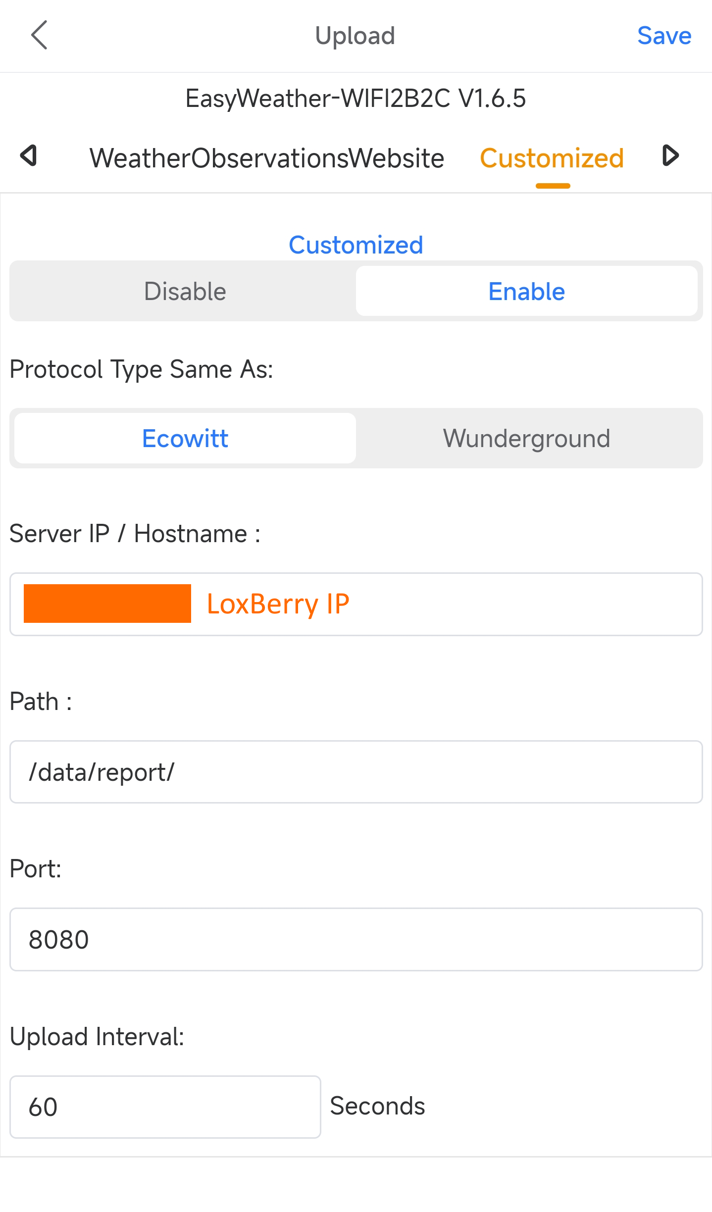

            I moved a bit...
            Seems like problem is with port? but no clue where i'm defining the 45000, In Weater app station is only the 8080, nothing else
            olicat Maybe you could suggest what else to try?
            .06.2023 16:22:31 TASK STARTED
            eather4Lox GRABBER_FOSHK process starte
            INFO: LoxBerry Version 3.0.0.6 ( is_arch_x86_64.cfg is_x64.cfg is_hwmodel_x86_64_vm.cfg )
            INFO: Weather 4 Loxone Version 4.10.0.2
            INFO: Loglevel: 7
            This is /opt/loxberry/bin/plugins/weather4lox/grabber_foshk.pl Version 4.10.0.2
            INFO: Fetching Data from FOSHK Plugin at 19x.xxx.xxx.xxx:45000
            URL: http://192.168.10.76:45000/observati...t/json/units=m
            Status: 500 read timeout
            CRITICAL: Failed to fetch data from 19x.xxx.xxx.xxx:45000. Status Code: 500
            26.06.2023 16:25:31 TASK FINISHED

              + Settings
Ansichten: 499
Größe: 138,1 KB
ID: 395442Klicke auf die Grafik für eine vergrößerte Ansicht
Ansichten: 502
Größe: 77,8 KB
              • olicat
                • 566
                #1059
                Hi!
                You have to adjust the port for FOSHKplugin in W4L & activate FOSHKplugin. See attached image.
Ansichten: 647
Größe: 98,9 KB
                Oliver
                • killeriq
                  • 91
                  #1060
                  I've changed it from 45000 to 8080 and i get right away this error
                  27.06.2023 10:30:34 TASK STARTED
                  Weather4Lox GRABBER_FOSHK process started
                  INFO: Loglevel: 7
                  INFO: Fetching Data from FOSHK Plugin at 19x.xxx.xxx.xxx​:8080
                  URL: http://192.168.10.76:8080/observatio...t/json/units=m
                  Status: 500 Can't connect to 192.168.10.76:8080 (Connection refused)
                  CRITICAL: Failed to fetch data from 19x.xxx.xxx.xxx​:8080. Status Code: 500
                  27.06.2023 10:30:34 TASK FINISHED
                  • olicat
                    olicat kommentierte
                    Hi!
                    Make sure FOSHKplugin is running and 192.168.10.76 is the correct address of the host running FOSHKplugin.
                    To test the availability of FOSHKplugin point your web browser to http://192.168.10.76:8080.
                    Oliver

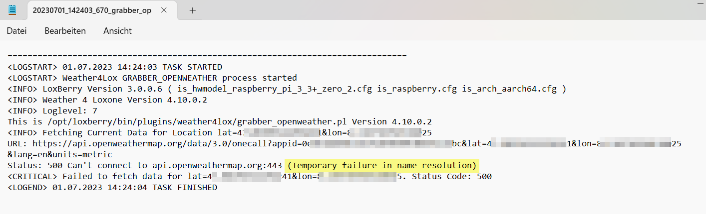

                  Hallo Zusammen
                  Ich beziehe die Daten von openweathermap und aus meiner ecowitt Wetter Station. Nun ich habe min Loxberry frisch aufgesetzt und bekomme beim Speichern im Weather4Loxone immer einen 500 Fehler (Could not receive any data). Wenn ich die URL im Browser oder im Postman bekomme ich die Daten (inkl. 200 Status). Kennt das problem jemand?
                  Gruss
                  Chris
                    Das hast Du gelesen? https://wiki.loxberry.de/plugins/wea...openweathermap
                  • Chiten
                    Chiten kommentierte
                    Ja, habe ich. Habe ich was übersehen? Wenn ich den GET-Request mit meinen Parametern direkt ausführe, funktioniert es. Die Lizenz bzw. API-Key wird daher akzeptiert.
                    OK. Dann schicke mir msal das Logfile mit dem GET Request per PN. Dann schaue ich mal, ob sich da etwas geändert hat,
                  • 5329
                  #1062
                  Chiten Dein LoxBerry kann keine DNS Anfragen auflösen, deswegen findet er den Host von OpenWeatherMap nicht. Da hast Du noch ein Problem bei Deinen Netzwerkeinstellungen.
Ansichten: 491
Größe: 50,9 KB
                  • Chiten
                    Chiten kommentierte
                    Gerne ;-)

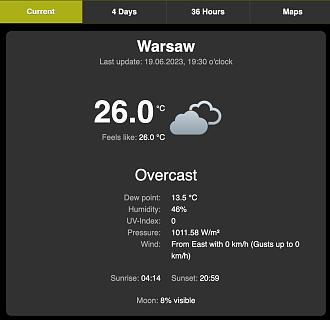

                  Is there any limitation on Loxone 12.2.12.1?
                  As even the Local weather station is somehow not working , i used WU option (data from my station to WU), but there are no data shown in Loxone UI Web / nor Android app
                  Thanks
Ansichten: 418
Größe: 3,7 KB
