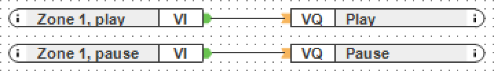

          You should connect the different virtual inputs provided by the plugin assistant (let me know if they don't work, I quickly coded that part) to commands that are issued to the LMS CLI (usually via port 9090).
          So, for instance, you get the [Zone 1, play] virtual input (that listens for a 1::‍play command), and connect it to the [LMS Squeezebox player 1] virtual output (that pushes a PL:AY:ER:MA:CC:00 play command). This way you cable the click of the play in zone 1 of the Loxone UI with a virtual output that issues the command "play" to the corresponding player (according to its provided MAC address). Something like that:

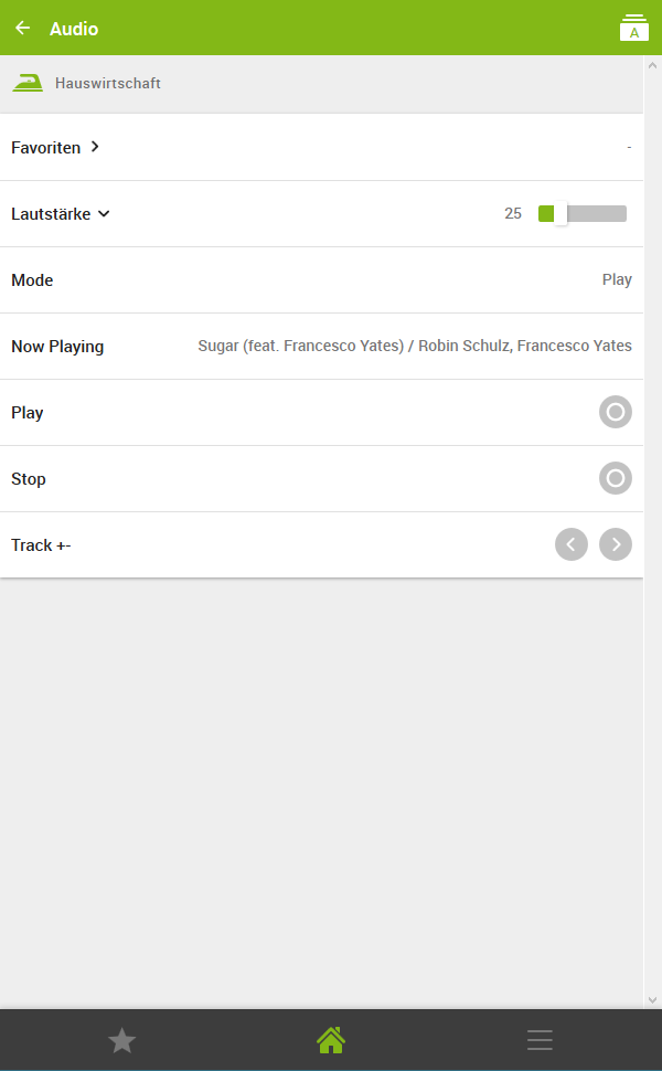

              Got it work native on the MS4L...
              Play/Pause works fine Volume always show 0,0 and is not updated
              Titel/Artist works only if you do a control from the Loxone App, if you do eg a title change with an external App it dosn`t update.
              Next try ist Album Cover..

                Found the issue...
                It works if you klick the Speaker Icons with +3 -3 steps but if you use the Slider with an absolute value it shows an the Unknown Command

              Album Cover not show up, the skript receive the URL but nothing changes.
              [DGRM] Received message: 1::setAlbum::https://i.scdn.co/image/ab67616d0000...3376e1e95c6980
              Also with other commands that show up when I use 3th Party Apps e.g.
              [DGRM] Received message: 1::setTitle::What's Luv
              Nothing change in the Loxone App.
              Zuletzt geändert von hismastersvoice; 14.04.2020, 08:05.
                Ok I changed it, but I get these from you Auto-Created I/Os.
                There is in 2 VQs setAlbum so maybe the creation of the VQs are not correct.
                Artwork is OK now
                Copy-paste I noted it for fixing too
