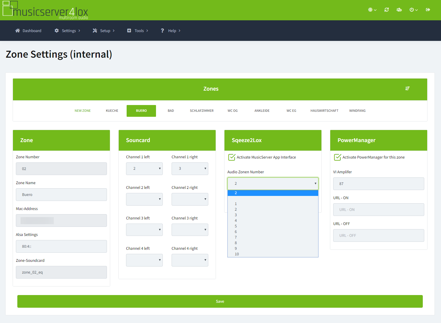

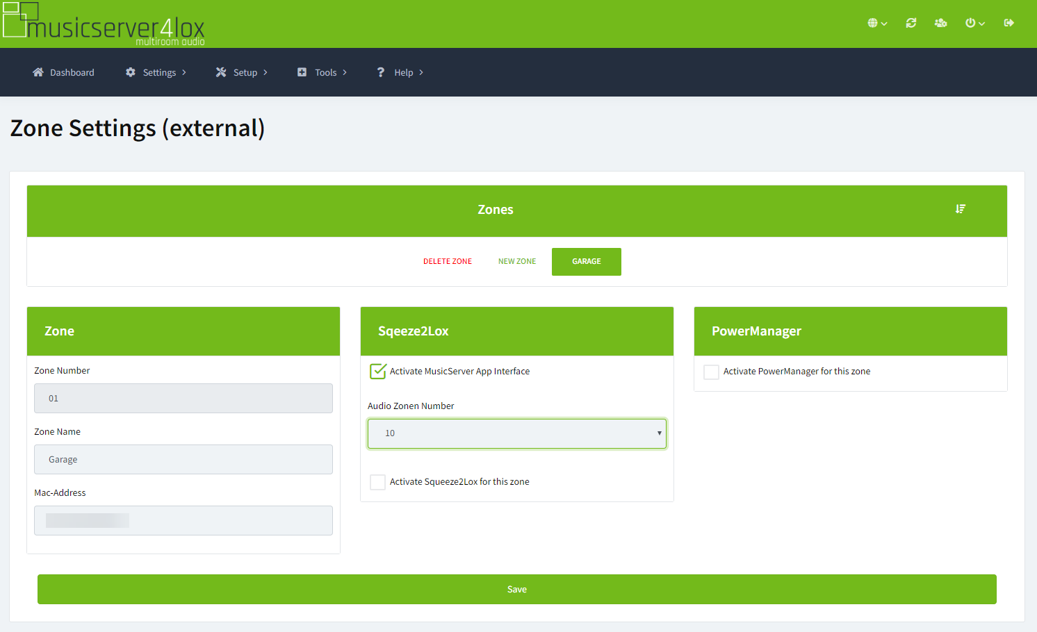

              This is my first idea to integrate it into the structure.
              You can set a number of the used Audio-Zone in the Config, in my test-case 1-10 (9 internal zones + 1 external Zone).
              The Gateway now knows to how to handle the receive/send commands and don`t have to use VI/VQ in the MiniServer.
              If set more than 20,40,60... Zones, the Gateway switch to the next UPD-Ports
              Question to all, are you think that is ok in this way?
              The same could be done on every other Gateway like Loxberry etc.
              Additional I think about the set the number automated, but I think that make it more confused than to set by hand.
              If needed there keeps the way open to change the settings to keep a structure more clean.

                Ok, now I get it, thanks for the clarification. I keep fingers crossed for the progress
                > I do some testing how to bring it in to one.
                The `bin/service` folder (in which the whole service is) will remain there forever. One possibility that comes to my mind is to download the repository (or set it as a submodule of MS4L), and manually call `new MusicServer` passing configuration to link them internally, inside the music server. The plugin will need to keep existing (other LMS gateways, other setups, etc.) but this way inside MS4L everything would get simplified.
                That is what I do for now.
                I take out the bin of the zip, change the data.cfg path and work with it. That makes it easier to check what are the possibility.
                For now I do the changes by hand, for later we can maybe think how to handle.
