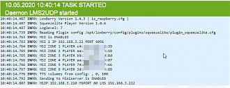

                  the Logitech Media Server Gateway from Squeezelite Plugin is now ready for alpha testing with MSI Plugin (as MSG). It's all alpha state at the moment - so you have been warned :-)
                  Currently we have implemented all Push-VOs of the MSI. So no need to import the VOs in LoxConfig anymore. VIs will follow soon, but are currently not implemented. Also there's no WebGUI at the moment for configuring the LSG. You have to edit the config file by hand.
                  HowTo test:
                  Be sure that you know what you are doing! This is alpha state and only for experienced people!
                  Install the latest dev branch of the Squeezelite Plugin: https://github.com/christianTF/LoxBe...rchive/dev.zip
                  Configure the Plugin as LMS Gateway as usual.
                  Login with SSH and edit /opt/loxberry/config/plugins/squeezelite/plugin_squeezelite.cfg and add the MSI instance:
                  [MSI]
                  Activated=True
                  Musicserver1_Ip=192.168.3.22
                  Musicserver2_Ip=
                  Musicserver3_Ip=
                  Musicserver4_Ip=
                  Musicserver5_Ip=
                  Musicserver1_Port=6091
                  Musicserver2_Port=
                  Musicserver3_Port=
                  Musicserver4_Port=
                  Musicserver5_Port=
                  Musicserver1_Z1=c4:32:xx:xx:32:39
                  Musicserver1_Z2=aa:aa:xx:xx:be:18
                  Musicserver1_Z3=b8:27:xx:xx:1d:8d
                  Musicserver1_Z4=aa:aa:xx:xxf:25:07
                  Musicserver1_Z5=74:ea:xx:xx:07:66
                  Musicserver1_Z6=3d:a9:xx:xx:d3:88

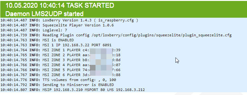

                  The plugin supports up to 5 fake music servers and up to 30 zones for each music server. You have to "connect" each MSI zone to one of your LMS players (mac address only, currently no names are supported).
                  Turn on debug logging.
                  Restart
                  Check the logfile if the MSI interface was loaded correctly:
                  Klicke auf die Grafik für eine vergrößerte Ansicht  Name: 10-05-_2020_12-03-51.jpg Ansichten: 0 Größe: 147,4 KB ID: 248697

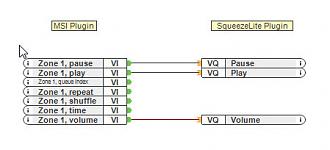

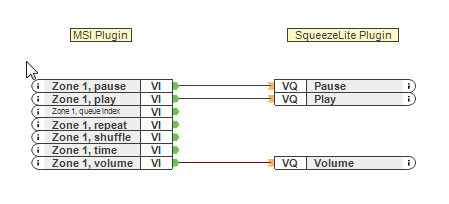

                  Add your Fake Music Server to LoxConfig as described in the Wiki and connect the VIs of the MSI Plugin to the VOs of the Squeezelite Plugin. We will implement the VIs also in the Gateway, but currently this work is in progress. No need to import the VOs of the MSI Plugin.
                  Klicke auf die Grafik für eine vergrößerte Ansicht  Name: 10-05-_2020_12-06-50.jpg Ansichten: 0 Größe: 27,9 KB ID: 248698
                  That's all.
