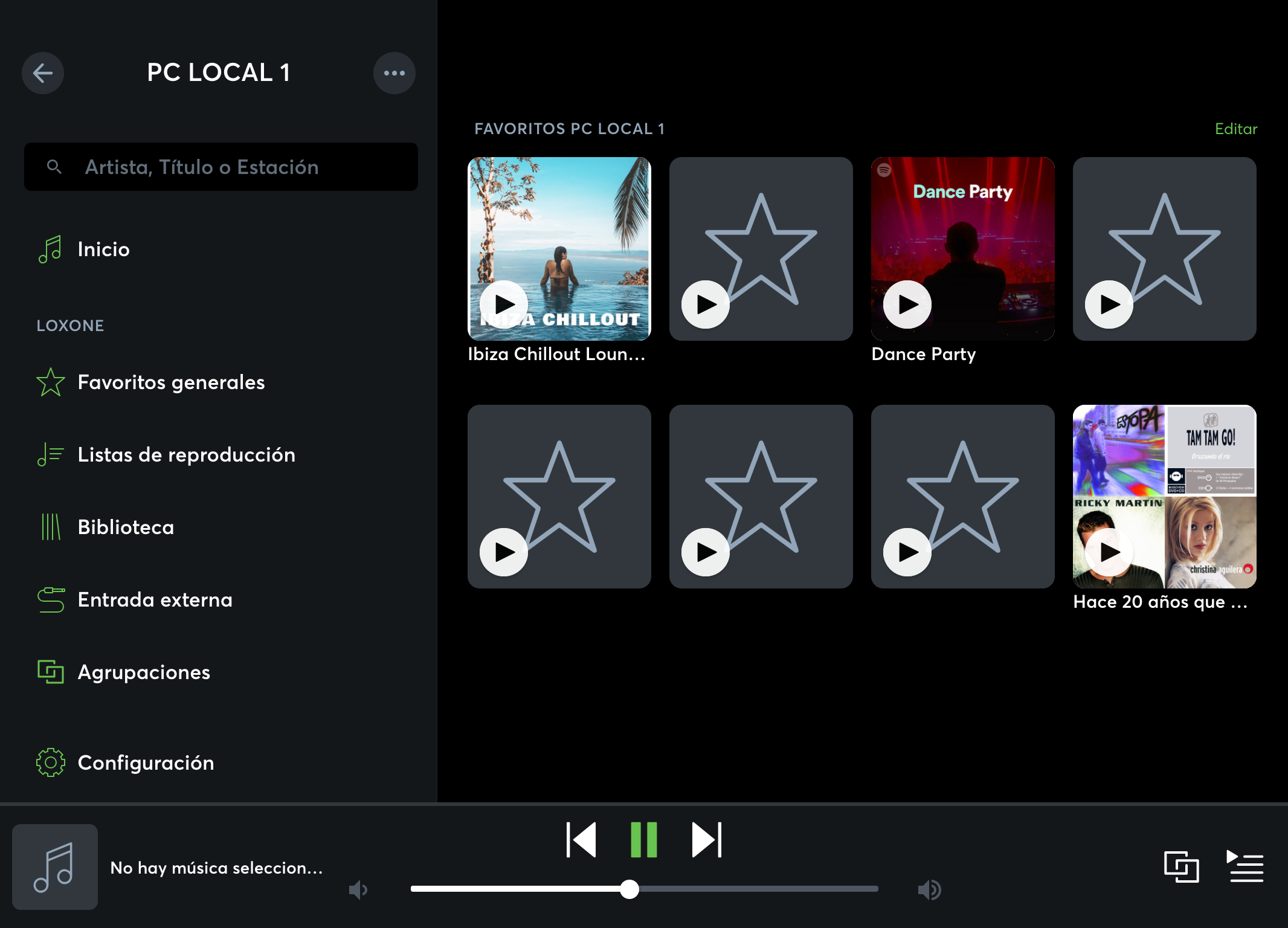

              Zitat von hismastersvoice
              Gast
              can you say what is /favorites/0 and where are they shown?
              I only have implemented /zone/X/favorites/0
              Are there only room favs available or also global favs?
              From what I saw in v10 (the UI served via web server from my current LMS), they have a "global favorites" option, aside with the "room" favorites. So i mapped both as you described. I think you can try returning fake data and you'll see them appear in the UI.
              Is there a possibility to do more than 8 favs?
              Ha! Interesting question! I initially tried returning more than 8, and the UI actually renders them. But if you try e.g. removing one favorite, the UI gets broken because of too many favorites. Same thing for manually adding them; the UI controls before pushing you the new favorite if you have exceeded the global 8 favorites. At this point I just decided to cap favorites to 8, and make them work like the UI expects. But I agree it's kinda sad
                I have fond that these Fav are right bellow of the room-favs, and I have allready integrated it.
                8 Room-Favs are OK, the Global-Favs are also there. So far it works perfect for me an my wife. She likes it really.

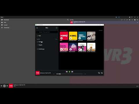

                Gast
                I think there is an issue with the player state.
                If I start the player with an 3rd Party App there is no update in the AppUI.
                Look like you start the state update with the play from the App??
                Made a short Video for better understanding.
                If I start the Zone with play in the App everything works fine.
                The problem is if I start the Zone with eg Loxone Touch T5, there starts to play but not to update the zone-state.
                  No T5 don´t work
                  Zone off (double kick)
                  [WSCK] Received message: audio/2/off
                  [HTWS] Unknown command: audio/2/off
                  RoomFav + (doublekick)
                  [WSCK] Received message: audio/2/roomfav/plus
                  [HTWS] Unknown command: audio/2/roomfav/plus
                  Volume (single Klick)
                  works
                  Same here. The state is only updated when the player is set to play. But from my understanding we will implement push updates in the future? Pulling the state every x seconds is ok as a workaround, but from my point of view we definitely need push updates in MSG.
                  OOOOOOOOOH! The T5 is the one producing the "off" command! I looked (and asked) about this for a while. I can map this one to stop. I'm not sure they're fully equivalent, but we will discover later!
                  Regarding the polling, you're right. We do not poll if you're not playing, but that's a bug! By definition MSG tries to emulate as much as it can if you don't provide certain commands. This is a case where not implementing SSE would still have to work.
                  I will fix all three bugs (zone off, next favorite, state polling) on the weekend!
