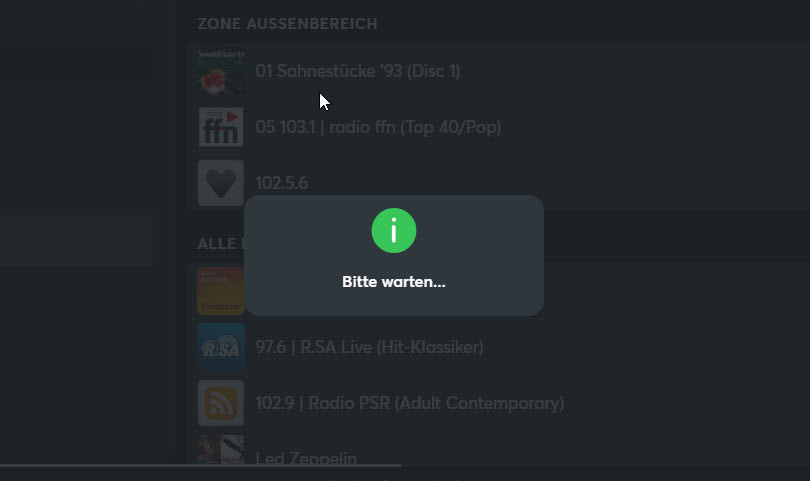

    When I use the Lox App an go into Zone -> Favorites the msg is get/favorites/0/50
    An at Port 8091 I get the call /favorites/0 that told me to read the "global favs".
    Klicke auf die Grafik für eine vergrößerte Ansicht  Name: 26-05-_2020_09-53-07.png Ansichten: 0 Größe: 50,7 KB ID: 251133
    If I leave the Zone and go back into Favorites the same msg, but there is no call to 8091.
    Klicke auf die Grafik für eine vergrößerte Ansicht  Name: 26-05-_2020_09-53-36.png Ansichten: 0 Größe: 38,5 KB ID: 251134
    Is there any reason?
    I ask becouse, if I change the Fav in the WebUI I always have to restart the MSG to get the changes.
    If you can include that call all the time I go into Favorites of a Zone it is not needed the restart.
    PS: The same for Playlist audio/cfg/getplaylists2/lms/noUser/0/0/50

      Yes; lists are cached in the system. If they've been requested once, we don't request them again. What is missing here is the SSE interface to be able to tell the service to "uncache" them.
      The cache should automatically be invalidated when you add or remove via UI (Loxone UI, not LMS or MS4L). If it's not happening it's a bug. I will check.
      Never tested add/del global favs.
      With room favs it act exact like you describe.
      But the room favs generates also a request when you leave the fav section and go back in it again.
      With global favs that shows the msg but don't load new.

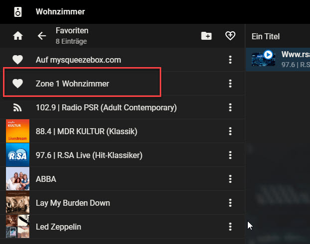

    Room-Favorites Handling works
    The Global Favs can be add or delete in the WebUI of the LMS.
    There is still a bug when add or delete more than one Fav at one Time.
    Add and Delete for all selected work like expected, but after it is done, it goes into a loop of "zone/XX/favorites/0"

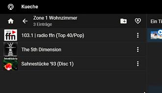

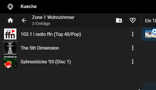

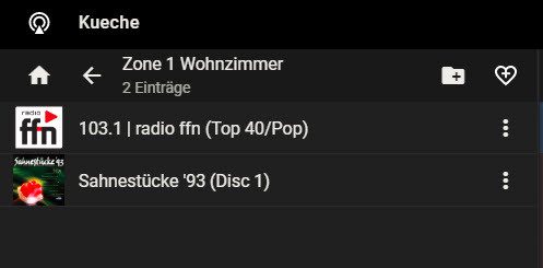

      Next step for the Squeezelite Plugin is ready: Global and room favorites are working now. I realized in completely in LMS without any extra files. Global favs are in the root fav folder of LMS, room favs are in a subfolder called "Zone <zone> <any text you want>", so e. g. "Zone 1 Living Room". If the room favs for a zone is requested by MSG, the plugin looks for such a folder and give back all included favs from that folder. If it does not yet exists, it will be created using the Player Name.
Ansichten: 1492
Größe: 54,1 KB
      Zuletzt geändert von Prof.Mobilux; 29.05.2020, 06:42.
        Never tested more than 6 :-) I think this is a limitation of Loxone...
        Yes is a limitation of the UI,but there is often that we can go around the limitations from Loxone
        Unfortunately in V11 they have added a hard-limit of 8. Before, you _could_ let it go above. You could not edit them, etc, but it was possible to show them. In V11 they create an array of 8 elements, and they copy the items over there. So if you're above the limit it does not show them. I will try other approaches by looking at the code, but don't count on it

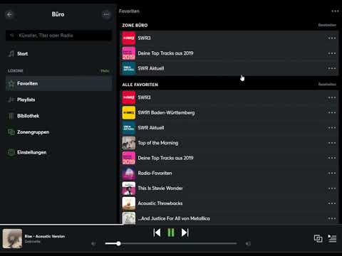

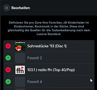

      hismastersvoice How do you handle the favs if you e.g. delete one in the middle of the list? Example: You have 3 favs and delete fav no. 2. So if you delete this fav in Loxone, you have an empty fav in between:
      Klicke auf die Grafik für eine vergrößerte Ansicht  Name: fav_lox.jpg Ansichten: 0 Größe: 42,0 KB ID: 251740
      If you then delete the fav via CLI in LMS, formerly fav no. 3 becomes fav no. 2 etc., because LMS do not know any empty favs in between the list (as far as I know). Next time you reread the favs, you have a different order in Loxone (fav 3 is now fav 2). This may confuse the logic in LoxConfig, if you use for example AQ.
      Klicke auf die Grafik für eine vergrößerte Ansicht  Name: fav_lms1.jpg Ansichten: 0 Größe: 26,5 KB ID: 251741Klicke auf die Grafik für eine vergrößerte Ansicht  Name: fav_lms2.jpg Ansichten: 0 Größe: 20,3 KB ID: 251742
      I see 2 options:
      1. creating a dummy fav in LMS via CLI and filter it out when sending the favs to MSG (very complicating....)
      2. Doesn't care about any empty favs and accept that fav numbers can change in LoxConfig
      Does anyone know how the original music server handle this?
      Zuletzt geändert von Prof.Mobilux; 30.05.2020, 08:28.
        hismastersvoice Just see in your Video above that you realized the "empty" favs in between the list. Mmhhh, seems to be a little bit easier for you because you save them in files instead of handle them completely in the LMS...
        FYI: lists allow empty gaps with `null`. In fact, when you detect the `delete` with the index, you should not drop the item, but switch it to NULL. One idea that comes to my mind is to change the name of that list to something that you can recognize later in your connection to send null. This way you can always keep the 8 elements and do the filtering on the squeezelite gateway.
        Gast Thanks. I will handle this by myself. I would like to have favs always snyced between LogitechMedaServer and MSG. So if it is deleted in Loxone, I will also delete it in LMS. It's fine this way - I can handle it here.

      Prof.Mobilux
      The add and delete in the middle is no problem for me because of store the the favs in a file.
      If a Fav is deleted or renamed in the global Fav don´t also matter because the url/name for the room fav is still saved.
      You have than different names in global an roomfav, so you have to del and add again in the app.
      But everything still works also without changing.
      I do it the following way
      -> read roomfav-file or create it with the first fav in the global list. Loxone has a problem if there is no room fav when the app is calling.
      -> json -> array -> now i can search for the key. eg fav 4 in the middle is deleted I replay the array with a null
      -> array -> json an the favs can be read again
      Important is not to delete in the middle.

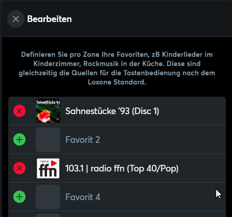

        How do you reply to MSG when replacing a roomfav with a global fav? Do you reply with the json favlist?
        I haven't implemented this yet, but if I delete the first roomfav and add a new one from the global fav into the free first position, the web ui responses with "Bitte warten" endlessly...
        Klicke auf die Grafik für eine vergrößerte Ansicht  Name: fav_lox2.jpg Ansichten: 0 Größe: 26,0 KB ID: 251778

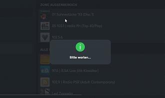

          Add/Del Fav in the App always do a call to get the new roomfavs after closing the windows, so I write add/del to file and the next call reads the roomfav again.
          Format is always json <->
          The global fav are only read after a restart of the MSG, like the post #122.
          So I have implemented that after fav change in the LMS WebUI the MSG gets an restart. Not nice but works until #122 is fixed.
            Ok, but e.g. the DELTE command itself from the MSG does not get any reply in JSON format from you? You wait until the new call for the roomfav is coming in?
            no, none of them get anything back at del/add.
            Only if the request the favs
            Correct. When issuing a POST / PUT / DELETE command, the list is internally invalidated; and a new request will happen as soon as data is required, which is often immeditately.

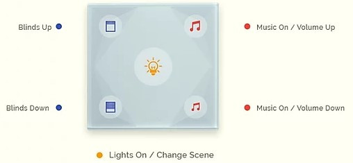

            For my understanding, do I have to send the URL in the body as json or how do I send the URL?
              #131
              1. I'm not sure if we should switch the zone to "on" when changing the volume... is this the case on the real one? It's easily doable, but I'm unsure.
              2. That's a bug 😳 I removed zones for testing, should be good now.
              3. Yes, in the body of the request, or as a SSE data message. I recommend reading the MDN article on the format because it's very illustrative and actually contains an implementation example.

              If you use T5 and the Zone is not playing, so we have to set play with the single klick. There is no other way how to set the Zone via T5 to play.
              Is the Zone plays music and there is again a single kick or you stay on the witch the volume goes up.
              Double klick do the Roomfav next.
              Klicke auf die Grafik für eine vergrößerte Ansicht  Name: 3.jpg Ansichten: 0 Größe: 15,6 KB ID: 253211
              2. I´ll try today
              3. Read a bit about it, but didn`t understand 100% how it works on the MSG, will also play a bit around.
                This is very very interesting. I'm surprised that the T5 sends a volume up even when the music isn't playing. What is it supposed to play? The first favorite?

              I think there is a bug in roomfav/plus
              If I select a Fav like here RoomFav 1 and stop the player. It look like this
              Klicke auf die Grafik für eine vergrößerte Ansicht  Name: 09-06-_2020_12-09-42.png Ansichten: 0 Größe: 16,1 KB ID: 253417
              After I press Play again the AQ switch to 0
              An the RoomFavs starts again with 0.
              Klicke auf die Grafik für eine vergrößerte Ansicht  Name: 09-06-_2020_12-09-59.png Ansichten: 0 Größe: 16,0 KB ID: 253418
              Without stop it works, but after every stop it switch to 0.
              Zuletzt geändert von hismastersvoice; 09.06.2020, 13:24.
                Also I didn't get the call for reading the queue.
                In the queue window is always only the actual played song.
                When you say "I stop the player" is it "stop" or "pause"? Asking because that sulbte difference is important. If it is "pause" the favorite should be kept because it is still playing; but if it's "stop" it should be 0.
                stop... T5 on the lower button sends a stop (audio/off) signal and not pause.
                Even if its stop it should keep the last played fav/title.
                Only if you load a Playlist or a Global-Fav the Room-Fav should be reset.

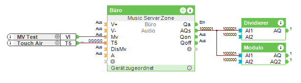

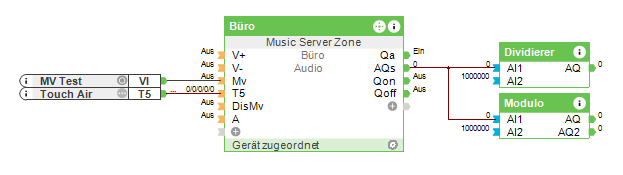

              Gast
              One additional question to that...
              Is ist possible that I send the ID like 1000001 or 3000001 etc. to the MSG / LoxoneMusicServer?
              If I load a Fav or Playlist from outside the LoxApp the ID don´t fit anymore, so I like to reset at least to 0000000 that the next klick start at the beginning of the RoomFav-List.
                Ah, good question... in theory we should be able to do this; let me think a bit on how to extend the format to achieve it. In general I would prefer avoid having to set something like `"favorite": 3` in the JSON, so we may do it with the playlist name.
