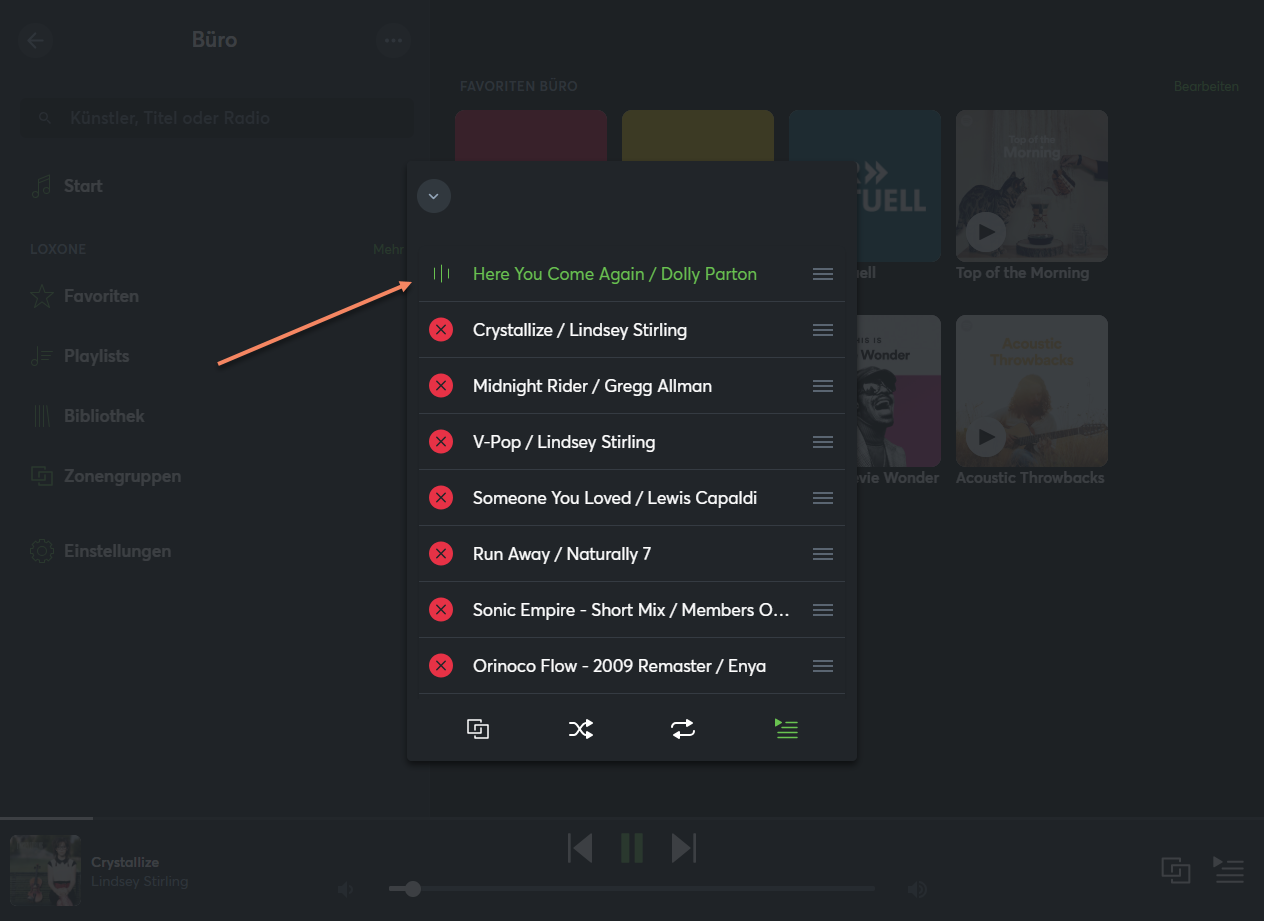

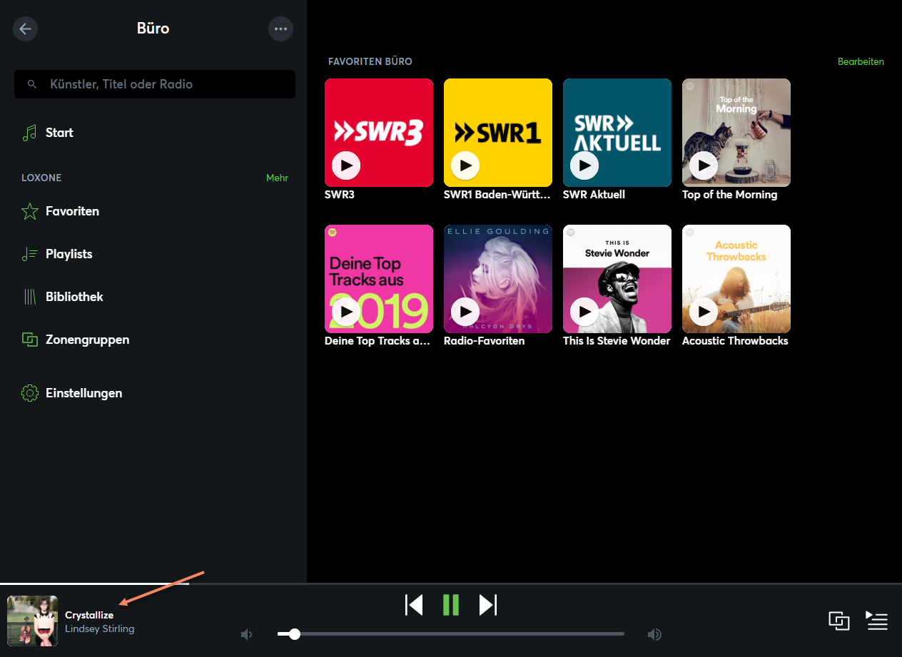

      hismastersvoice Prof.Mobilux I just uploaded a new version to the repository with some bugfixes:
      • Fixed playing a favorite (the Loxone folks really like adding play commands; it's the sixth I have to map!).
      • Incorporated alarms via new endpoints (/alarm/:type/:volume). TTS is still in the works.
      • I made the favorite output of the Loxone Miniserver work (AQs zone ouptut). Read below!
      I have (ab)used the way the favorite zone identifier works. In short, the number is a 7-digit identifier, that tracks the source playing the track, and the position. This is actually more flexible than the expected way of using this entry! I have explained how to get the identifiers back from this encoded number in the docs, but here's the short summary:
      I'm checking now the zone on - zone off thingy which is a bit tricky on how to make it properly behave as I don't want to overload the API.

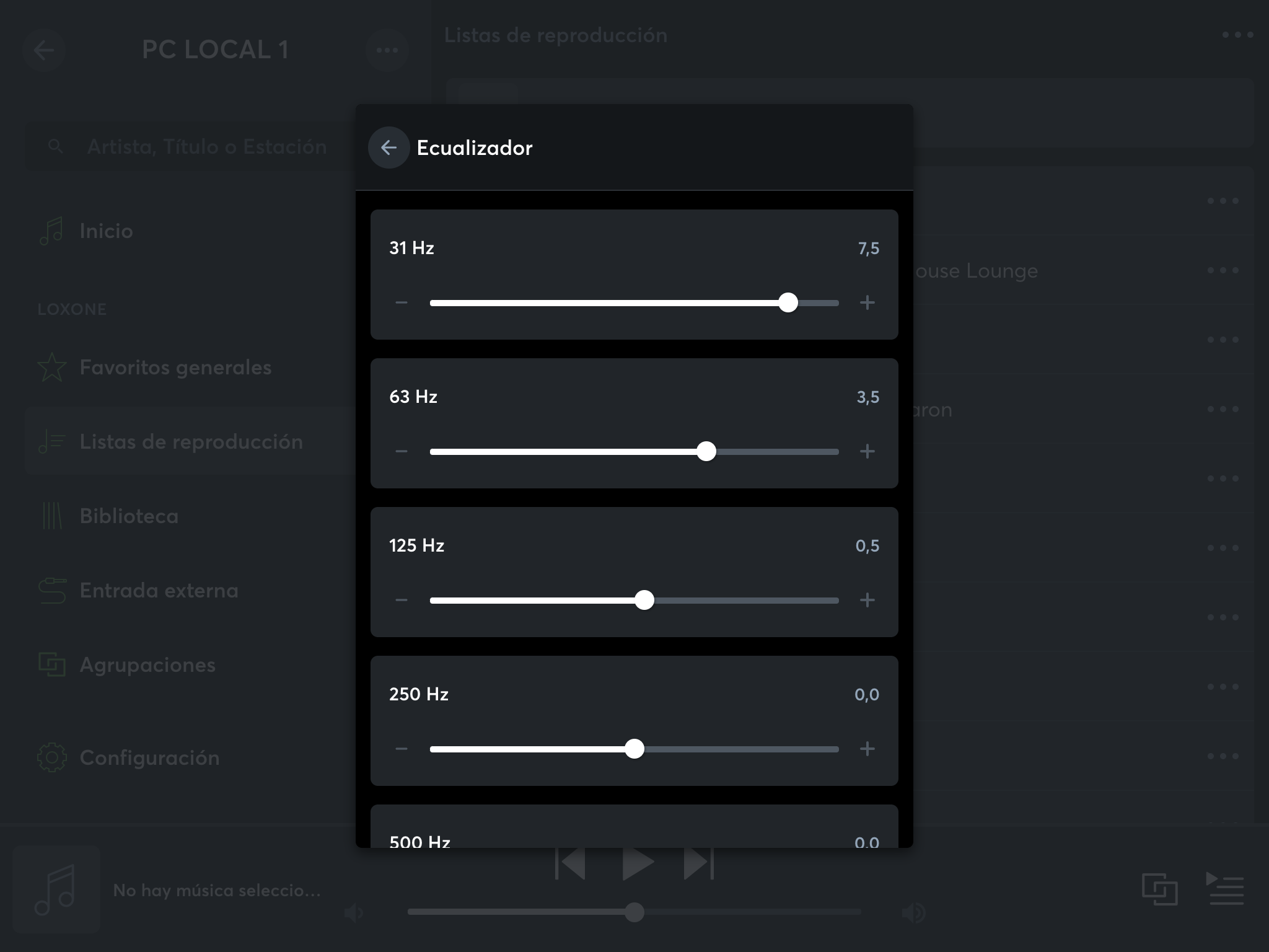

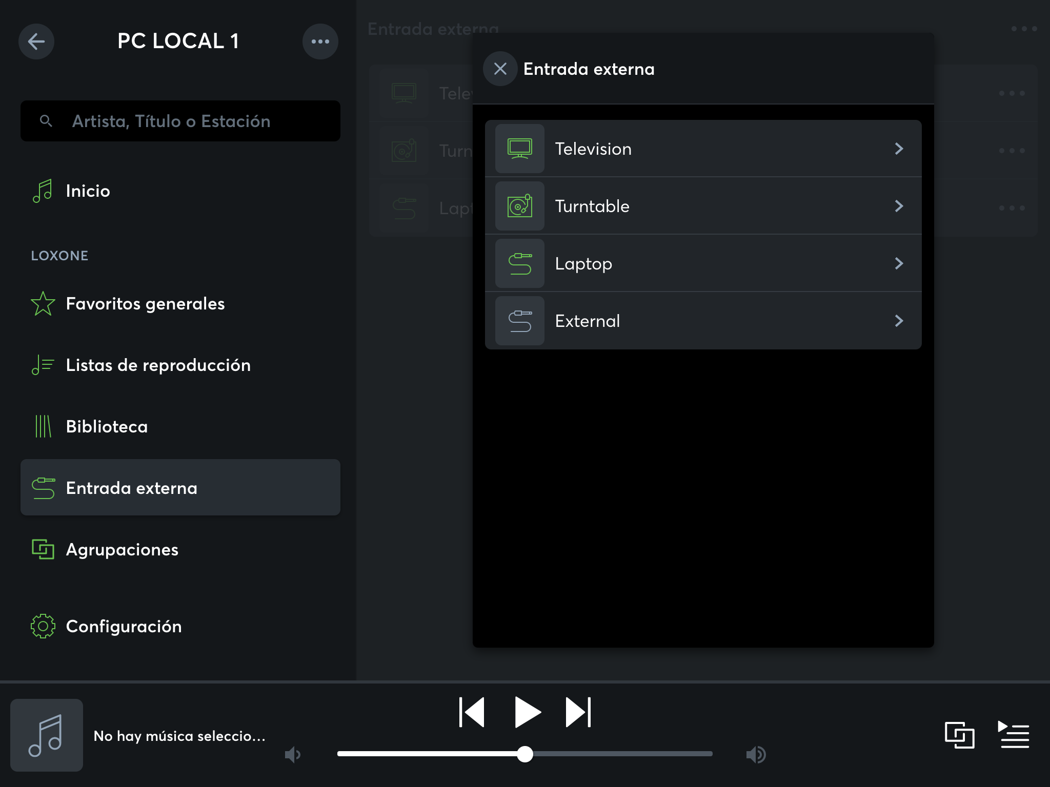

        I just added support for:
        • Equalizer (GET / PUT). More info in the docs about how to read / write the values coming from this input.
        • Icon support and modifications for inputs (line-in entries). Also added documentation on how to use those.
        • Added playlist creation support via UI.
        • Enabled storing a global favorite from library / playlists.

          Thanks for update,
          When I start the MSG I get a lot of "[ERR!] Default behavior for "play": Cannot read property '0' of null" messages.
          Not sure why there is "play": when reading the Eqaulizer.
          When I turn the EQ in the App I get
          --> [CALL] Calling PUT to http://localhost:8091/zone/2/equalizer
          [ERR!] Default behavior for "equalizer": Cannot read property '0' of null
          Is the Value of the EQ stored in the App/MiniServer or do I have to store them and send em back?

            You have to store them and return them back; mostly because the Loxone UI (and Loxone Miniserver, the equalizer values are read from this one too o.O) need to know what are the values currently being used by your equalizer (for instance, if you update it externally once we get the SSE interface working).

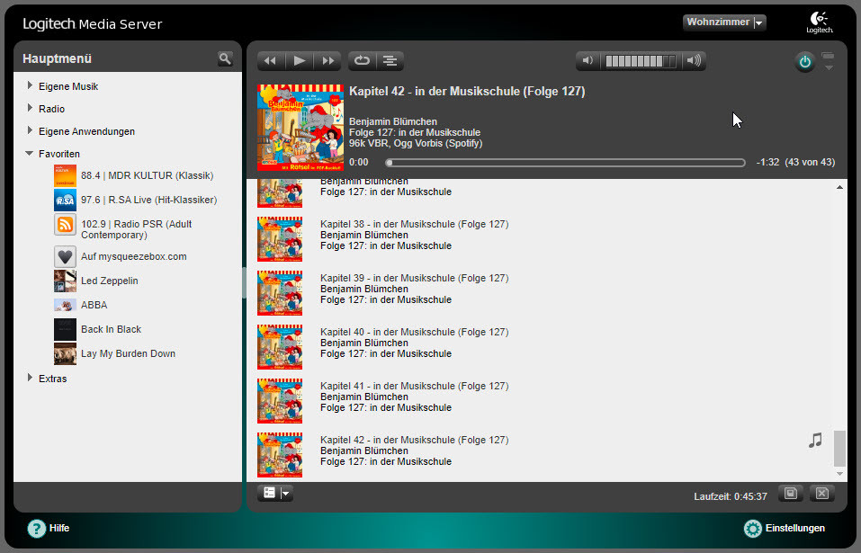

          hismastersvoice Mabye a stupid question - but where can I find Player Favorites in LMS's WebUI?! It seems that I only have global favs in the WebUI. If I add something to the favorites, it's always been added to the global favorite section.
Ansichten: 1028
Größe: 177,8 KB
          • hme0354
            hme0354 kommentierte
            It is possible to make folders under the favorites. Maybe loxone makes one for each room?

            #116
            Gast
            Still have also the Problem that in the Queue is always the first Title shown as played. Also the Cover is shown from the first titel.
            How can I give the Musicserver the index of the playes title for the queue?
Ansichten: 806
Größe: 145,8 KB
ID: 250864Klicke auf die Grafik für eine vergrößerte Ansicht
Ansichten: 781
Größe: 262,2 KB

              #117
              Gast
              I play this morning a bit around with the Equalizer.
              To be honest I don´t understand it
              With the start of the MSG there is a request of the values, so far so good.
              When I change a value in the I get a request like. [Mon May 25 07:14:20 2020] 127.0.0.1:54038 [200]: /zone/2/equalizer
              So the called URL is without the values?
              So how should I get the changed values from the MSG to the Router-Script?
              How should the format look like?
              In the description there is "The format is returned in a 10-band ISO compliant array", but I get a msg that it should be a json format.
                Ok Thanks.
                If I read the content, the first Value is always a NULL. Don´t matter what I change in the Loxone App, it stays a NULL.
                The rest of the values change like expected.
                Any ideas to this?
                null,
                -2.2,
                -0.2,
                -1,
                -1.5,
                -3.5,
                -2.5,
                8,
                9,
                10
                Thanks...
                got it, there was an ! at the first chapter, don´t now why... After reset the MiniServer there was without.
                Puuuhhh... EQ works.
                Was a bit more tricky than I expect
