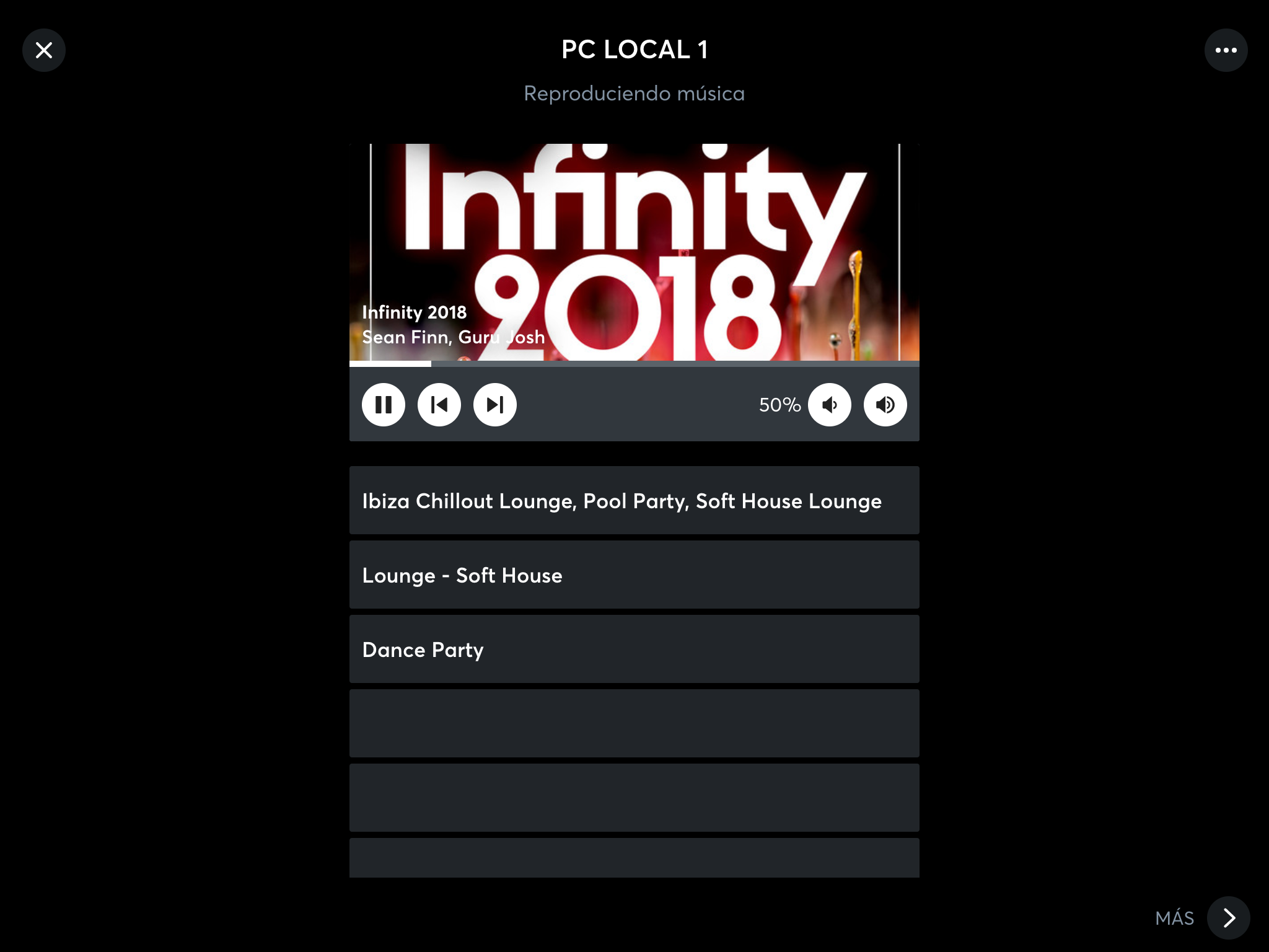

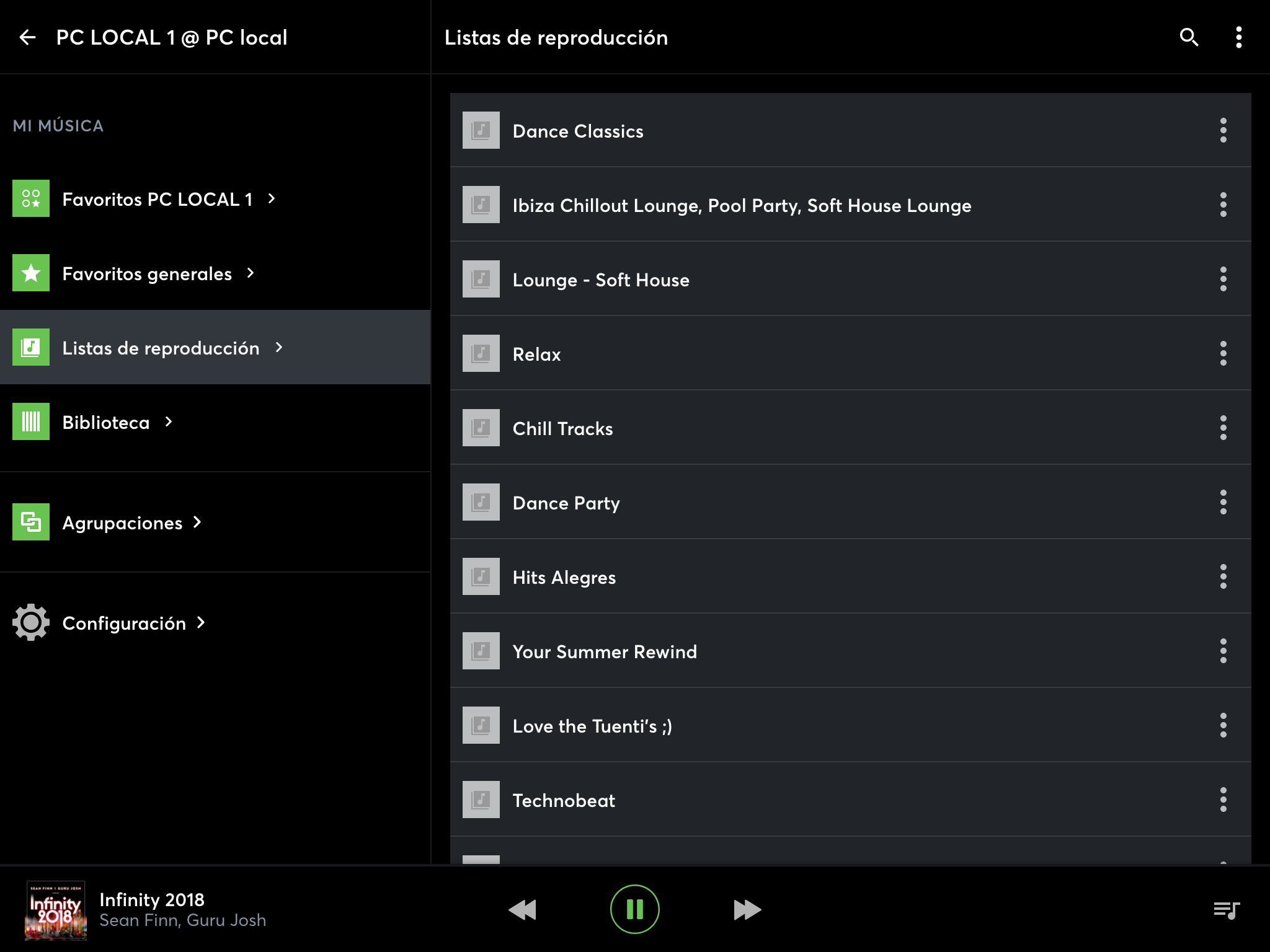

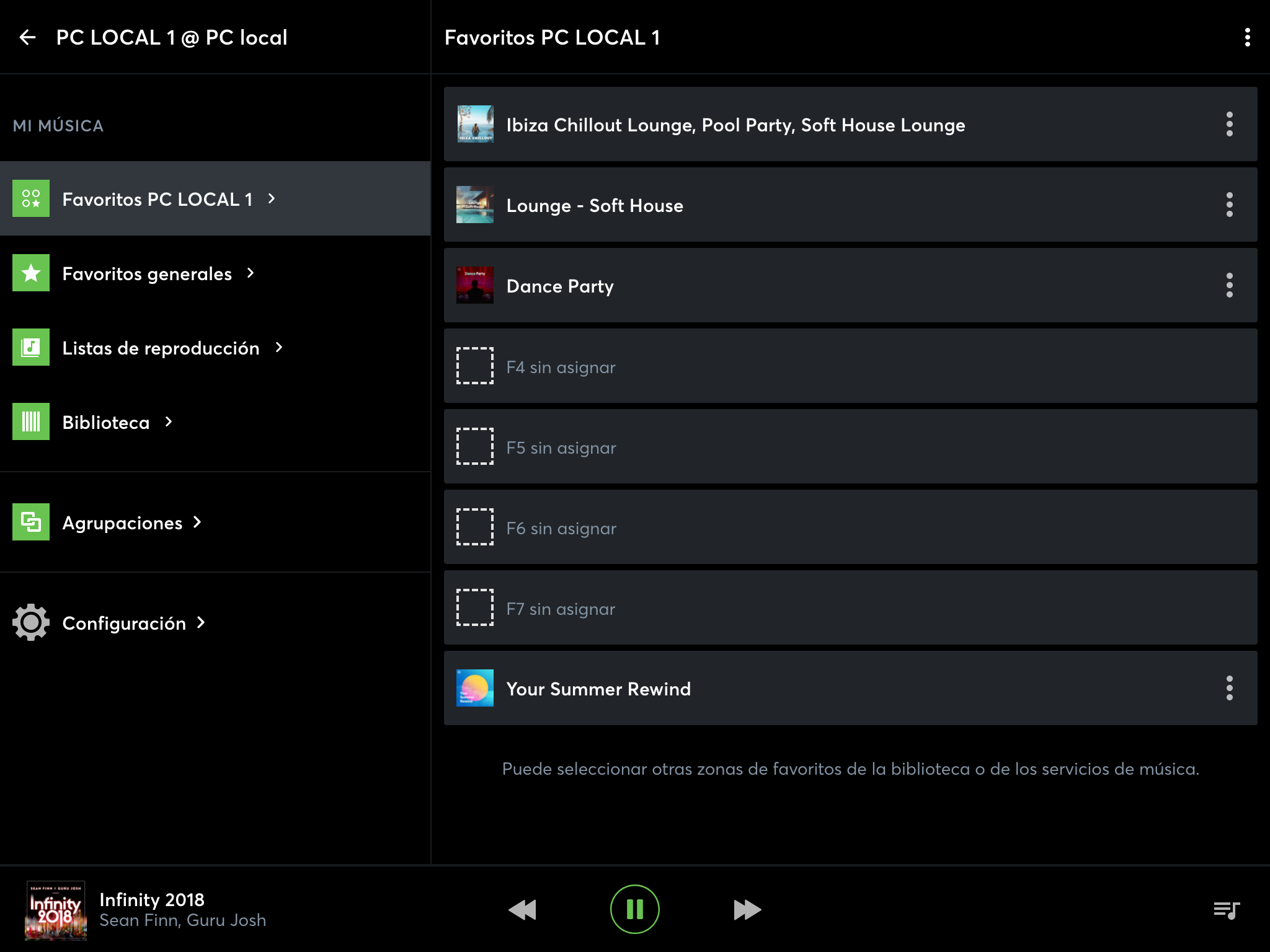

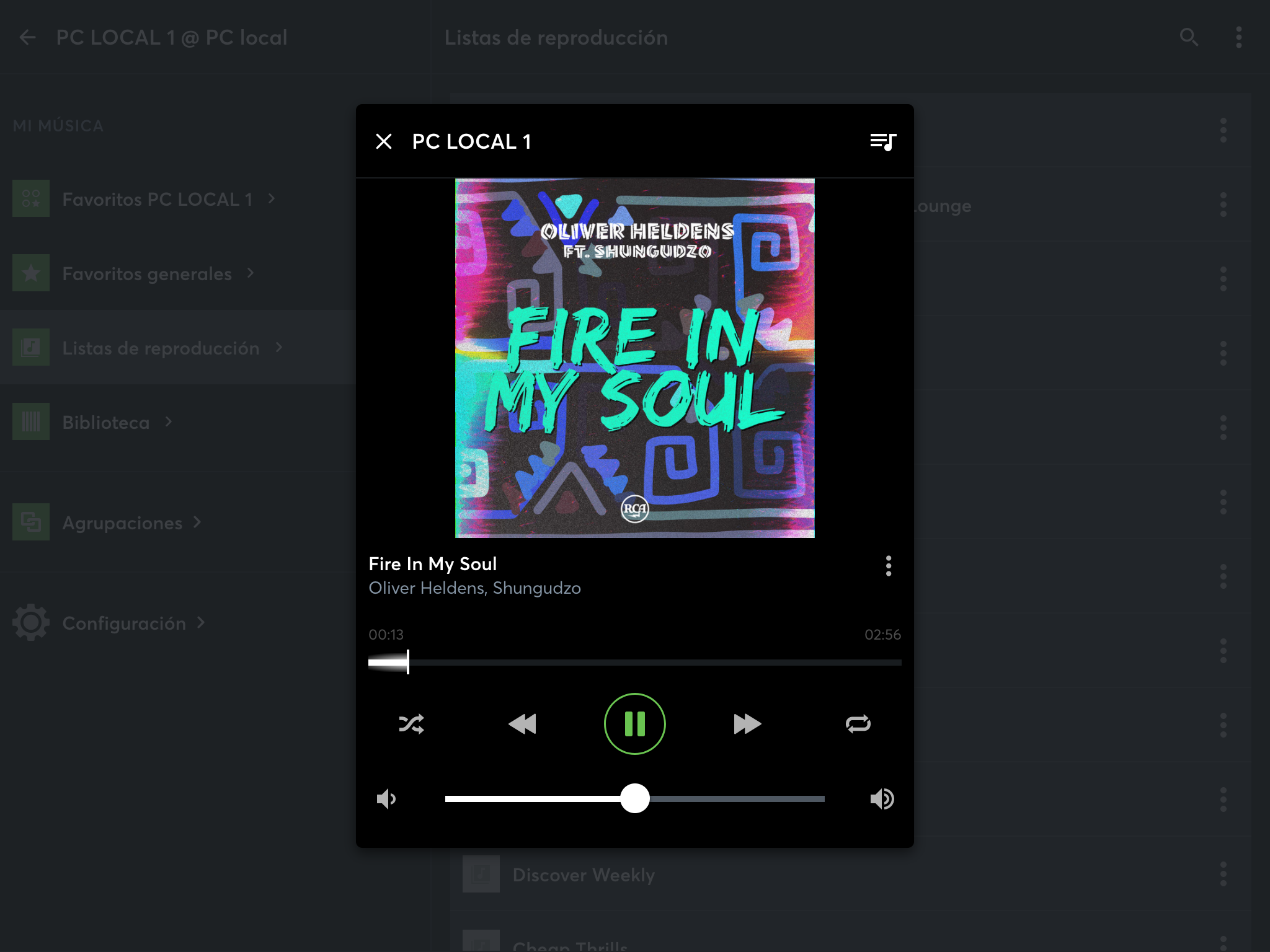

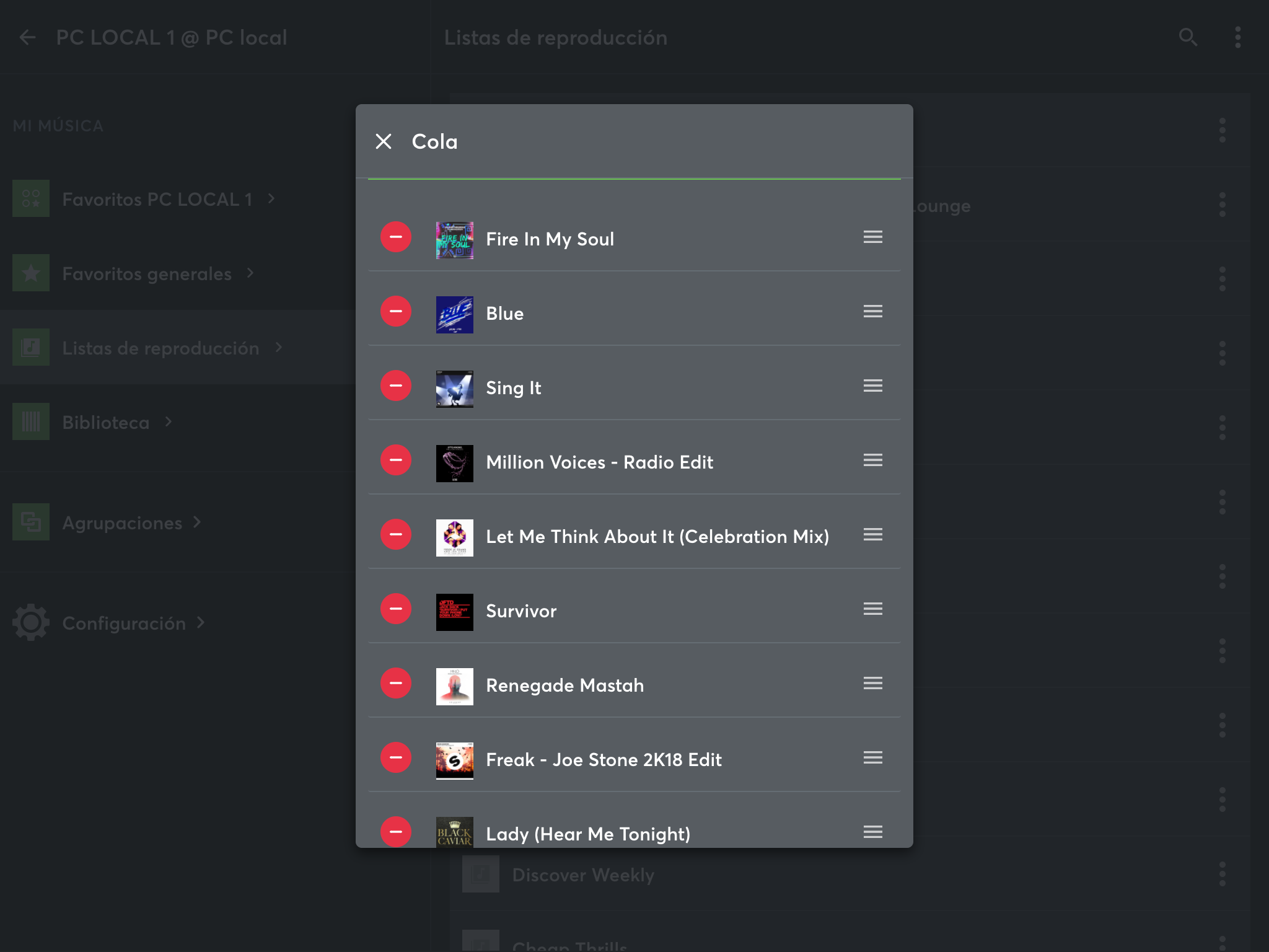

    And here some screenshots of the plugin working against a Spotify backend. I will release it at some point too, once everything is stable, at the moment I'm having issues with the player (librespot) i'm using underneath. Data is consumed through the Spotify API.

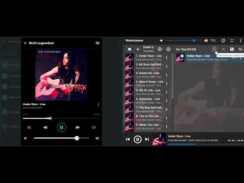

      ...and for the others: See the status of the MSG implementation of LoxBerry Squeezelite Plugin here:
      (Left side: LoxConfig WebUI Right side: LMS WebUI)
      Synchronisation is still not smoothly because currently MSG plugin only pull for new states, but we cannot push at the moment. Nevertheless, it's already pretty cool :-).
      Zuletzt geändert von Prof.Mobilux; 12.05.2020, 20:08.

        Lee MSI is a more "Loxone" approach: basic commands, with UDP virtual inputs/outputs, but very limited in what it can do. MSG on the flip side is a full fledged gateway for all actions in the Music Server UI. MSG is the evolution of MSI, after a bunch of bloggers asked for a deeper integration between their players and the UI. As a result, MSI will also be made dependant on MSG, because it's easier to use the gateway, but will not disappear.

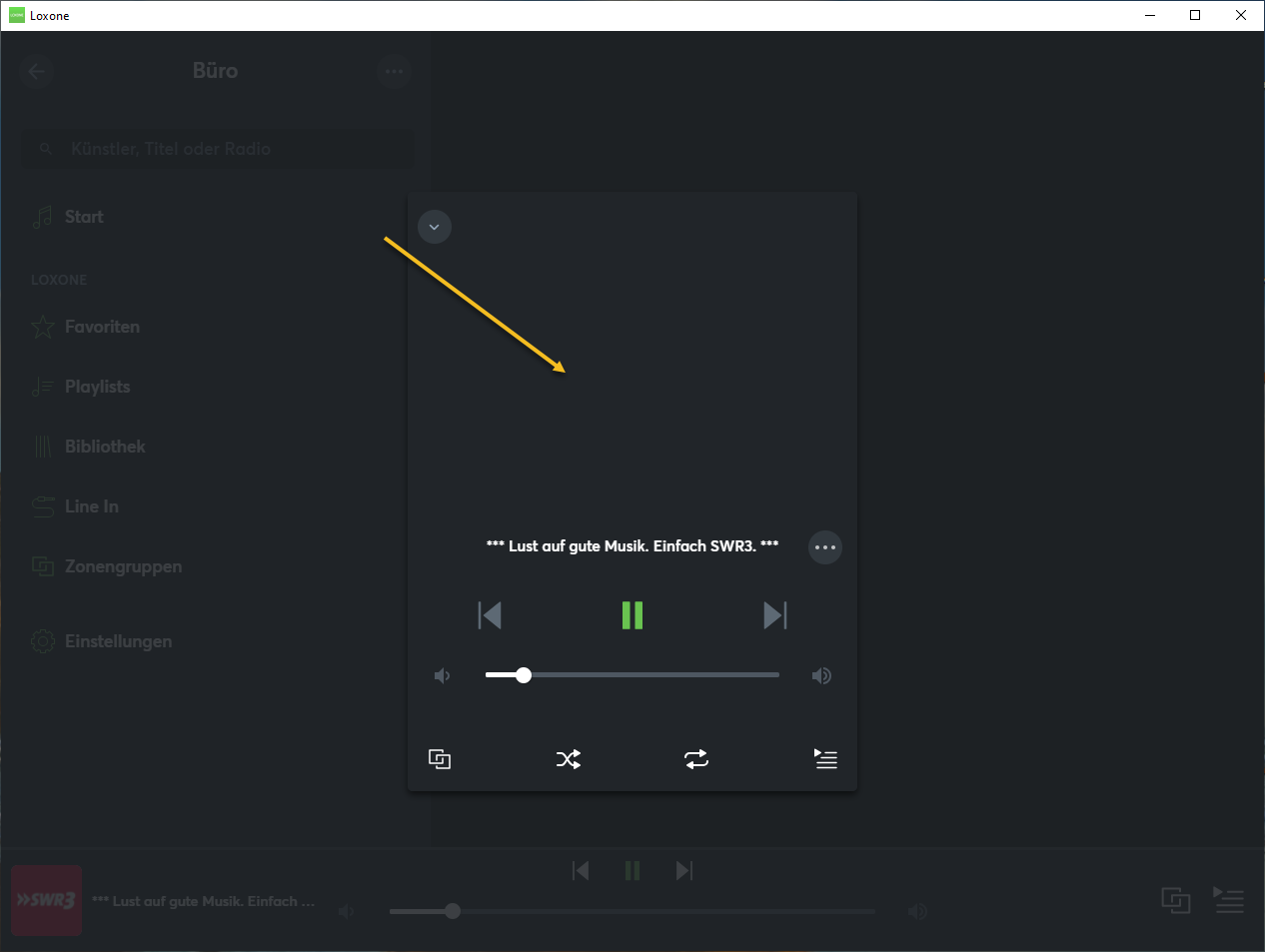

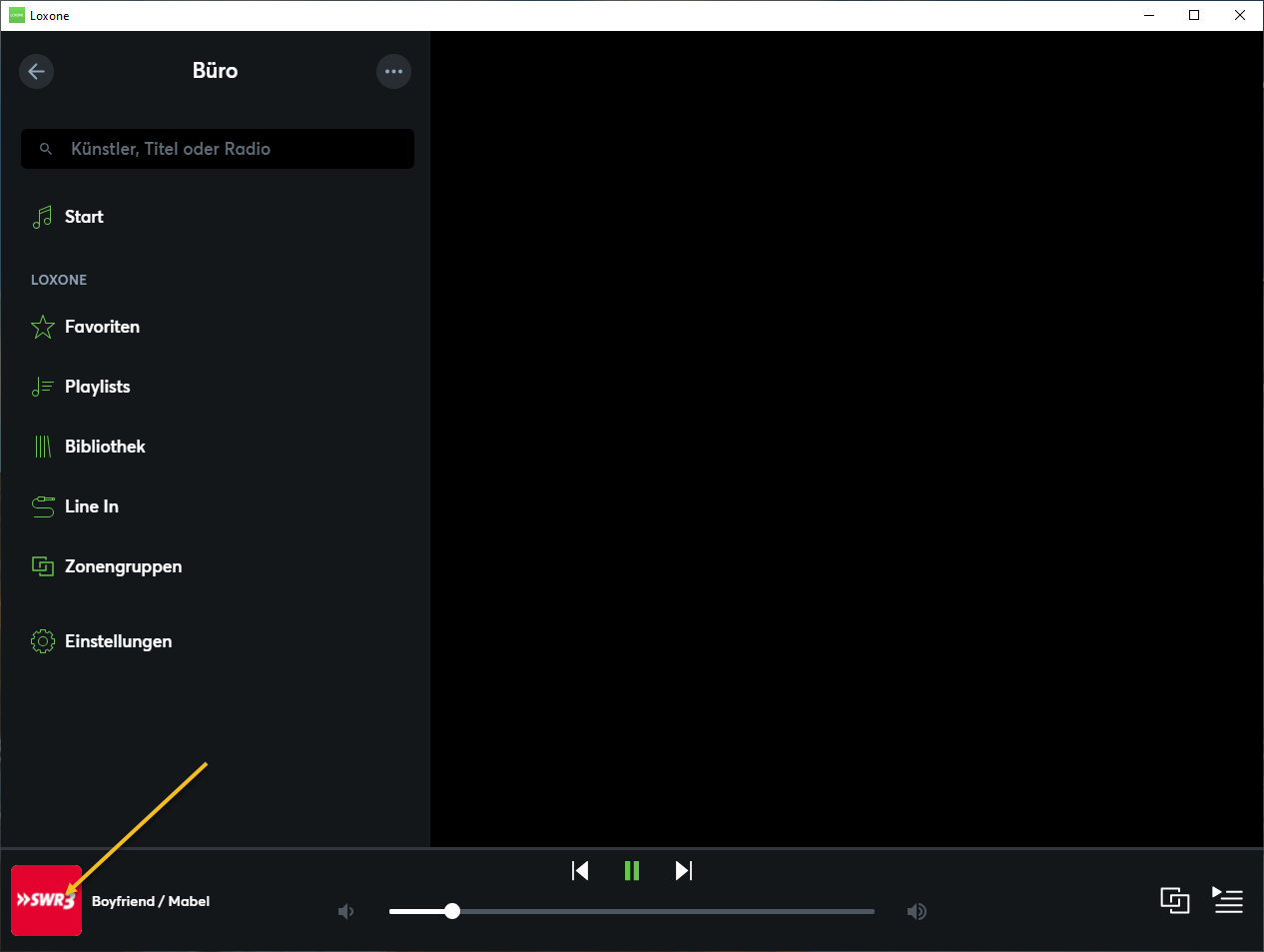

        Gast
        I do also some testing this night. Thanks to madito
        Beside volume etc I found another thing to look at.
        Version 11 App don`t show the Cover in big if you go to the player
Ansichten: 979
Größe: 49,8 KB
ID: 249504Klicke auf die Grafik für eine vergrößerte Ansicht
Ansichten: 971
Größe: 53,8 KB
          Noted in the post! I will try reproducing this one using the latest version. In web works well but I assume those are different versions (I don't actually recognize the styling of the player).

        hismastersvoice I saw the same, but wasn't that a bug in App V11? I think I read something about blank (white) covers in App V11...
          There was so much bugs in V11, can´t remember all of them
          Will have a look if I find the post.
          Just updated the app. Still no cover.... So could be an issue with MSG. Maybe we have to set the artworkspec?
        • 5124
