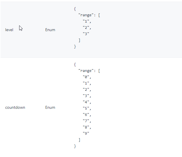

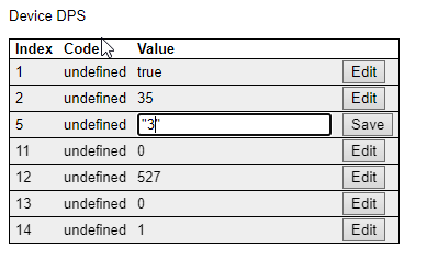

    Kleiner Tipp für alle, die gewisse Werte bei Tuya nicht setzten können.
    Wenn das Attribute als "Enum" definiert ist, wie zum Beispiel hier:
Ansichten: 385
Größe: 9,8 KB
    Dann muss der gewünschte Wert in TinyTuya auch mit den Hochkomma (") eingegeben werden:
Ansichten: 322
Größe: 13,9 KB
    Die Zahl 3 selbst wird nicht akzeptiert :-)

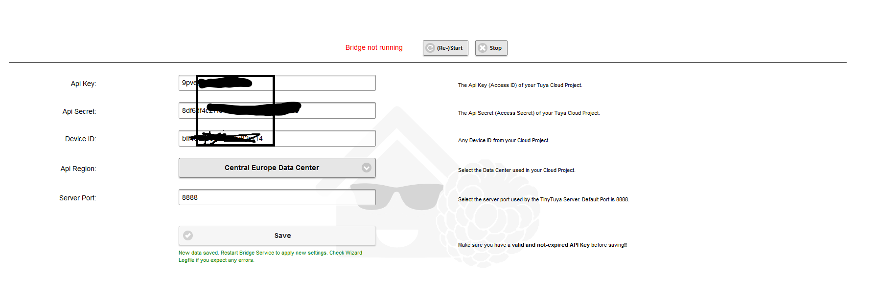

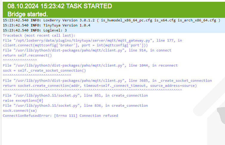

      Hi, I've installed the loxberry and tinytuya plugin and it seems to work pretty well.
      There's just one issue I'm facing - when the loxberry reboots, the bridge in TinyTuya doesn't start automatically. I have to go to the loxberry webUI and start it manually. Is there an upgrade safe way to turn the bridge on after reboot?
      I've tried searching through forums but couldn't find an answer
      I would very much appreciate any help

        Have you checked the logs if there's any Logfile before you start manually?

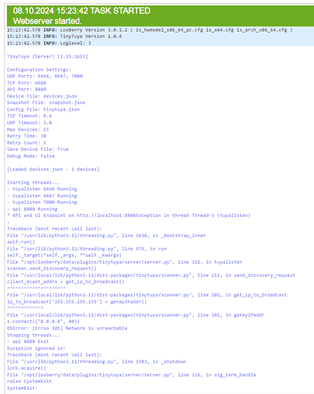

          #139
          Yes, there is a log entry in the bridge showing some error
Ansichten: 294
Größe: 76,0 KB
          There's also an error in the webserver:
Ansichten: 289
Größe: 129,2 KB
          Everything works when I start it manually though, do you have some ideas what could be wrong?​

            #140
            I've tried several times now and got a better understanding what's happening.
            When I reboot and I was logged in to the loxberry/tinytuya, the bridge starts running after a while - probably */5**** in cron. Important note is that loxberry doesn't require me to fill in the security pin when I open the tinytuya extension after reboot.
            When I wasn't logged in, the bridge starts, but crashes on the next cron run - with the error message above.
            To make it work, I have to login to the loxberry, open plugin, fill in the security pin and then the bridge turns on via the 5min cron automatically.
              • 5063
              #141
              Network is not reachable during boot time. Don’t know why. When you log in, we do anything regarding network. Maybe the network is up after the 5 minutes delay when the cron job jumps in. But it cannot have something to do wether you are logged in or not.
              You have to fix the network.

                I've tried to reinstall the whole loxberry along with TinyTuya and it's working as inteded now. The bridge now starts automatically after boot.
                No idea what was wrong, but it's working now.

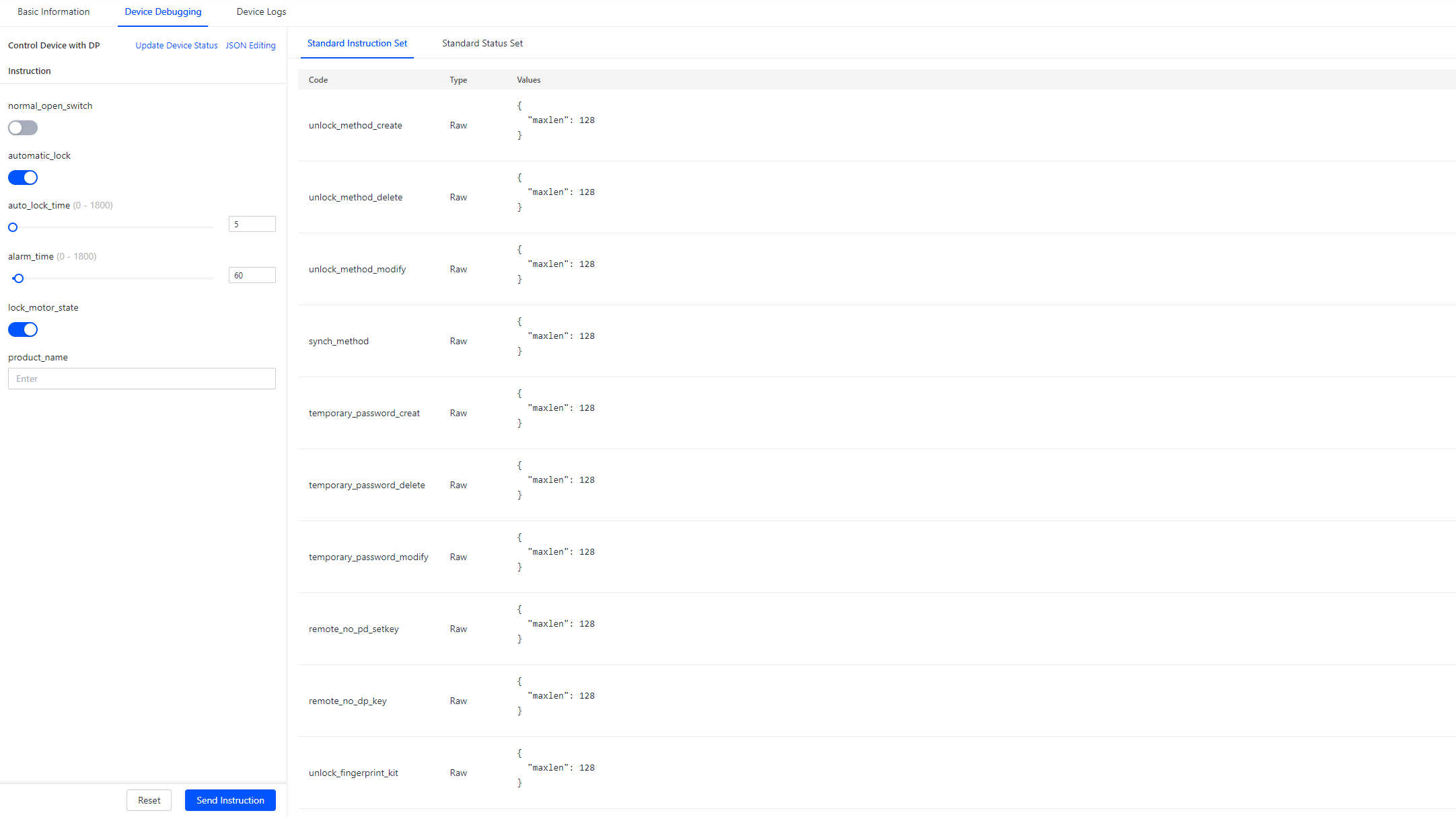

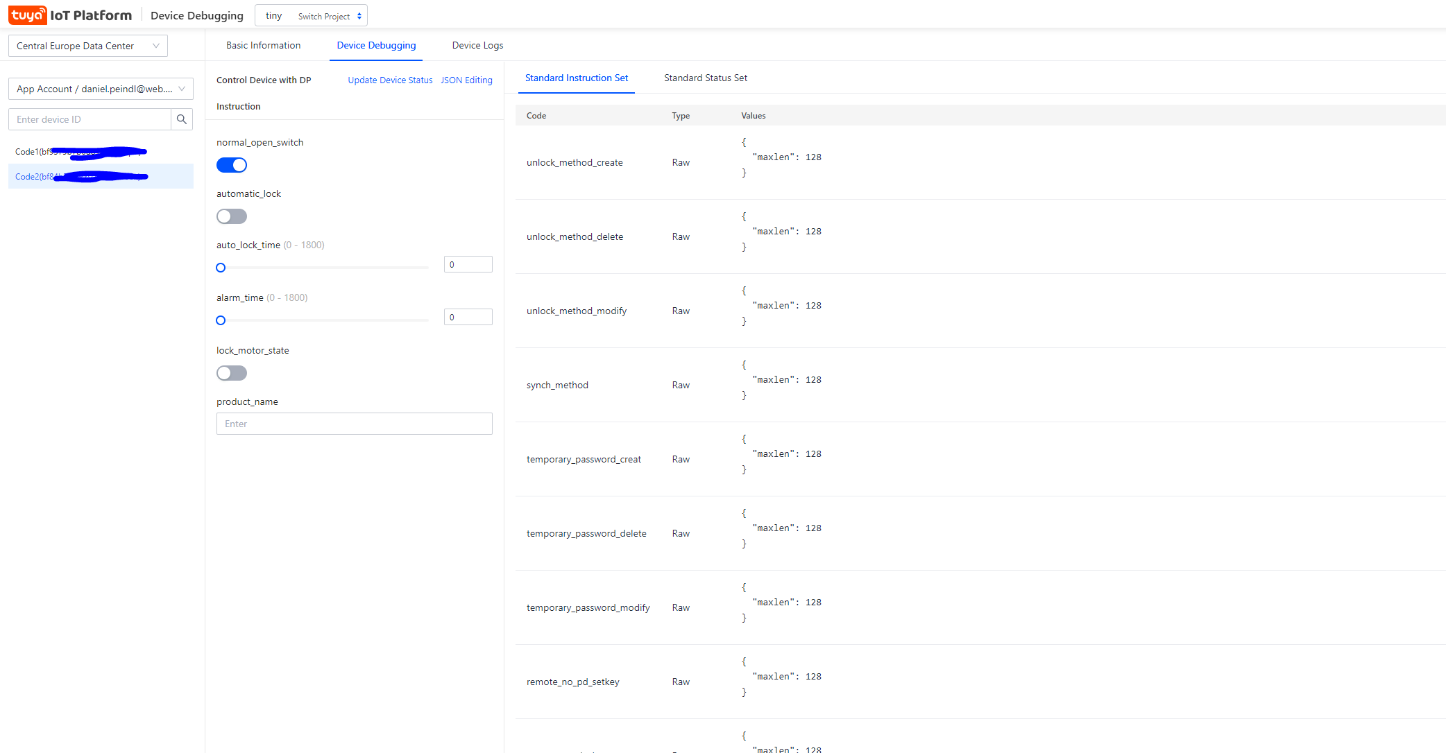

                  ich benötige Unterstützung bei der Verwendung von TinyTuya für zwei Codeschlösser. Vor etwa zwei Tagen habe ich TinyTuya installiert und möchte die Schlösser über Loxone steuern. Zusätzlich möchte ich den Status der Schlösser (offen/geschlossen) abfragen.
                  Nachdem ich die Datenpunkte (DP) umgestellt habe, habe ich über 24 Stunden gewartet, aber leider noch immer keine zusätzlichen Datenpunkte in TinyTuya gesehen. Ich habe TinyTuya auch bereits neu installiert, doch das Problem bleibt bestehen. Auf der Tuya Developer Plattform sehe ich jedoch mehr Datenpunkte.
                  Ich habe manuell herausgefunden, dass zum Beispiel im Log von Tuya der Eintrag „remote unlock“ erscheint, wenn ich das Codeschloss über mein Handy entsperre. In der Entwicklerkonsole konnte ich dann feststellen, dass dieser Vorgang den DP „9“ betrifft.
                  Daraufhin habe ich versucht, den Befehl „publish tinytuya/bf93......./9 true“ oder „publish tinytuya/bf93......./9 1“ über einen virtuellen Ausgang zu senden, aber leider ohne Erfolg.
                  Meine Frage: Gibt es eine Möglichkeit, die Datenpunkte manuell über den TinyTuya API-Server hinzuzufügen? Hat jemand von euch ähnliche Erfahrungen gemacht oder einen Tipp, wie ich weiter vorgehen kann? Ich bin momentan etwas verzweifelt.
                  Ich hatte gehofft, dass es vielleicht an der Wartezeit von 24 Stunden liegt, aber auch nach dieser Zeit hat sich nichts verändert.
                  Danke im Voraus für eure Hilfe!
                  Edit: Log File hinzugefügt. (Es wurden ID's usw mit XXX ausgebessert.) Im Log ist der "Code1" derzeit Offline. Dies ist so korrekt da er aktuell demontiert ist.
                  Zuletzt geändert von PeindlIT; 19.10.2024, 19:04.

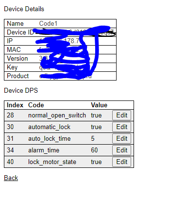

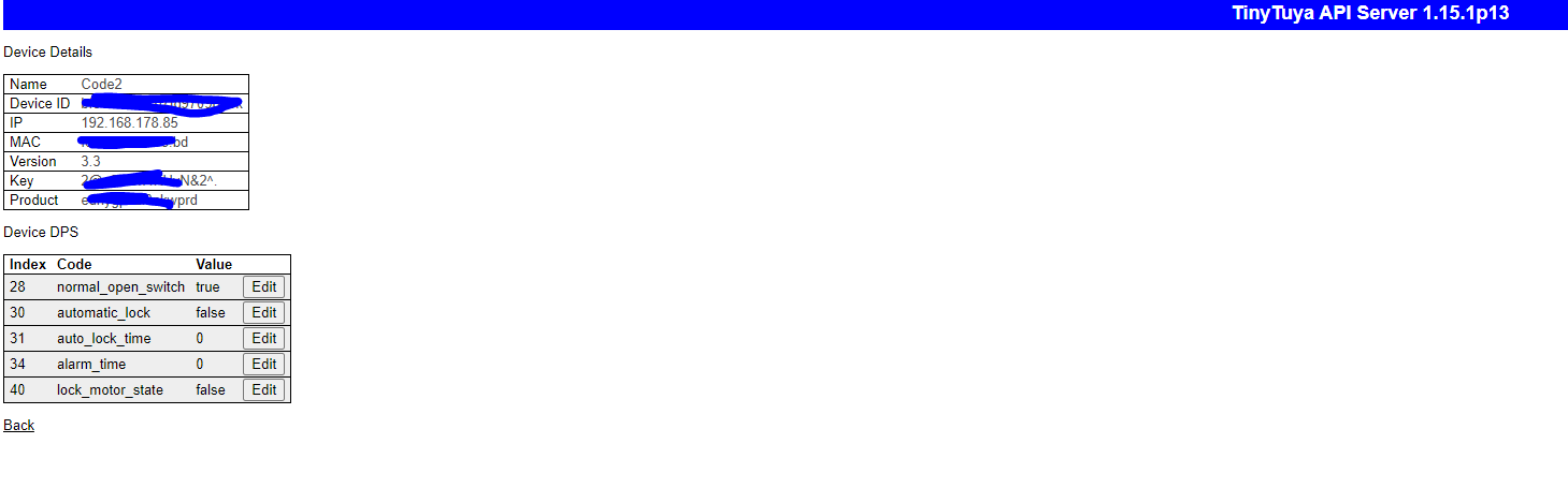

                  PeindlIT Zunächst einmal werden beide Geräte erkannt und auch gefunden mit all ihren DPs. Allerdings ist das eine Gerät (mit der IP .200) dann später bereits wieder Offline wie es aussieht:
                  [Code1 ] Error: No IP found
                  [Code2 ] 192.168.178.85 - DPS: {'28': True, '30': False, '31': 0, '34': 0, '40': False}
                  Sind das Batterie-betriebene Geräte? Zeigt der Webserver irgendetwas an (Screenshot)?

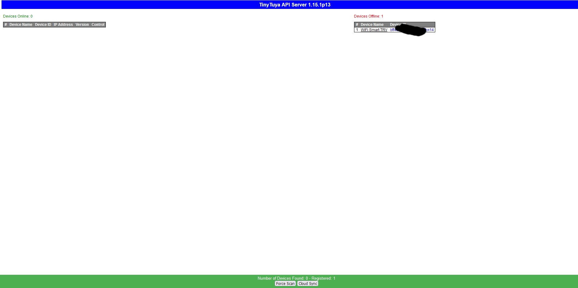

                    Ja wie geschrieben das Gerät mit der IP 200 war zum Zeitpunkt des Logs abgesteckt. Es handelt sich um Netzbetriebene geräte!
                    Einen Screenshot vom TinyTuya Server/Webinterface hab ich angehängt oder was genau meinen Sie?

                  Es müssen beide Geräte angeschaltet und online sein. Dann den Wizard ausführen und im Log schauen, ob beide Geräte gefunden werden. Dann den TinyTuya Webserver anschauen - dort müssen ebenfalls beide Geräte auftauchen.
                  • PeindlIT
                    • 19.08.2024
                    • 5

                    Wie gesagt das Problem ist nicht das die Geräte nicht auftauchen sondern die fehlenden DP. Hab dir nun den 2. Leser wieder angeschlossen und dir alle Log, Screenshots nochmal angehängt!
                    Wie gesagt zwischen jetzt und dem Umstellen der DP auf der Tuya Cloud sind nun ca min. 4 Tage vergangen.
                      • 5063
                      #148
                      Ah, ok, da hatte ich Dich falsch verstanden. Im Scanner erkennt er die ganzen DPs wenn ich das richtig sehe. Allerdings nur vorne beim Scan, weiter hinten sind es dann nur die paar DPs, die Du später auch im Webserver siehst. Warum - keine Ahnung.
                      Da müsstest Du einen Issue bei TinyTuya aufmachen: https://github.com/jasonacox/tinytuya/issues
                      Schick ihnen die Ausgabe vom Scanner mit (aus dem Log alles ab: "TinyTuya (Tuya device scanner) [1.15.1]" bis zum "Done") und den Screenshot vom Webserver.

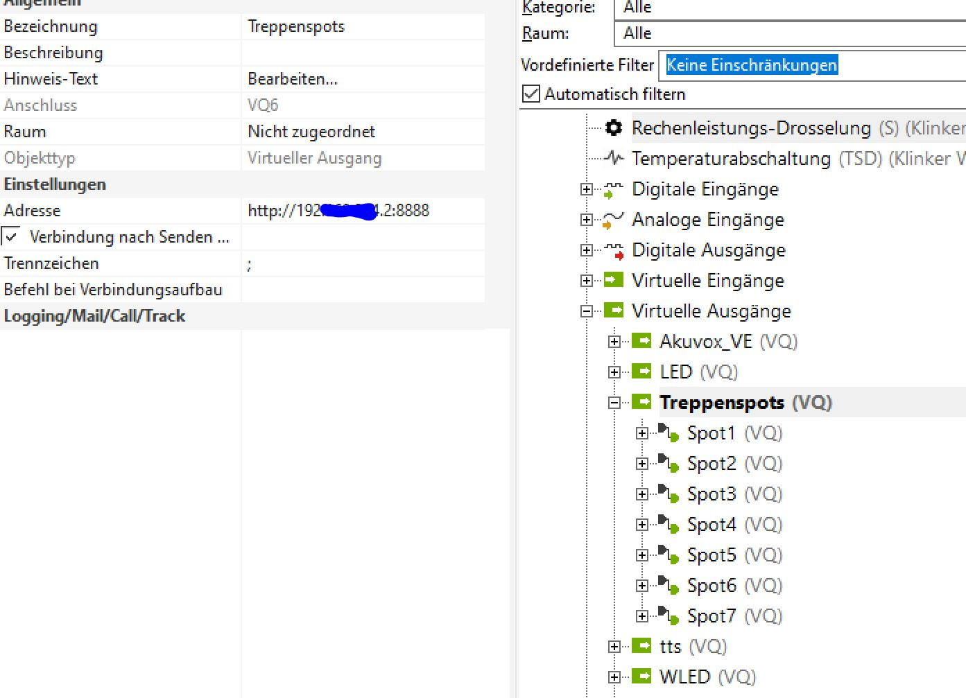

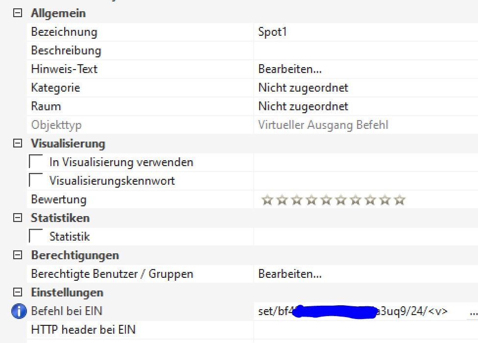

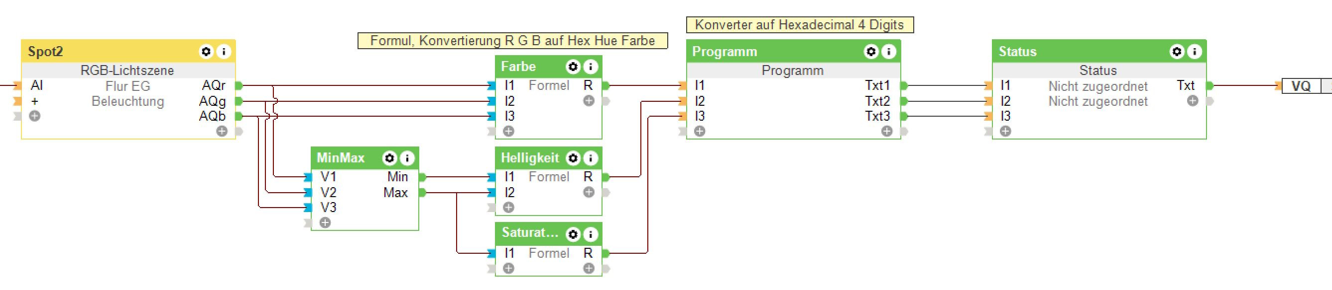

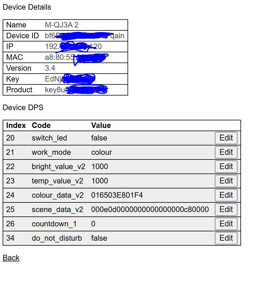

                      Hallo zusammen , ich versuche mal ein Tuya Led Spot zu integrieren , leider funktioniert nicht ganz wie ich vorstelle, manchmal reagiert der spots manchmal nicht!
                      meine Spots nutzen Hex Hue farben format und wird in Hexadecimal konvertiert , bitte schauen Sie mal die Screenshots
                      vielleicht kann mir jemad ein idee geben was mache ich hier falsch, vielleicht ein weg ohne das Program baustein nur über status baustein
                      besten Dank

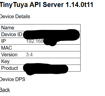

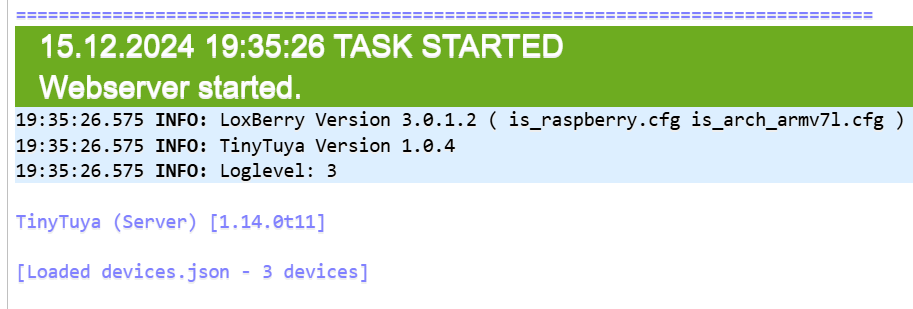

                        #150
                        Hallo!

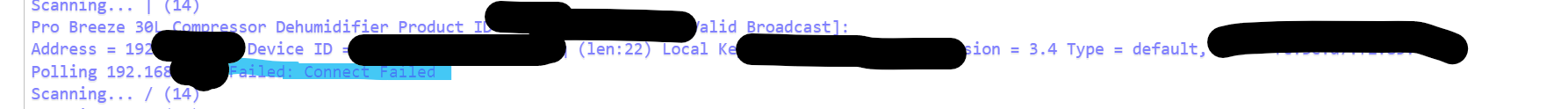

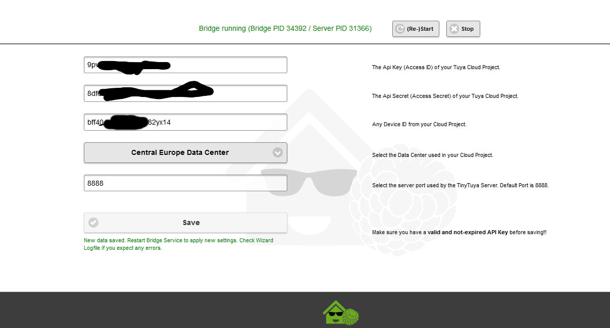

                        Ich würde gerne ein weiteres Gerät bei meinem TinyTuya hinzufügen.

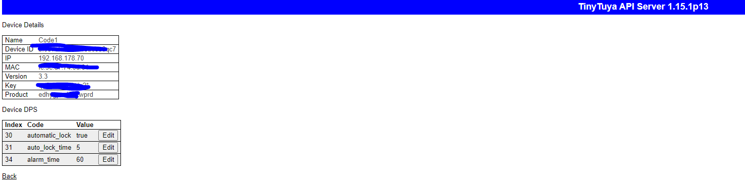

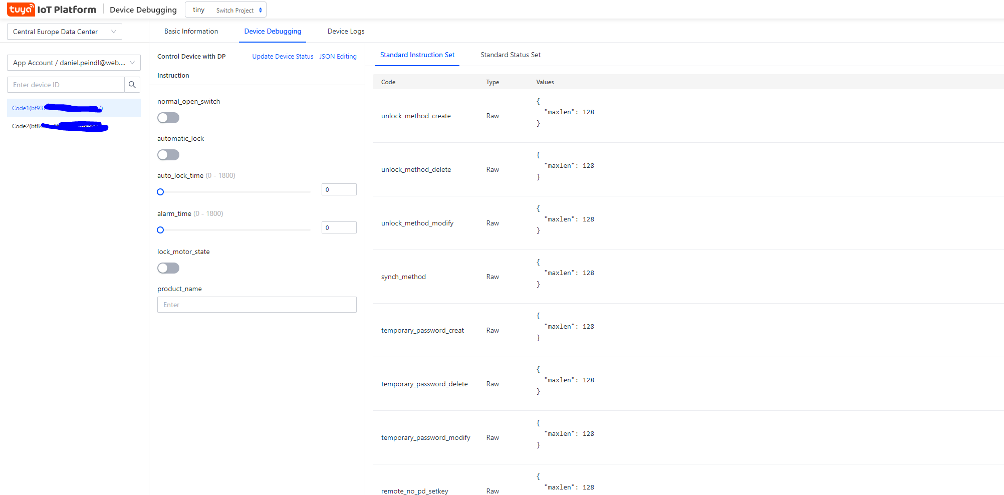

                        Im Tuya Developer habe das Gerät schon hinzugefügt und auf "controllable" gestellt!
                        Leider sehe ich dann nur das:
                        Klicke auf die Grafik für eine vergrößerte Ansicht  Name: image.png Ansichten: 0 Größe: 23,7 KB ID: 449411
                        Es handelt sich um einen Entfeuchter ProBreeze , denn ich auch über die APP schalten kann.
                        Das müsste dann auch hier gehen oder?
                        Aber warum werde mir keine Daten gezeigt?

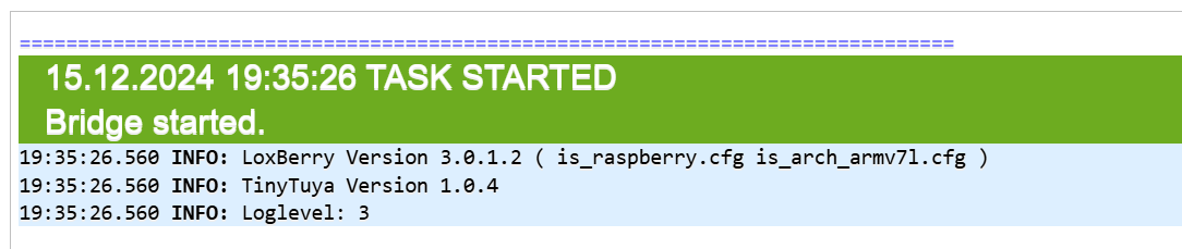

                        Das ganze läuft auf einem Raspberry mit LoxberryVersion V3.0.1.2; TT V1.0.4
                        Klicke auf die Grafik für eine vergrößerte Ansicht  Name: image.png Ansichten: 0 Größe: 67,8 KB ID: 449412
                        Klicke auf die Grafik für eine vergrößerte Ansicht  Name: image.png Ansichten: 0 Größe: 61,4 KB ID: 449413
                        Klicke auf die Grafik für eine vergrößerte Ansicht  Name: image.png Ansichten: 0 Größe: 49,8 KB ID: 449414

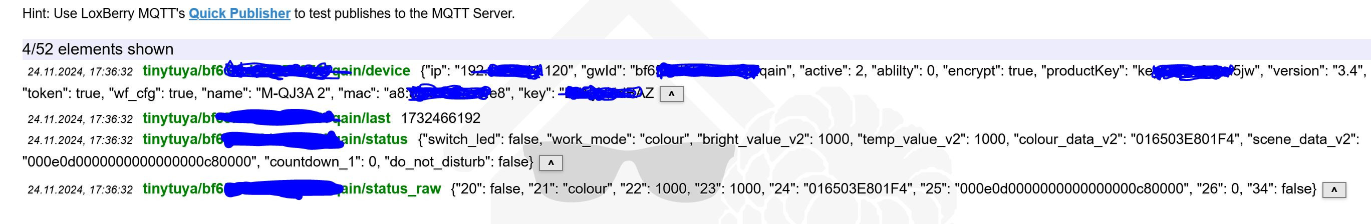

                        Ich denke es liegt am dem:
                        Klicke auf die Grafik für eine vergrößerte Ansicht  Name: image.png Ansichten: 0 Größe: 40,6 KB ID: 449424
                        Ich hoffe dass sich das Problem nach einem Tag "von alleine" löst.
                        Beste Grüße
                        EDIT: Zwischenzeitlich habe ich einmal die Daten ins MQTT bekommen. Leider nur 1x.
