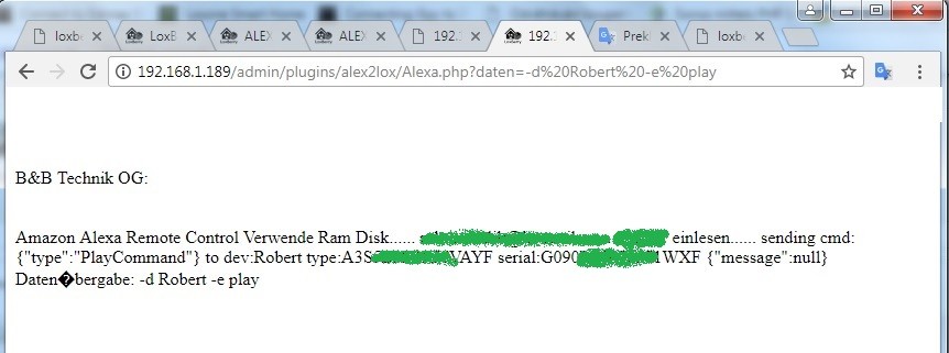

        Zitat von ager
        Hi. I am not able to download plugin. Can you help me please?
        Thanks a lot Peter! I have downloaded, instaled on my RPi3 loxberry and if I try to send comand play by browser (chrome) to play last station it is not working. What I am doing wrong please?
        https://usernameassword@loxberryIP/...a.php?daten=-d Robert -e play
        I am getting this reply:
        B&B Technik OG:
        {"message":null} Daten�bergabe: -d Robert -e play.
        Many thanks for help!
        • ager
          • 15.11.2017
          • 48
          #55

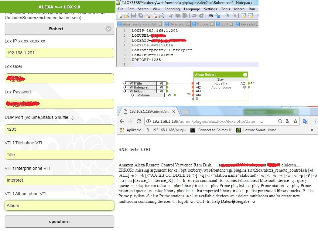

          Hi Guys. Sorry for english!
          I am still trying to alexa2lox plugin become working but still without success. I could see new update so I have unninstaled old version and installed new version alexalox2.0.5 (you can see logfile in attachment) and I have tried to send play or pause command as you can see in attached picture but nothing happens.
          Could you please be so kind and help me?
          • Peter B
            Peter B kommentierte
            This is all possible it musst be playing the radio station there are no error When i put this in the Browser, the Radio plays the stationID:s284873"
            i have now testet on echo and echo dot
            the udp Data comes to the miniserver?
          • ager
            ager kommentierte
            A so I didnt tried UDP data becasue I have stoped on this issue. So do you have any idea what can I do please?
          • Peter B
            Hmmmm no Idea at the Moment
            have you input the MS IP/Port VTI usw?
        • ager
          • 15.11.2017
          • 48
          #56
          Hi Peter, I have done new post because I cant add picture into comments.
          Yes, I have input all data into MS. You can see in picture. I have created virtual text inputs also but there is no data. What is usw?

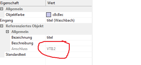

          • Peter B
            • 29.08.2015
            • 540
            #57
            Can you give in the Number of the VTI an not the Name and in the Broser Adress there must be the Name of the Alexa like Alexa.php?daten=-z Robert There is a "ERROR:missing argument for -z" and the Volume Input is not a VI, it is a UDP Input. In the UDP Monitor is any Data from Alexa?
