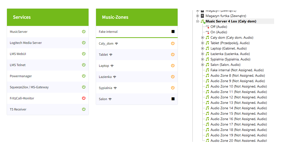

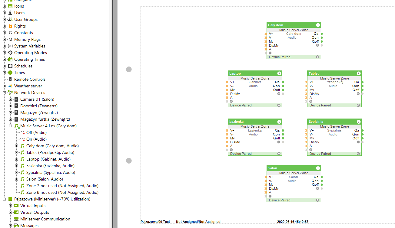

    1st test:
    installed over 0.74 with 2 x 8ch sound cards on debian 10.3
    firstly a massive thankyou - the interface is so much more intuitive and simple
    the zone cards and internal zones disappeared, but squeezebox and all its settings were ok
    i created the new internal zones, rebooted and all 9 internal zones are back up playing my music and streaming
    i changed the ip address using the new interface and it worked perfectly whereas previously i had to use telnet to set network settings
    i rebooted a couple of times and all zones restarted correctly, something that 0.74 never did for me
    next tests are to add external zones, test t5 and tts and finally the musicserver emulation in loxone
    once again, many thanks

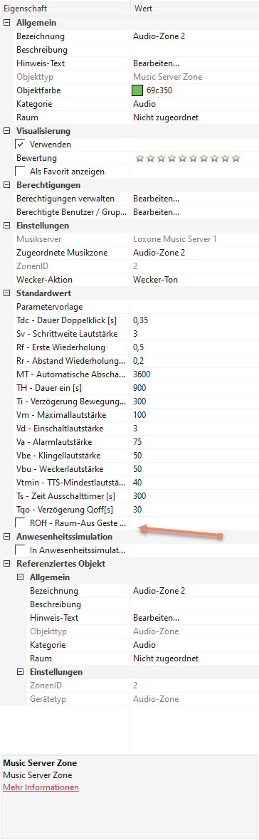

          Bei mir funktioniert nun nach dem Update die Kommunikation zw. MS4L und dem Miniserver.
          Mir ist bei den ersten Tests aufgefallen, dass ein Doppelklick auf T5/3 (mittlere Taste) nicht nur das Licht ausschaltet, sondern auch die Audiozone. Hab das in mehreren Räumen getestet und reproduziert. Ist das so gewollt?
            • 7663
            Ja ist so gewollt... von Loxone nicht von mir
            Kannst du aber im Baustein abschalten...
            Klicke auf die Grafik für eine vergrößerte Ansicht  Name: 16-06-_2020_07-45-32.png Ansichten: 0 Größe: 47,3 KB ID: 254351
            Ich habe die Funktion an, wenn ich den Raum verlasse will ich zumindest alles aus.

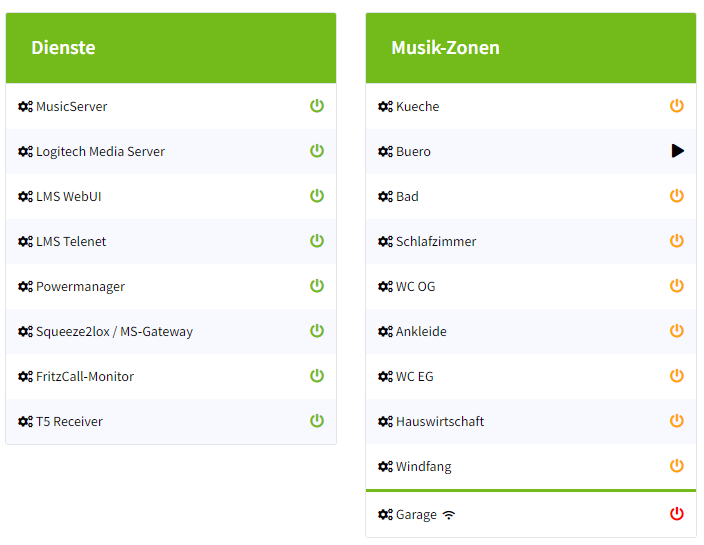

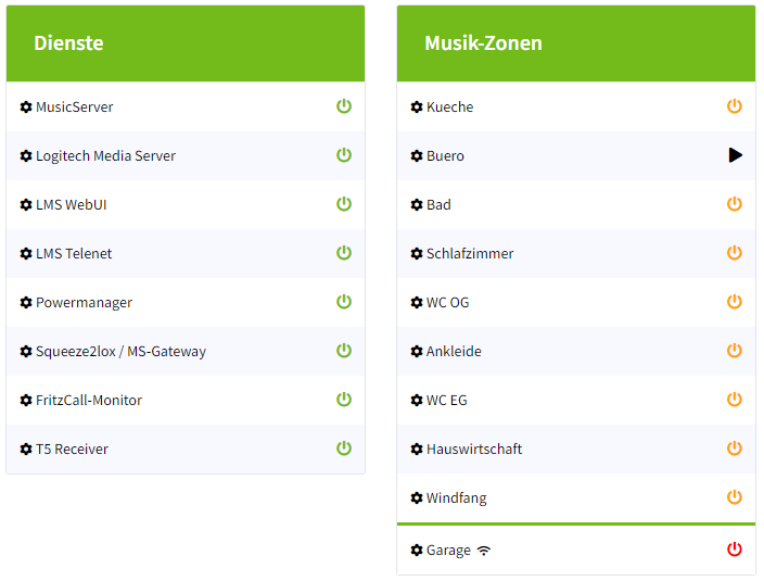

            Two general notes:
            - I see no option to stop / start / restart services from UI like it was in 0.x.y, is there any?
            - I would consider changing UI font. That one used now has problems displaying diacritic fonts. I see umlauts are OK, but most of Polish special chars are larger than regulars fonts. I see the same is in Czech version so I believe other version will also suffer from this problem
              Yes, look to the dashboard and move mouse over Service or Zone you like to control and klick
              https://music-server.net/help_v1/Nav...Dashboard.html
              I have seen this issue with the font, put it on the list.
            • TomekWaw
              TomekWaw kommentierte
              Ok, I see now. But this is pretty hidden and clearly requires reading manual. Perhaps some additional icon somewhere there like a little cog or hamburger icon?
              Zuletzt geändert von TomekWaw; 16.06.2020, 07:28.

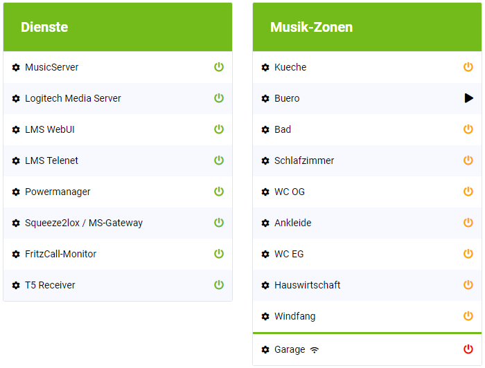

            • 7663
            TomekWaw
            Better to understand?
            Klicke auf die Grafik für eine vergrößerte Ansicht  Name: 16-06-_2020_09-12-27.png Ansichten: 0 Größe: 39,4 KB ID: 254363
            or
Ansichten: 2087
Größe: 37,8 KB
            Zuletzt geändert von hismastersvoice; 16.06.2020, 08:17.
            • TomekWaw
              Yeah, looks much better. I would choose version 2 and made just a litte bit more padding between the cog and Service name / Zone name
            • 7663
            Changed the font to Roboto
            The chapters hast than the same height. Also the font is clearer to read.
            Klicke auf die Grafik für eine vergrößerte Ansicht  Name: 16-06-_2020_09-35-43.png Ansichten: 0 Größe: 1,3 KB ID: 254368Klicke auf die Grafik für eine vergrößerte Ansicht  Name: 16-06-_2020_09-35-59.png Ansichten: 0 Größe: 1,4 KB ID: 254367
            Klicke auf die Grafik für eine vergrößerte Ansicht  Name: 16-06-_2020_09-35-20.png Ansichten: 0 Größe: 6,6 KB ID: 254369Klicke auf die Grafik für eine vergrößerte Ansicht  Name: 16-06-_2020_09-34-56.png Ansichten: 0 Größe: 6,7 KB ID: 254370
Ansichten: 2102
Größe: 38,1 KB
            • TomekWaw
              Look great! Roboto (used in Android UI also) is a very good choice

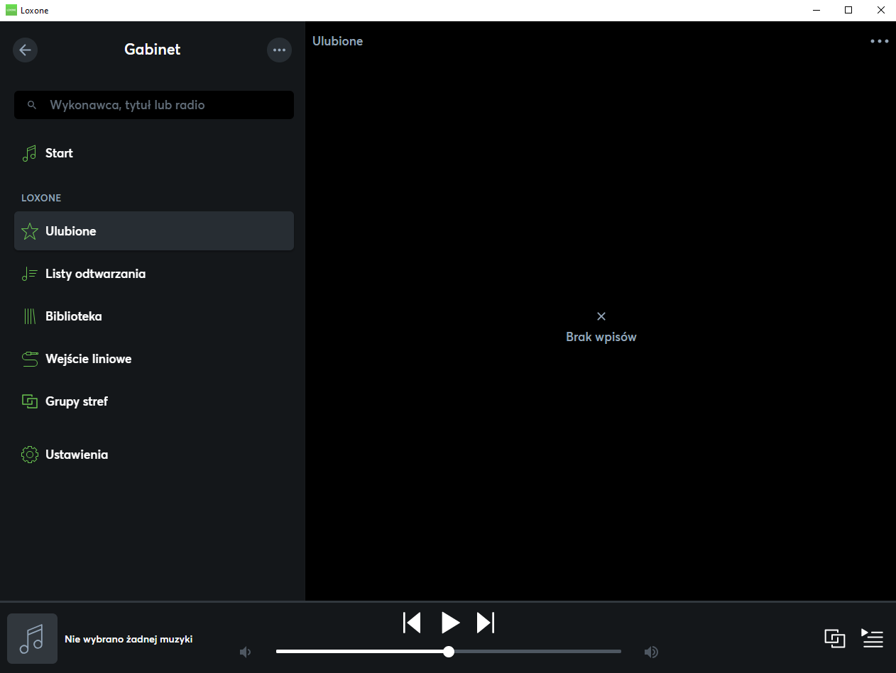

                Not sure if I have something broken in my setup or doing sth wrong but:

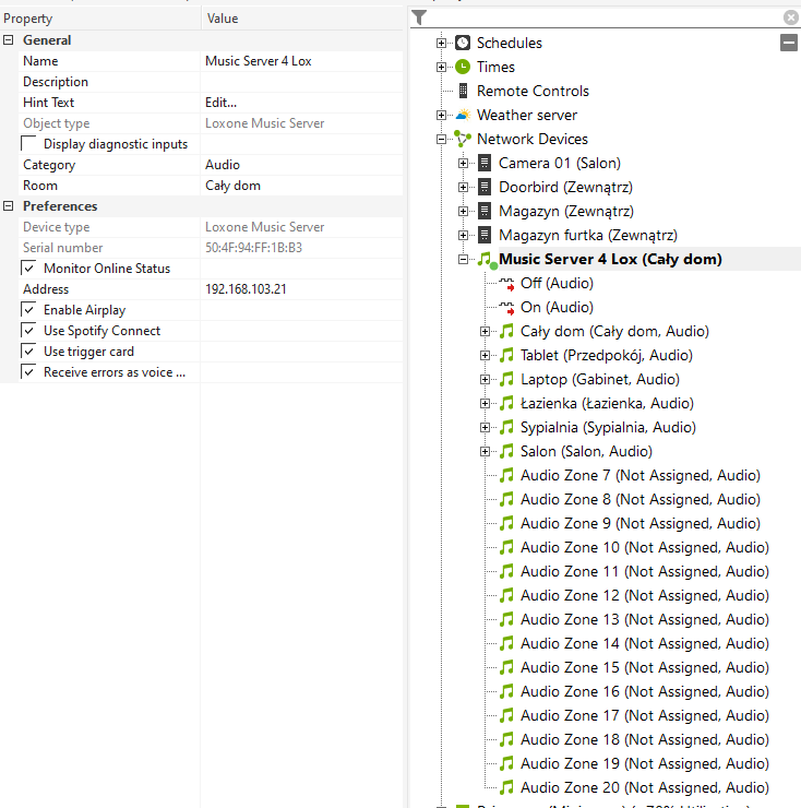

                - I've successfully added MS4Lox as 8-zone Music Server to Loxone
                - created blocks for audio zones on Test page, saved program do Miniserver
                - but now in Loxone App I can't really do anything:
                - Favorite list is empty (but I have items in LMS Favorites)
                - Playlists list is empty and I can't create one (looks like it just wasn't saved)
                - Library is empty (LMS corretly sees contents of /home/music/music_files folder)

                  • TomekWaw
                    I have change to 20-zone, but no change. How do I check that MSG is running correctly?

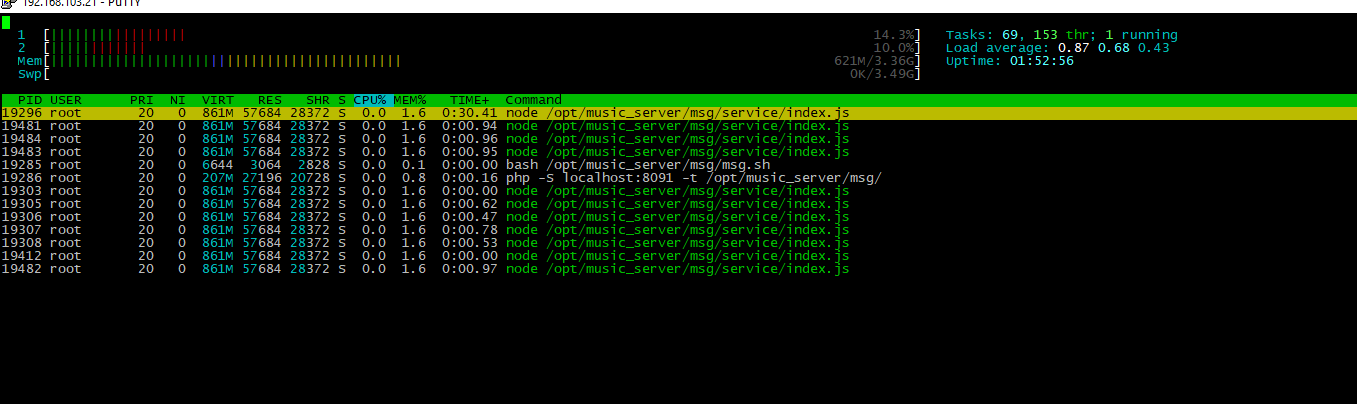

                    htop
                    F4
                    msg
                    Post a screenshot
                • TomekWaw
                  • 25.07.2019
                  • 450
                  htop screenshot (and current Config)
                  Zuletzt geändert von TomekWaw; 16.06.2020, 15:11.
                    Runs...
                    So please create a internal fake zone.
                    All test are done with at least one internal zone.

                  Done. Rebooted. No change :| I still can't create playlist, don't see Favorites & local media, entering some parts of Settings hangs up the app.
                    Not sure if you follow the MSG Thread...
                    You can´t creat Playlist, use Spotify etc direct in the App.
                    Fav (created in LMS-UI), Roomfav, Playlist (created in LMS-UI) works. Also EQ,Volume, play/pause/stop, and the Music-Zone-Block works.
                    Nothing else! No Spotify, no Librarys.
