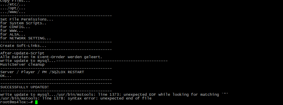

    I've done this update to 1.0.2beta, but during it I saw:
    Unzip Files
    unzip: cannot find or open /tmp/update_1.0.2beta.zip, /tmp/update_1.0.2beta.zip.zip or /tmp/update_1.0.2beta.zip.ZIP.
    UI shows I have 1.0.2beta, but I believe I don't as PM still doesn't work

      #49
      I confirm PM works fine now!
      But another issue showed up during the update:
Ansichten: 444
Größe: 28,6 KB
      • inswe
        inswe kommentierte
        Kann ich bestätigen.
        Thats a know issue of the mstools.
        mstools will get a cpl. new version in the near future.
        The issue has no effect to the update or any function

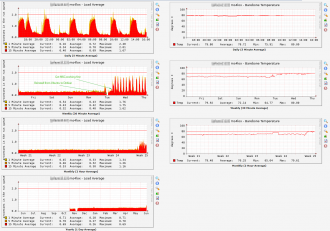

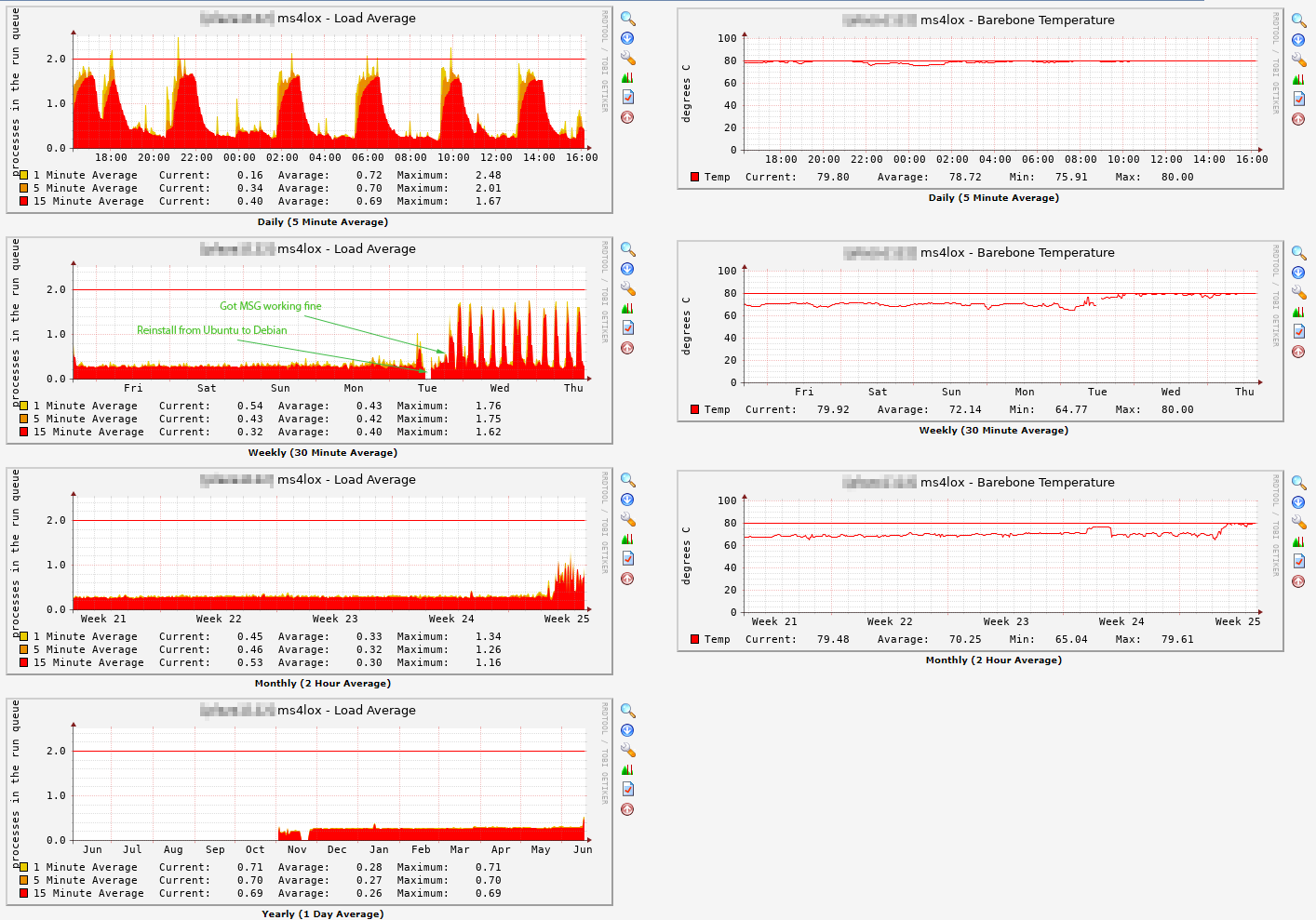

                BTW, what might cause those peaks in Load Avarage in regular intervals?
                I noticed it since moving to Debian / getting MSG working - not sure if this is a Debian or MSG result
                Nothing much to worry, but worth to note that either Debian or MS4Lox v1 generally made my Foxconn nT-A3700 box work at ~8-10 degrees higher temp than before (my Cacti noticed jump from ~70 to ~80)
                Click image for larger version  Name:	Cacti.png Views:	0 Size:	217.4 KB ID:	254919
                Zuletzt geändert von TomekWaw; 18.06.2020, 15:31.
                  Yes it is a higher load with MSG
                  Reason is that at the moment the MSG works not Event based, ever 5 sec there is a lot of data transfer between MSG and LMS.
                  In the future MSG will be more Event based and act only if needed.
                  In Post #35 you show that you set a extrem long time for power off of the Zones, that is also an power-eater if unused Zones ar not power off.

                  Thanks. I've already change PM to 10 sec (see #39) and I'm only using it for one zone just for tests.
                  I'll probably turn off PM at all and use Audio Zone blocks Qon an Qff as it's simplier.
                  Not sure if I understand it correctly, but if I dont use PM for external zones, there are always in "standby" mode.
                  Is it ok? Does it eat more power / cpu temperature comparing to a zone "powered off" (not talking about amp here as I dont have one of course)
