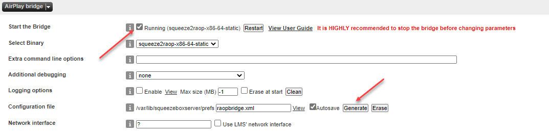

              • 7710
              Zitat von Iluminatus23
              Unfortunatly no devices appear.... I want to pair some Play1 und Play5... :/
              Screenshot of the Settings...
              Is the Service running?
              Is Settings-File generated?
Ansichten: 486
Größe: 65,9 KB
              Than the Sonos-Player should be shown.
Ansichten: 394
Größe: 14,2 KB
              • Iluminatus23
                • 07.08.2016
                • 256
                mea culpa. The original Play1 and Play5 doesn*t support Airplay. Thats the cause, isn*t it?
                  • 7710
                  Than use UPnP-Bridge to use the Player as external Zone.
