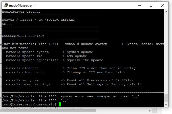

        i got an installation error but things still seem to work Klicke auf die Grafik für eine vergrößerte Ansicht
Ansichten: 1458
Größe: 82,7 KB
          Happens because of overhangs... But this is only from console and not from WebUI.
          It work even if you get this message.

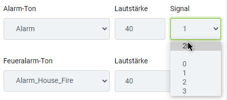

            I think you meant to ask if signals 1,2,3 can also be implemented in the TTS/alarm/announcement standards.
            Right?
            Something like that...
Ansichten: 1191
Größe: 22,1 KB
            Zuletzt geändert von hismastersvoice; 29.12.2020, 17:20.
            • simekp02
              simekp02 kommentierte
              Yes You are right..
              I mean thats signals and implementation in TTS/alarm/announcement standards.
              Could be??
            • hme0354
              hme0354 kommentierte
              what signals are that?
              @hme354 signal=1(2,3) Es werden vom den Event ein kurzer Signalsound abgespielt. So das man zB direkt hört das ein Event anfängt.
              @simekp02
              Makes only sense for the TTS, Alarm etc are Sounds that don`t need a signal before they are played.
              Will implement it for next update.

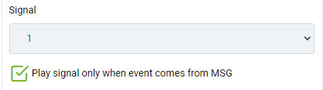

            • 7664
            simekp02
Ansichten: 1181
Größe: 13,0 KB
            If added this option to TTS.
            So you can set a signal for MSG and URL Events, or only if the Event comes from the MSG.
            All options are open than how to use it.
            I also implemented it to the set.php, so you can also change the value from the MiniServer with a logic
            Will add it also to the manual than before the update comes.
            OK for you?
