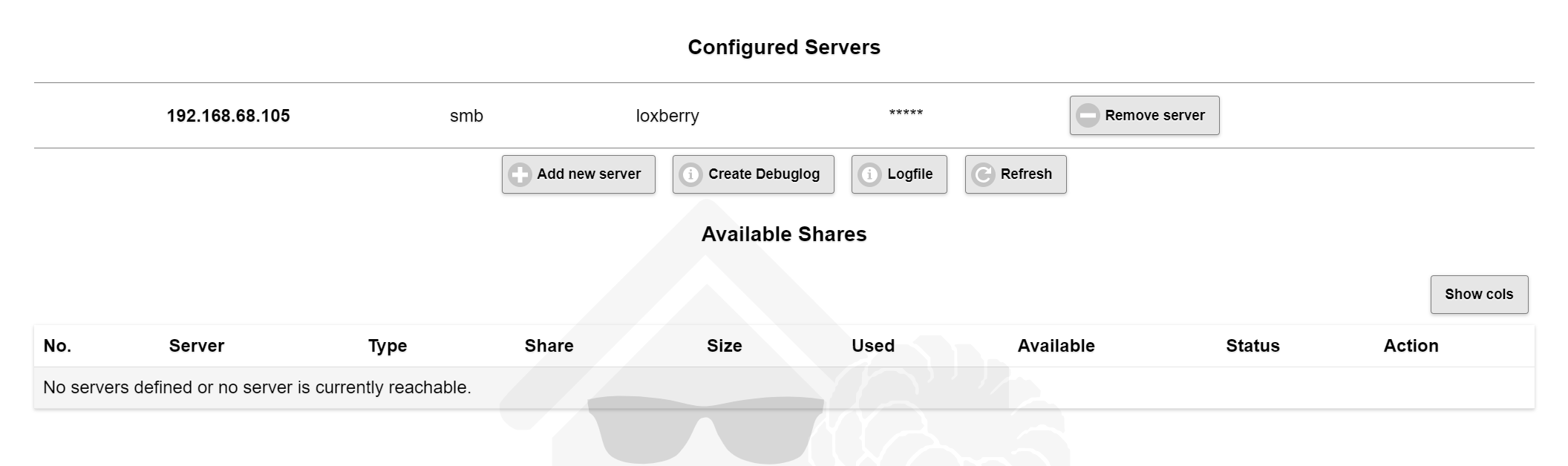

            OK I did that, I now have a "Configured Server", but it's not listed as an available share, see screenshot below. It also does not appear as an available backup destination.
            Klicke auf die Grafik für eine vergrößerte Ansicht  Name: loxShares_2024-02-16 180216.png Ansichten: 0 Größe: 85,4 KB ID: 423327
            I found the share location in /media/smb/192.168.68.105, but it's not readable from the command line. Hence I guess why it's not listed as an available share. Which is weird as I could setup a successful mount (for the command line) using dietpi-drive_manager, using the same credentials...
            Zuletzt geändert von benArrayx; 16.02.2024, 17:33.

              Please attach logfiles as file here (as .log or .zip), copy and paste them into a post let the forum become unreadable by others….
              Your old manually added mountpoints are still exist in fstab, maybe that creates a conflict.

                So I removed the 2 mounts I had setup via dietpi-drive_manager. Then I deleted the Netshare I created in Loxberry. Then I re-created the Netshare in Loxberry - same result, I can't access the share via the command line at /media/smb/192.168.68.105, Netshare doesn't see it as an Available Server. Debuglog attached.
                Where is raspiBackup in Loxberry. I can't find it searching on the command line with whereis. It would be useful to know the command line that is used to start a backup so I can play with that on the command line...

                    When adding a Netshare in Loxberry I only have the option to add the server IP address, username and password, that's it.

                      I am going to have to leave this for today, but if you can give me any info about where raspiBackup is located in Loxberry, if there are any more detailed logs that show the command used to invoke the backup, which user is being used to invoke the backup, all would be helpful... Thanks also for your attention so far
                        #43
                        RaspiBackup is not used for this type of backup. It is a development from us for LoxBerry.
                          #44
                          sudo -u loxberry mkdir -p $destpath
                          This is the command that seems to fail.
                          This is called, and then checked if the directory exists.
                          Both as root. The error is returned if the created directory could not be found.
