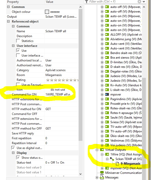

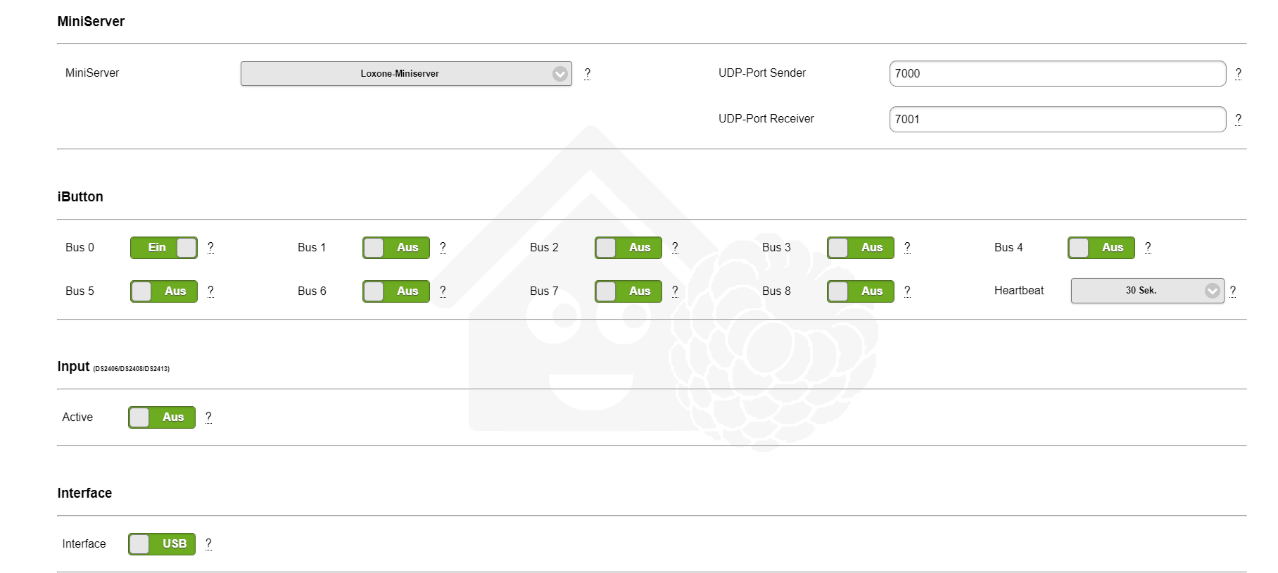

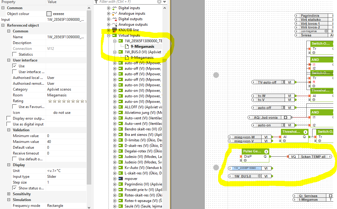

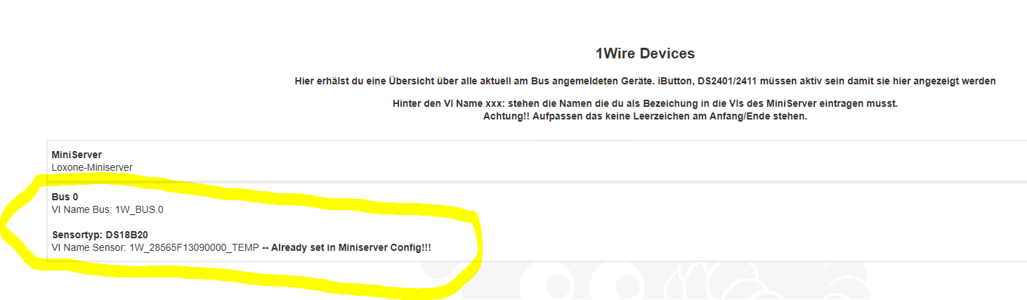

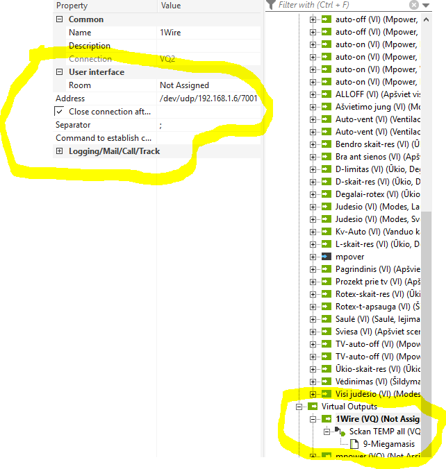

                      Hello everyone
                      Please help me,
                      configure loxberry 1wire interface with ds18B20 sensor is connected via usb.
                      I configured everything in accordance with the instructions.
                      But the value of the sensor does not change, show 0.
                      Attaching Configuration Pictures
                      Thanks to all.
