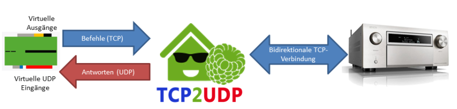

      Hello,
      I used the DEBUG option from the beginning. The log file is consistent with what I see in the UDP monitor. It gives the impression that Loxone doesn't send anything back.
      I tried to fire a test message (see second picture) with a push button "Zend testsignaal". The counter did count a trigger impulse, but the log doesn't show a message from the miniserver to the device.
      Kind regards,
      Luc
        #93
        OH, I've missed that!
        See the picture from the plugin documentation.
Ansichten: 132
Größe: 78,0 KB
        You've to send TCP messages to LoxBerry and receive UDP messages.
        So you create a Virtual Out with address
        Address: tcp://192.168.1.43:9101
        and put your commands to Virtual Output Commands.
        Incoming commands from the Miniserver then are logged as
        Forward Miniserver_PRV43->BLGW: ....
        Regards,
        Christian

          Thank you Christian,
          Now everything seems to work. I always tell my students to read the whole text in detail. I should have done that better myself!.
          Nice to have found a way to let Loxone communicate with Bang & Olufsen equipment.
          Kind regards and "vielen Dank" for the support,
