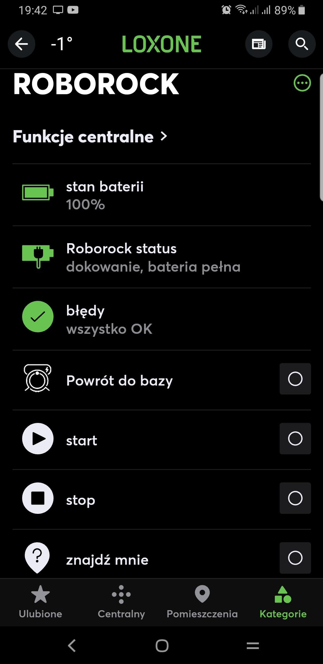

                  Zitat von DaniG
                  hey,
                  just to answer that question. Yes, it works for S7 Pro Ultra.
                  Actually I was receiving "unsupported model warning" (my model is a62), however this device has been already added to miio supported ones in this PR: https://github.com/rytilahti/python-miio/pull/1582
                  Since I was not able to install newest python-miio (because I couldn't update python to version >= 3.8 on my loxberry) thus I just modified following file on my loxberry:
                  /usr/local/lib/python3.7/dist-packages/miio/integrations/vacuum/roborock/vacuum.py
                  by adding necessary lines (line 160 ROCKROBO_S7_PRO_ULTRA = "roborock.vacuum.a62" and line 186 ROCKROBO_S7_PRO_ULTRA,) , here is the correct file for your reference:
                  https://github.com/rytilahti/python-...20f3e333b0a16f
                  After that the error was gone and I was able just to enjoy this great plugin
                  ​​Klicke auf die Grafik für eine vergrößerte Ansicht Name: roborock_loxone.jpg Ansichten: 0 Größe: 200,3 KB ID: 367245
                  DaniG Hi,
                  will you get an message if the water box is empty?
