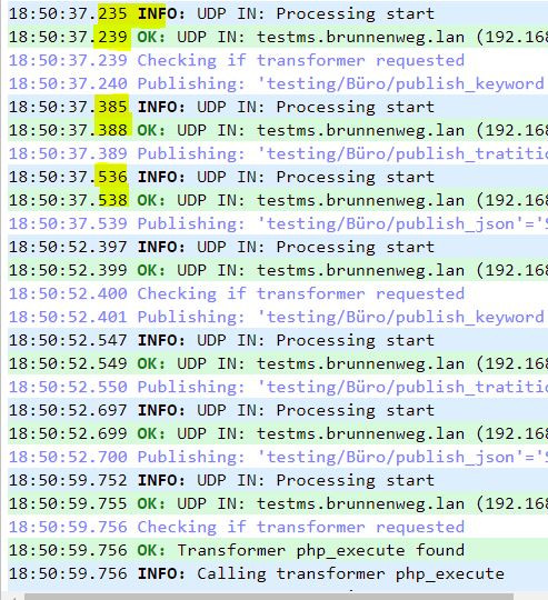

                  #746
                  Hello,
                  first of all, I'm sorry for not fitting with the thread language, my German is really poor...
                  I've integrated my Miniserver with the Loxberry (with an external broker, on a different machine)
                  The test consisted of
                  1. Publishing a message on a topic & receiving it on a miniserver
                  2. Sending an update via virtual output instantly (without any logic)
                  I've checked the Loxberry MQTT plugin logfile and I can see that between sending an item to miniserver and receiving UDP packet back from it, there is a huge delay of around 200ms....
                  Is it expected to be that high? Both the miniserver and the RPi4 (with Loxberry) are attached to the same network switch by LAN cable.
                  16:50:32.405 <INFO> MQTT received: testtopic/number: on
                  16:50:32.406 testtopic/number is non-cached
                  16:50:32.407 testtopic/number matches testtopic/number, send to MS 1
                  16:50:32.407 HTTP: Preparing input testtopic/number (noncached): 1
                  16:50:32.616 <OK> UDP IN: (192.168.3.254): testtopic/number/set 1
                    #747
                    The "Preparing" log statement is directly placed before the send, so there is no gap.
                    Then processing of the Miniserver. is running.
                    The UDP-IN statement is logged AFTER a DNS reverse lockup of the IP address.
                    Therefore, either the processing of the Miniserver is slow, or the response of the DNS server. A reverse Lookup usually takes some msecs, but not 200.
                    I'll add a log line BEFORE the Lookup, to see the time gap.
                      Then, you need to trace the timing on the Miniserver.
                      Not sure about that... I've added a log just before the my($port, $ipaddr) = sockaddr_in($udpinsock->peername);
                      There is quite significant delay between those two logs of 120ms... Not sure why.
                      18:31:42.577 <INFO> MQTT received: zigbee2mqtt/0xccccccfffee2762f/click: on
                      18:31:42.578 zigbee2mqtt/0xccccccfffee2762f/click is non-cached
                      18:31:42.578 zigbee2mqtt/0xccccccfffee2762f/click matches zigbee2mqtt/0xccccccfffee2762f/click, send to MS 1
                      18:31:42.579 HTTP: Preparing input zigbee2mqtt_0xccccccfffee2762f_click (noncached): 1
                      18:31:42.663 <OK> BEFORE UDP IN
                      18:31:42.781 <OK> UDP IN: (192.168.3.254): zigbee2mqtt/0xccccccfffed45a82/set 1
                      18:31:42.781 Publishing: 'zigbee2mqtt/0xccccccfffed45a82/set'='1'
                      In fact, this is the $udpremhost = gethostbyaddr($ipaddr, AF_INET); which takes 130ms... What do you need it for? It looks like it is used in the log only. Am I correct?
                    #748
                    Gast
                    The lookup will be used in future features (not released yet).
                    I've never thought about that the lookup will be a problem (see picture with additional line before the lookup), but I'll build in a fuzzy logic to decide if lookup time is acceptible or not, and disable it. Your lookup time is not normal, possible network issue with DNS and (not using) DHCP.
                    This is a Raspberry Pi 2.
                      Still lagging after what?
                      Check the Miniserver monitor.
                      Check with the current master of the plugin.
                      Zuletzt geändert von Christian Fenzl; 23.02.2021, 16:24.
                      I'm sorry for the mess in the comments. Initially after I switched to HTTP it was OK for a moment but on the next trial it was the same (around 80ms for some requests)
                      I'll try with master and try the monitor.
                      With master based version it looks perfectly fine.
