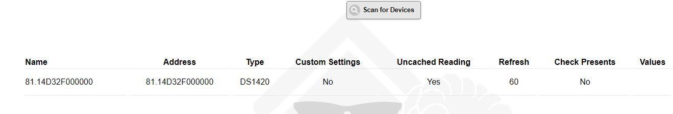

    Hello
    Thanks a lot for your work
    The plugin looks fantastic
    I'm using USB DS9490R#
    And I'm connect DS18B20 with RJ12 - pin 1 is 5v / pin 2 is GND / pin 3 is Data 1-wire
    But the plugin just reconize the DS9490
    Any idea?
    I reboot a couple of times
      • 5085
      #227

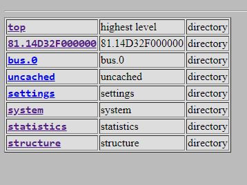

      If OWFS does not recognize the sensor, the plugin cannot do anything. What is that 81.xxx sensor? If that is a real sensor, then your hostmaster and owfs are ok.
      Connection of the DS18b20 correct? https://datasheets.maximintegrated.c...ds/DS18B20.pdf

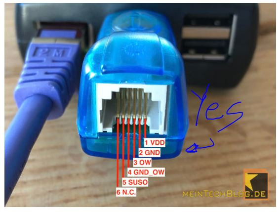

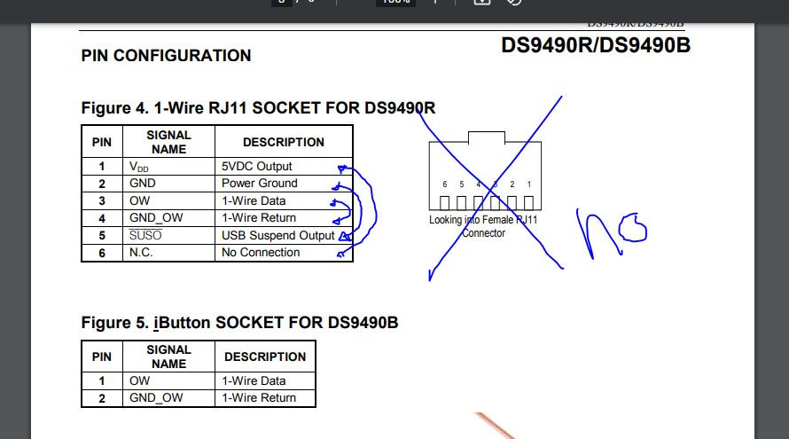

          Hello again
          Thanks for your answer Profesor Mobilux
          I find the problem in the DS9490R #
          Is because in the picture of pin I was thinking the position of pins are from the connector...
          I attache the pictures
          Now is working fine
          Thanks a lot
