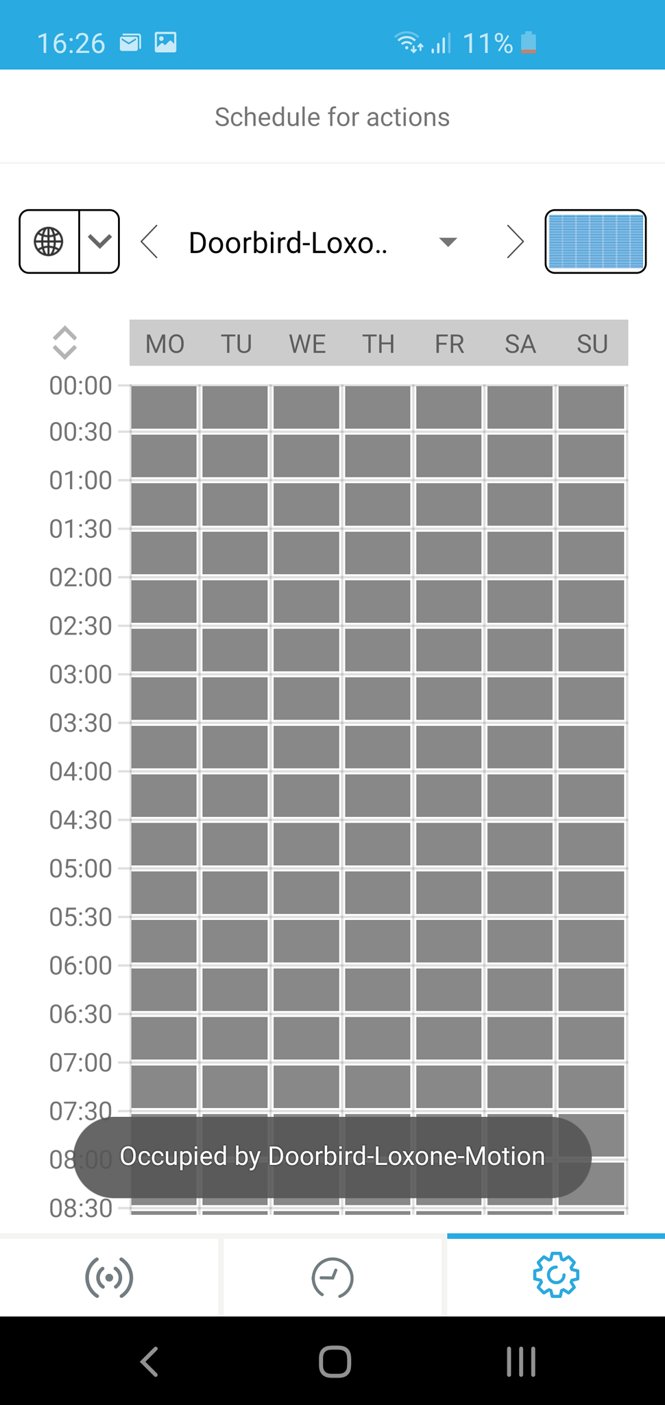

          #321
          I have Doorbird D101 since yesterday, already integrated with Loxone, working fine except from one problem.
          I really don't know how to pass to Loxone BOTH doorbell press signal and motion sensor signal.
          I have both HTTP calls set up and either working fine, but they both seem to use the same schedule and if I enable motion sensor for all time, I can not enable doorbell signal:
Ansichten: 1965
Größe: 234,3 KB
          Any hints on that matter very appreciated.
          I've read this thread but didn't find info on such issue.
          • TomekWaw
            TomekWaw kommentierte
            Yes. As I understand HTTP(S) Actions have to be enabled in "Schedule for actions" and only one action may be enabled at a time on this Schedule. I would very like to be mistaken here, but have no any clues how to configure it differently
          • hme0354
            hme0354 kommentierte
            have you tried if one of the signals will be blocked by doorbird and not send to loxone if the schedule is set to not ring or so?
            in my understanding the schedule is only for the doorbird app. but if you need a schedule you can build on in loxone aswell.

          #322
          Ok, now it's working. Really strange!
          I had a setting before:
          - Schedule for HTTP Action "doorbell" - never
          - Schedule for HTTP Action "motionsensor" - always
          and only motion sensor has been passing to Loxone
          Then I changed schedule to:
          - Schedule for HTTP Action "motionsensor" - never
          and still only motion sensor is being passed to Loxone
          Finally I changed schedule to:
          - Schedule for HTTP Action "doorbell" - always
          and since then - both doorbell and motion sensor signals are passed.
          So it seems that action for doorbell HTTP Action is required for it to work.
          And action for motion sensor isn't required.
          I really don't get that part of the software....
          Zuletzt geändert von TomekWaw; 16.06.2020, 13:03.
