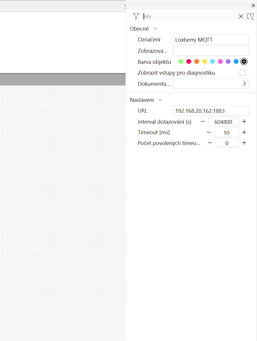

            could someone share a screenshot of how MQTT is configured in Loxone?
            I tried to follow the manual, but I couldn't quite figure it out.
            I haven't been able to get it working, and I need to get some data into Loxone.
            Any help or example configuration would be greatly appreciated. 🙂
            Thanks in advance!

            According to the recommendations, this should work via MQTT. I'm still using a Loxone Gen.1 Miniserver.
            In LoxBerry, MQTT is configured with the following connection details:
            • Host: 192.168.20.162
            • Port: 1883
            • Username: loxberry
            • Password: XXXXXXXXXXXXX
            The LoxBerry IP address is 192.168.20.162:8084.
            I'm trying to follow the guide, but I can't get any values into Loxone. See the attached screenshot.

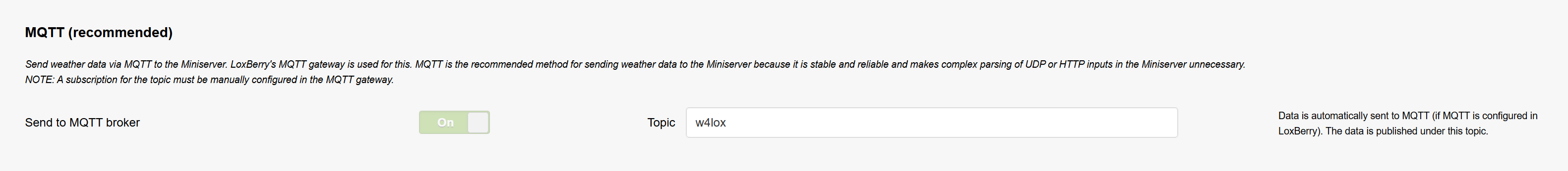

              Hmm, what parameter(s) do you like to get? The name of the parameter in Loxone config needs to be exactly from the list in the wiki, e.g. w4l_cur_tt for current real temperature. I also have a MS Gen. 1, so the hardware is not the issue. Try Google translate, maybe Google lens to translate the bubbles in the screenshots from the guide.
              Try the following:
              1. Configure your MS in the Loxberry as a miniserver with credentials and do a test. If this is working fine, IP addresses and credentials should be O.K.
              2. Create a subscription on the Loxberry in MQTT under the MQTT gateway, subscriptions tab and name it to the the topic that you've configured in the weather4lox plugin in the 'send to miniserver' tab, e.g. subscription name w4l/# if your topic is w4l
              3. Use the MQTT Incoming Overview in the MQTT gateway on the Loxberry and filter on your topic, e.g. w4l (first screenshot in post #20), w4l_cur or w4l_cur_tt to see the current temperature only. It's a regular expression match that allows you to restrict the output. All parameters that you see here, are forwarded from the plugin to the MQTT Gateway. If you don't see any parameters from weather4lox, the subscription may be missing (problem in step 2). If a specific parameter is missing, the name may be wrong wrong.
              4. Attention: values for a parameter are submitted to the MS only if the value has changed, so either do a restart of the mqtt gateway.
              Look into the log of the MQTT Gateway, but also Weather4Lox plugin. Which guide did you follow? This one here? Don't miss any step!!

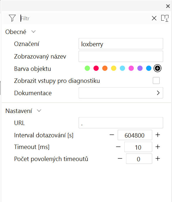

                I think I need some advice on the Loxone side. What values exactly should I enter in the Virtual HTTP Input?
                I may be using the wrong IP address or configuring it incorrectly. See the attached screenshot.
                I never had any problems getting data into Loxone via UDP, but I have never managed to get MQTT working properly. I can see data arriving in the MQTT Gateway on LoxBerry, but I'm probably missing something in the Loxone configuration.
                  The short answer is: nothing. This object only needs to exist to be able to configure virtual http input commands.
                  The longer answer may help you to understand how the MQTT gateway of the loxberry communicates with the miniserver. So if you had asked this question to Loxone, your answer would be like "this is not supported, the MS gen. 1 does not have virtual MQTT input. The answer here in the Loxforum is different: if you have a Loxberry, you can 'misuse' virtual http input commands for MQTT. Technically they are not used as HTTP inputs and you could also use other types of inputs, because the MQTT gateway is using websockets to communicate with the MS. The MQTT gateway is using a push method to send the new value via websocket to a specific parameter, so only the name of the parameter needs to match.
                  These IP addresses can't be wrong, because they are not used if a value is pushed to the MS over websockets. However, if you leave the IP address empty, Loxone config complains that the input is not configured completely. I recommend to put in just a dot as the URL in the virtual http input as a dummy and a very high refresh interval. Also in the virtual http input command you can configure a backslash dot as a dummy in the detection to avoid complaints from Loxone config.
                  What is the advantage to use MQTT over normal HTTP inputs? Normal http inputs poll a website every few seconds or minutes, parse each parameter by virtual http input commands. The polling and parsing puts load on the MS. With MQTT and websockets, the MQTT gateway is pushing a value to the ms. This pushing is much more efficient and a parsing can be avoided. You even get a changed value much faster without a need to poll every second.

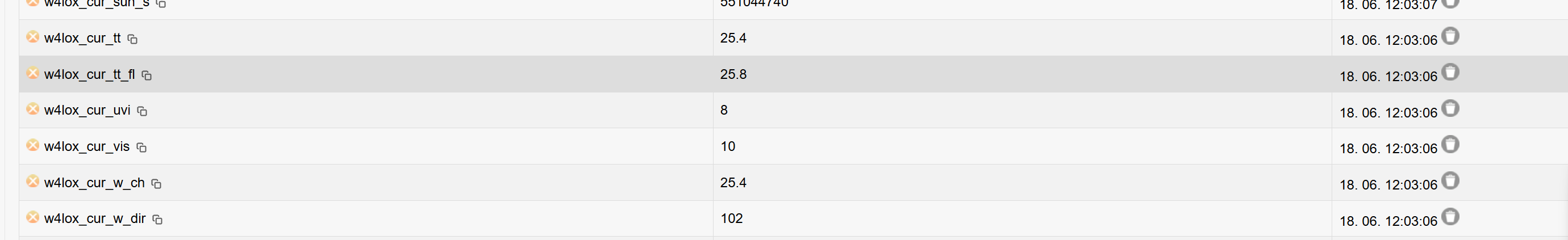

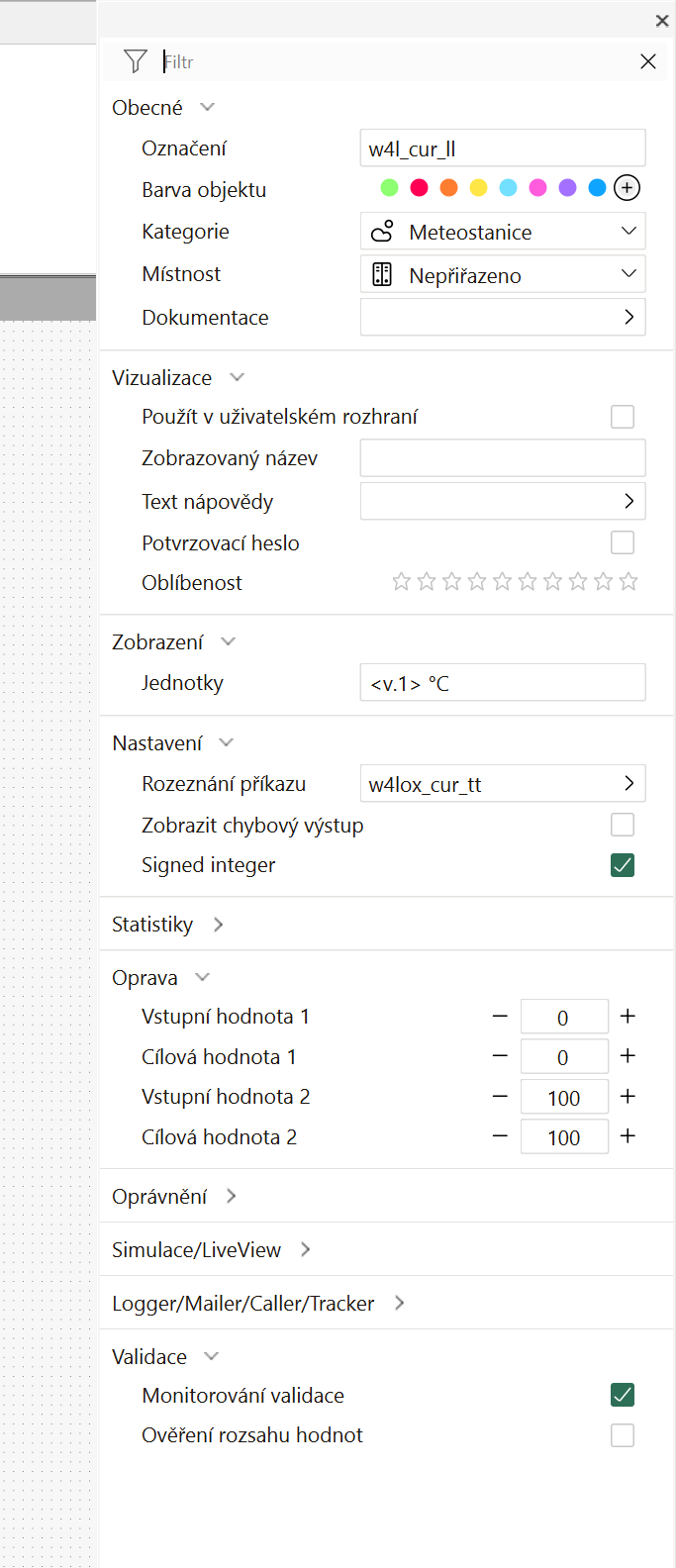

                    It seems that I don't have something configured correctly in LoxBerry because I'm not receiving any data, even though I've already followed the guide.
                    I tried to follow the instructions step by step, but I'm still unable to get any values into Loxone. It's possible that I'm missing something or have configured something incorrectly.
                    I'm attaching screenshots for reference.
                    Klicke auf die Grafik für eine vergrößerte Ansicht  Name: image.png Ansichten: 0 Größe: 80,9 KB ID: 486431Klicke auf die Grafik für eine vergrößerte Ansicht  Name: image.png Ansichten: 0 Größe: 90,0 KB ID: 486432Klicke auf die Grafik für eine vergrößerte Ansicht  Name: image.png Ansichten: 0 Größe: 30,9 KB ID: 486433Klicke auf die Grafik für eine vergrößerte Ansicht  Name: image.png Ansichten: 0 Größe: 73,3 KB ID: 486434​​​
                    It's solved now. I finally managed to get MQTT working, and the data is now being transferred to Loxone correctly. 🙂
