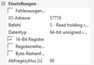

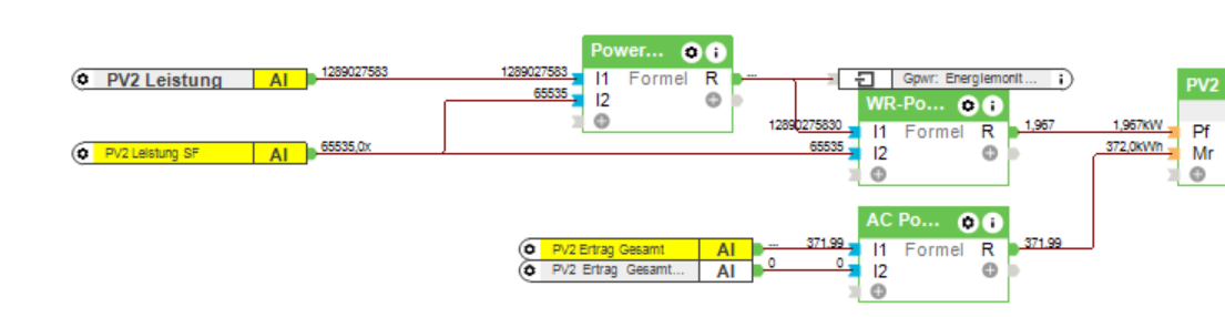

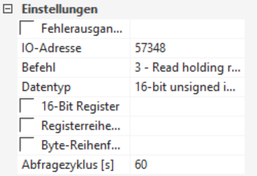

    Hi Ralph,
    looks totally diffent on my side.
    PV2 Leistung = I_AC_Power
    PV2 Leistung SF = I_AC_Power_SF​
    Why are you getting the nummers in a readable way directly?
    br, bbi

      HI bbi
      That's quite easy. I'm reading 16 bit values
      Of course, you can also read 32-bit values and try to calculate them in the formula. But, to be honest, that's the easiest way, and I haven't gotten any errors yet (or I haven't noticed).

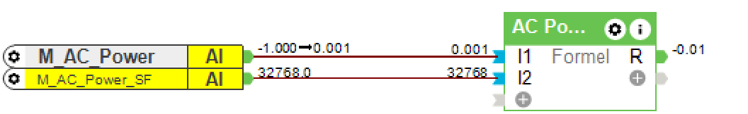

      #153
      There's a good reason for not reading the Modbus values (Value and Scale Factor) as two separate 16bit entries. Ralphidelio hasn't seen it yet, but statistics will be thrown out significantly when Scale Factor is slightly delayed. You may then end up with a value that is x10, x100 or x1000 out from reality.
      The benefit of grabbing both values in one go (as a 32bit Modbus sensor), is that the time difference is eliminated. The formula simply 'dis-entangles' the combined Value and Scale Factor and produces the finished product of PV Power.
      bbi - In your screenshot at post #151, you have confused the issue by introducing Scale Factor into a formula. Scale Factor is already present in the value you see at PV2 Leistung. The formula I posted at post 149 produces the value you want.
      Klicke auf die Grafik für eine vergrößerte Ansicht  Name: Formula.png Ansichten: 0 Größe: 5,6 KB ID: 386581

      • Ralphidelio
        Ralphidelio kommentierte
        Hi Tico
        Thanks for the hint. I checked and saw the same effect as you describe. So now I also read all values in one step into direct 32bit values..
        For the first look, its a bit confusing, but now the statistcs looks quite better!

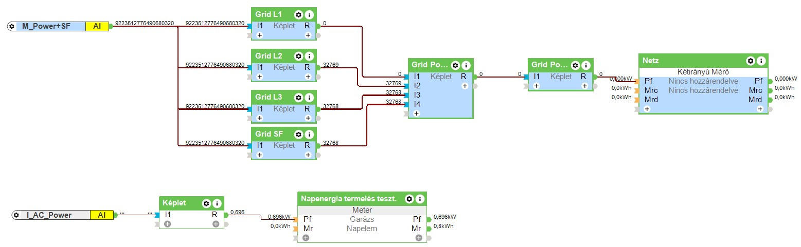

      Dear Tico bbi Ralphidelio
      Few more thing im not sure....
      1. First thing is the Pv Power and scale factor question......i think this should be work this or that way...
      2. We poll the information from the inverter every 5 second (for exapmle..). Every 5 second we got the current production value. This value pass to a meter block, which block sums it up..... But.... What about the production which is outside of query time? (0 gap 5 gap 10 gap 15 gap...) So there is missing production amount between every 5 seconds?
      Do i understand well?
      3. Did you check PLCProg 's config template? I'm not sure what this M_POWER_SF part is for? (For me the L1 is always 0...)
Ansichten: 1017
Größe: 113,0 KB

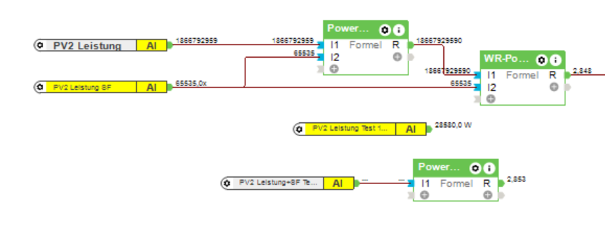

      #155
      Dear Tico bbi Ralphidelio​,
      here the result of all 3 Solutions:
      1. My proposal
      2. Proposal of Ralph​
      3. Ticos approach
      Above 3 KW all methods delivered the same result. But below the approch of Ralph is showing factor 10 too much.
      My, als well as Ticos approach are working fine.
      Nevertheless My one is not the smartest solution ;-)
      Therfore I will go with Ticos approach. Tico​ Thank you very much, Iearned a lot.
      br, bbi

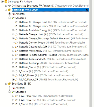

    • aw_ch
      • 15.08.2017
      • 67
      #157

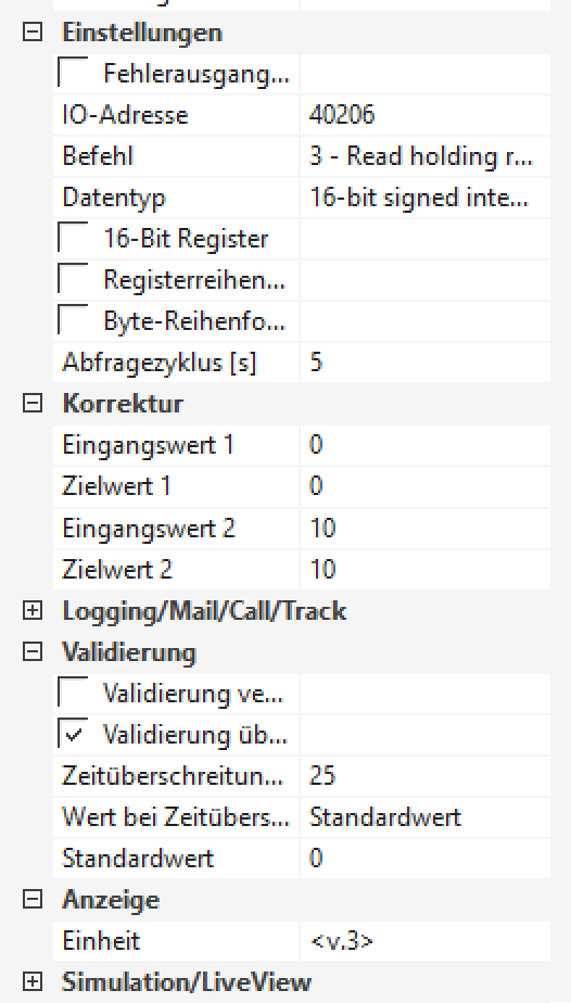

      hallo zusammen
      seit zwei Wochen schlage ich mich nun auch mit der Solaredge-Einbindung herum. Im Einsatz sind zwei Wechselrichter (einer Master, einer Slave) und eine Batterie. Modbus ist aktiviert und einzelne Werte können korrekt abgerufen werden. Die beiden WR sind seperat über den Master ansprechbar (Modbus-ID 1 und 3), die Werte müssen dann addiert werden. Auch die Batterie (Status, SOE, Ladung/Entladung) kann ich korrekt auslesen.
      Die eigentlich wichtigste Messgrösse kann ich aber bisher nicht abrufen, den Zähler für Bezug / Einspeisung. Wie in der Anleitung und den Beispielen versuche ich die Werte über 40206 und 40210, erhalte hier aber keine sinnvollen Werte:
Ansichten: 977
Größe: 11,4 KB
      Beim Zähler handelt es sich um einen Solaredge-Zähler, welcher per Funk angehängt ist. Im Portal werden die korrekten Werte angezeigt, der Zähler scheint damit zumindest korrekt verbunden zu sein. Hat hier jemand Erfahrung oder Ideen, wie die Werte abgerufen werden können?​

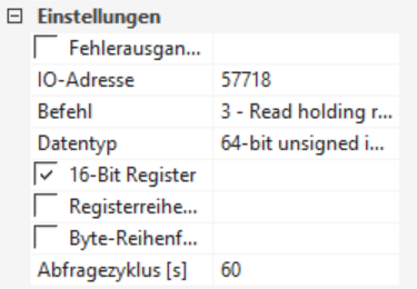

      • Ralphidelio
        • 08.06.2016
        • 26
        #158

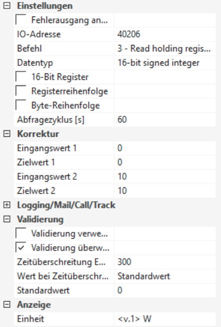

        Hallo aw_ch
        Das Register ist korrekt. Prüfe mal bitte ob du die anderen Parameter richtig gesetzt hast:
Ansichten: 1054
Größe: 101,2 KB
        Wichtig ist, dass du die Daten am Master ausliest. Ich selbst habe auch 2 x WR von SolarEdge im Einsatz und inkl. den Metering Komponenten.
        Wobei ich die Daten des Slave WR direkt auch über Modbus TCP bei diesem auslese.
        Der M_AC_Power_SF wird aus dem Register 40210 ebenfalls mit den gleichen Parametern ausgelesen.
        Gruß Ralph

          Hallo Ralph
          Danke für dein Feedback und die Tipps. Soweit ich sehe, sind die Einstellungen bei mir identisch:
Ansichten: 984
Größe: 28,1 KB
          Im Netzwerk hängt bei mir auch nur der Master, dieser ist via Modbus-TCP verbunden. Der Master wird dann mit ID 1 und der Slave mit ID 3 angesprochen. Die oben aufgeführten Register rufe ich vom Master ab, erhalte aber immer noch nur Power=-1 und SF=32768.
          Hast du auch diesen Energiezähler und per per Funkt (drahtloses SolarEdge Home Netzwerk) angeschlossen?
          Der SolarEdge Home Energiezähler ist eine hochpräzise Lösung zur Messung von Produktion und Verbrauch.
          • Ralphidelio
            Dann kann ich mir nur vorstellen, dass die Modbus ID des Zählers nicht stimmt.
            Mein Modbus Zähler ist via Kabel am WR dran. Aber dafür sollte der WR das Register Management ja machen.
            Ich selbst habe noch einen älteren Zähler dran. Ein anderer Kunde hat aber zwei Stück der Baureihe die du hast verbaut, allerdings via Kabel und damit lassen sich die Werte aus dem Register lesen.
            Was sagt dir die App von mySolarEdge, wenn du den Wechselrichter scannst? Damit solltest du eigentlich die Modbus Parameter anschauen können.
            Zuletzt geändert von Ralphidelio; 24.07.2023, 09:44.
          • aw_ch
            aw_ch kommentierte
            Die Anlage steht bei meinen Vater, da müsste ich mal vorbeigehen. Habe mich mit der App und Konfiguration von Solaredge bisher nicht befasst, das kam alles (theoretisch) fertig vom Installateur.
            Demnach müsste der Zähler eine eigene Modbus-ID haben? Und über diese auch angesprochen werden oder über die ID vom Master?
          • Ralphidelio
            Der WR nutzt für jedes angeschlossene Modbus Gerät eine andere Modbus Adresse. Daher kann ich mir vorstellen, dass über den Anschluss via Wireless Schnittstelle von SE eine andere Modbus Adresse verwendet wird, wie wenn der Zähler direkt angeschlossen wird.
            Aber das müsste dir direkt in der App angezeigt werden können. Bei der SE App auf dem Handy / Tablett das Burgermenü oben links anklicken und Wechselrichter Modus anwählen. Dann versucht die Kamera den QR Code auf dem WR zu lesen. Der Rest wird eigentlich von der App gut erklärt.
            Probiers einfach mal aus.

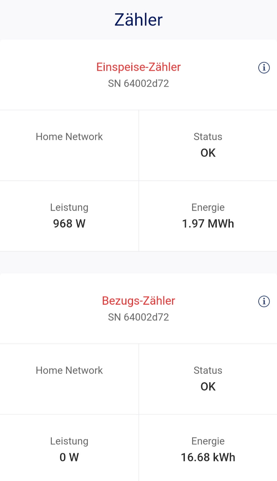

          Ich habe heute versucht mit der App die Einstellungen herauszufinden, allerdings wird mir bei Zähler nur folgendes angezeigt:
Ansichten: 869
Größe: 187,3 KB
          Ausser "Home Network" (so nennt Solaredge wohl die nicht weiter erklärte Funktechnik) sehe ich hier nichts was mir weiterhelfen würde?​
