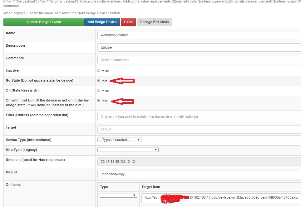

      Hi guys. I have LoxBerry V1.2.5.5 and Sonos4lox: v3.5.9 and LoxBerry HA Bridge 0.3.1 + echod dot 1. generation currently, and all was working without problem before and all commands from allexa loxone did but now I can see there is no problem in case of alexa commands TURN ON or TURN OFF but problem is dimm commands. Behaviour in case of dimm commands to alexa is something like random...always is doing something different or it dont react even alexa confirm as "OK".Let me inform you also that if I am trying buttons directly in habridge webinterface like TEST ON, TEST OFF and TEST DIM all is working perfect without problem. Also all is working great in loxone config. Only problem is if I say alexa commands behavious is different. I have also tried some options in HA bridge as you can see in attached picture (red marked) but still is not correctly all working. Is there any change or how can I solve it please?thanks
      Zuletzt geändert von ager; 12.02.2019, 13:20.
