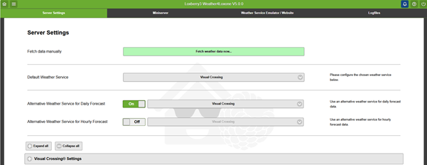

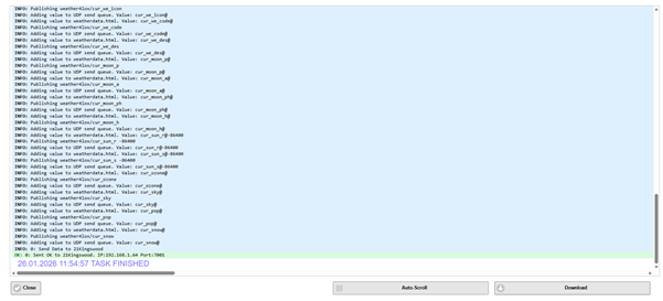

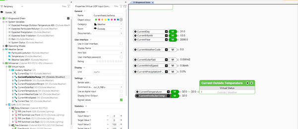

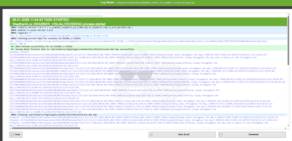

          Hi all, I hope you can help me. I had been successfully running a Loxberry with the Weather4Loxone plugin and a Miniserver Gen 1 for a long time. I recently replaced the Gen 1 Miniserver with a Gen 2 and also upgraded to Loxone Config v16. This obviously broke the previous Weather4Loxone integration. So, I have been attempting to change the integration, so that it uses UDP to send the Weather Data to the Gen 2 miniserver.
          I am using the Visual Crossing weather service. The issue I am having is that the data sent to the miniserver via UDP never changes, all the values look like “fixed” test values. The various temperatures are always 32 and the date and time is always 31-12-2008 at 23:00. If I look at the various logs, as far as I can tell, the Visual Crossing Grabber runs successfully and appears to correctly receive weather and forecast data and save it into the temp files. The Fetch Process logs show the grabber process starting and ending and the datatoloxone script being run correctly. The DatatoLoxone log file shows the process starts, successfully authenticates with the MQTT broker, and you can then see it publish, and add to the UDPO send queue, all the “fixed” values rather than using any of the data obtained from the weather service. At the end the UDP message is successfully sent to, and received by, my miniserver, but only the “fixed values” ever arrive.
          Here are supporting screenshots of everything. Settings

            • 5675
            #1422
            This is not the current version you installed but the development version. Install latest stable.
