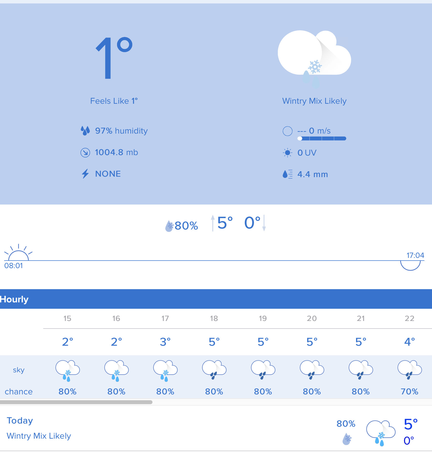

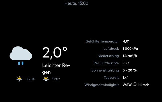

      we are talking about a 2 hour timeshift
      from url clock says actual time
      but forecast starts from 15:00
Name: Bildschirmfoto 2021-01-28 um 13.50.46.png
Ansichten: 855
Größe: 54,6 KB
      from App time 15:00
      forecast from 15:00

        • 5675
        #664
        ledchab Thanks. But I think we need an additional set of data. Please grab weather data once again and again please send both log files in debug mode. Additional, im the Emulator tab of the plguin, please click on "test" (button is maybe named different - cannot remember :-)) and also post the emulator data here.
        It is important that we have all data of the same time, so please first grab the weather data and then send logfiles and emulator data of the same time.

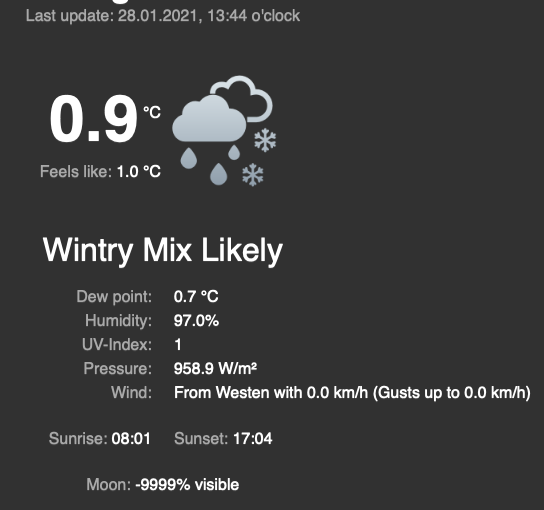

        #665
        here we go
        [ATTACH]n288566[/ATTACH]
        [ATTACH]n288567[/ATTACH]
        [ATTACH]n288568[/ATTACH]
Name: Bildschirmfoto 2021-01-28 um 14.47.27.png
Ansichten: 824
Größe: 157,1 KB
          But before you had a two hour gab, right?
        • nufke
          nufke kommentierte
          Can you share the Weatherflow app screengrap and the emulator data?
          It is known that the Loxone app is not regularly updating its weatherforecast, so you need to look to the weather4lox weather webpage or the raw data.

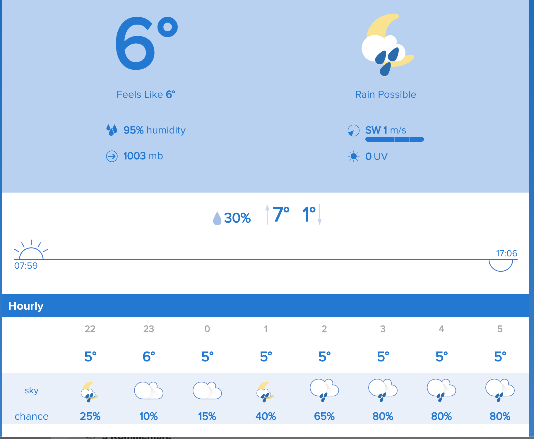

          #668
          nufke
          [ATTACH]n288761[/ATTACH]
Name: Bildschirmfoto 2021-01-29 um 21.15.19.png
Ansichten: 714
Größe: 128,3 KB
          • nufke
            nufke kommentierte
            In my view, all looks good... The Loxone app shows the current (live) observation of your local Weatherflow weatherstation full screen and as first entry in the list, and takes this from the first line from the emulator data (you recognize this with the temperature notation with 1 decimal accuracy). The items in the Loxone app forecast (horizontal scroll part) are idential to the forecast list from the Weatherflow app as you've shown above (notation is in degrees without decimals, so x.0 notation in the emulation data and in Loxone app).
            Note that the current forecast data from Weatherflow is NOT used, since we use the current weatherstation data. So it could happen that you see some differences due to this. Please let me know if that explains the differences you see, or if I overlook something here.

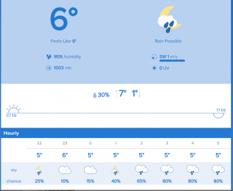

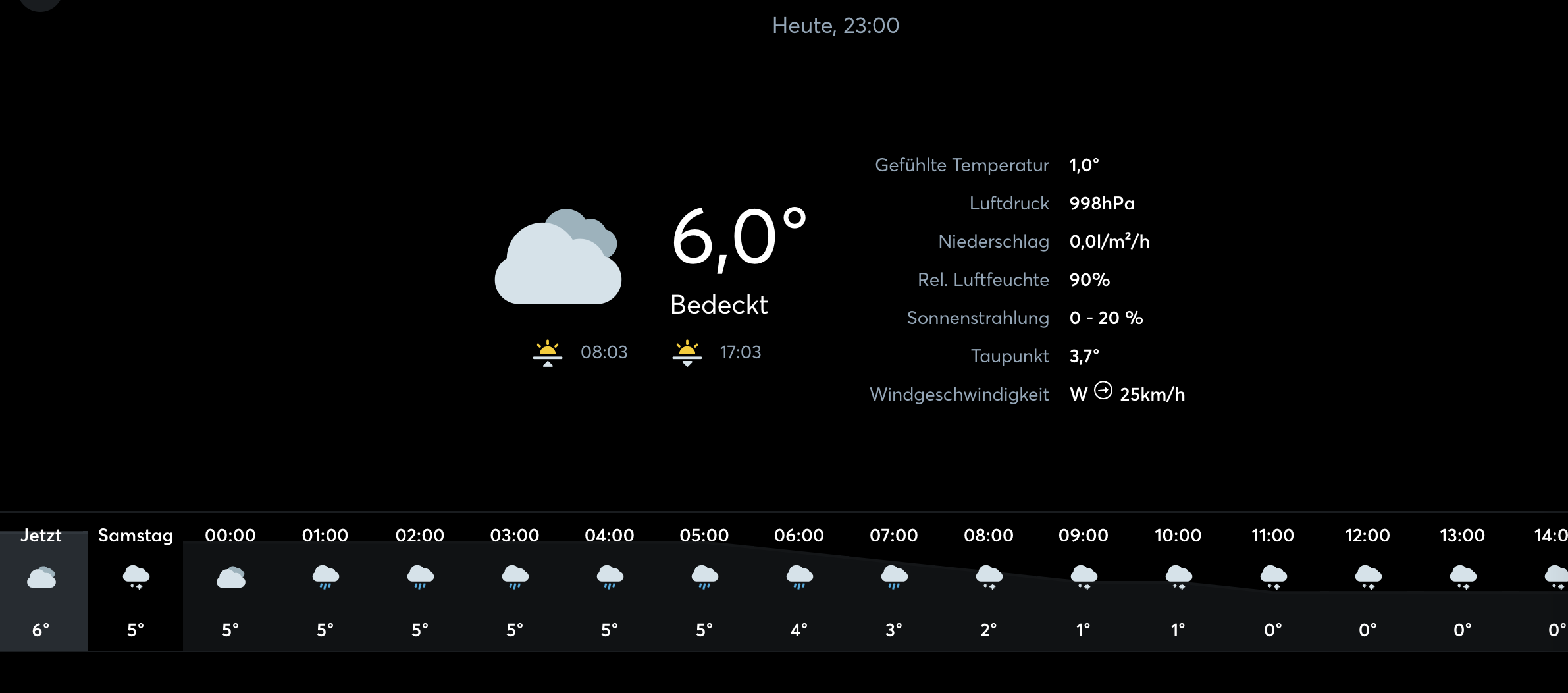

          that's what we talking about?
          emulator screen in App shows the wrong time (grabbing time from Miniserver?)
          Klicke auf die Grafik für eine vergrößerte Ansicht  Name: Bildschirmfoto 2021-01-29 um 22.20.37.png Ansichten: 0 Größe: 120,8 KB ID: 288772
          actual time is 22:23
          the top line says 23:00 - so it is in the future should be 22:00 - when i switch to other service there is 22:00
          it is not a really problem for me - so i just marked it as little confusing ;-)

          • nufke
            nufke kommentierte
            The UTC+1 calculation in the emulation data is calculated based on the response from the weatherflow API based on your stationID, so this looks OK. Indeed there is no setting in the weatherflow app or account to change your timezone. Perhaps this was a question when installing the weatherflow hub, but I do not recall this anymore.
            The weather4lox integration is only of use for the weatherscreen and forecast in the Loxone app, and not something I recommend for home automation, since you probably query only each 5 minutes or so. Instedd, you need to use the local Tempest UDP data directly to grab instant data for temperature, illuminance, precipitation, lightning detection, etc.
