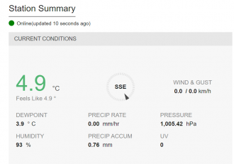

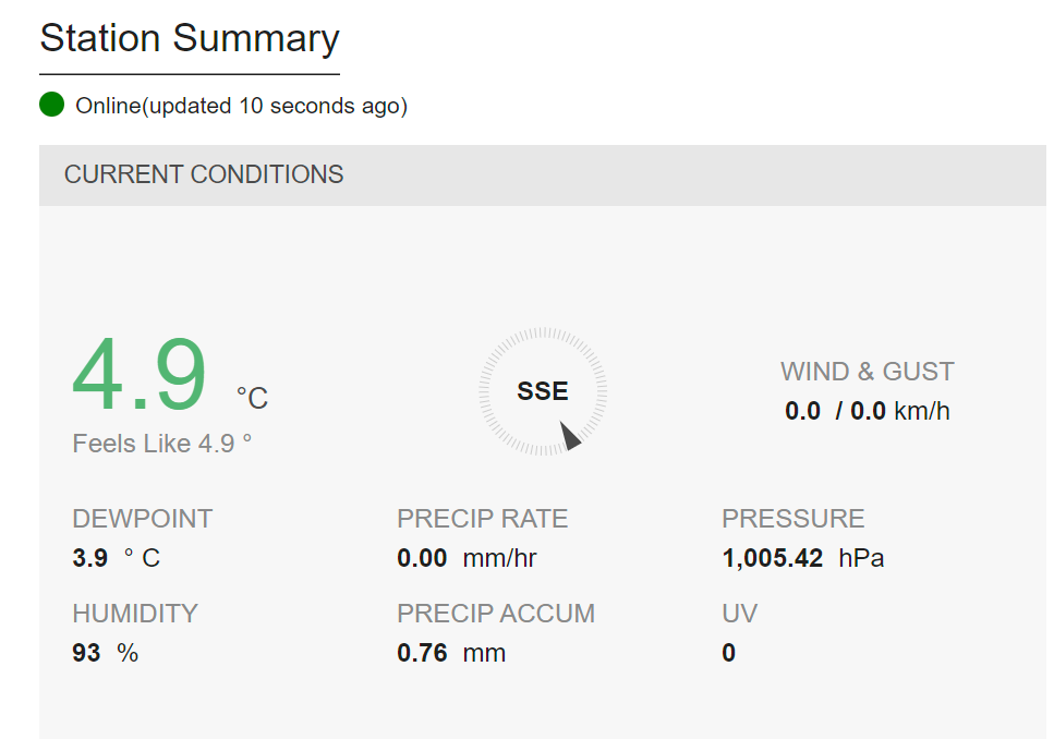

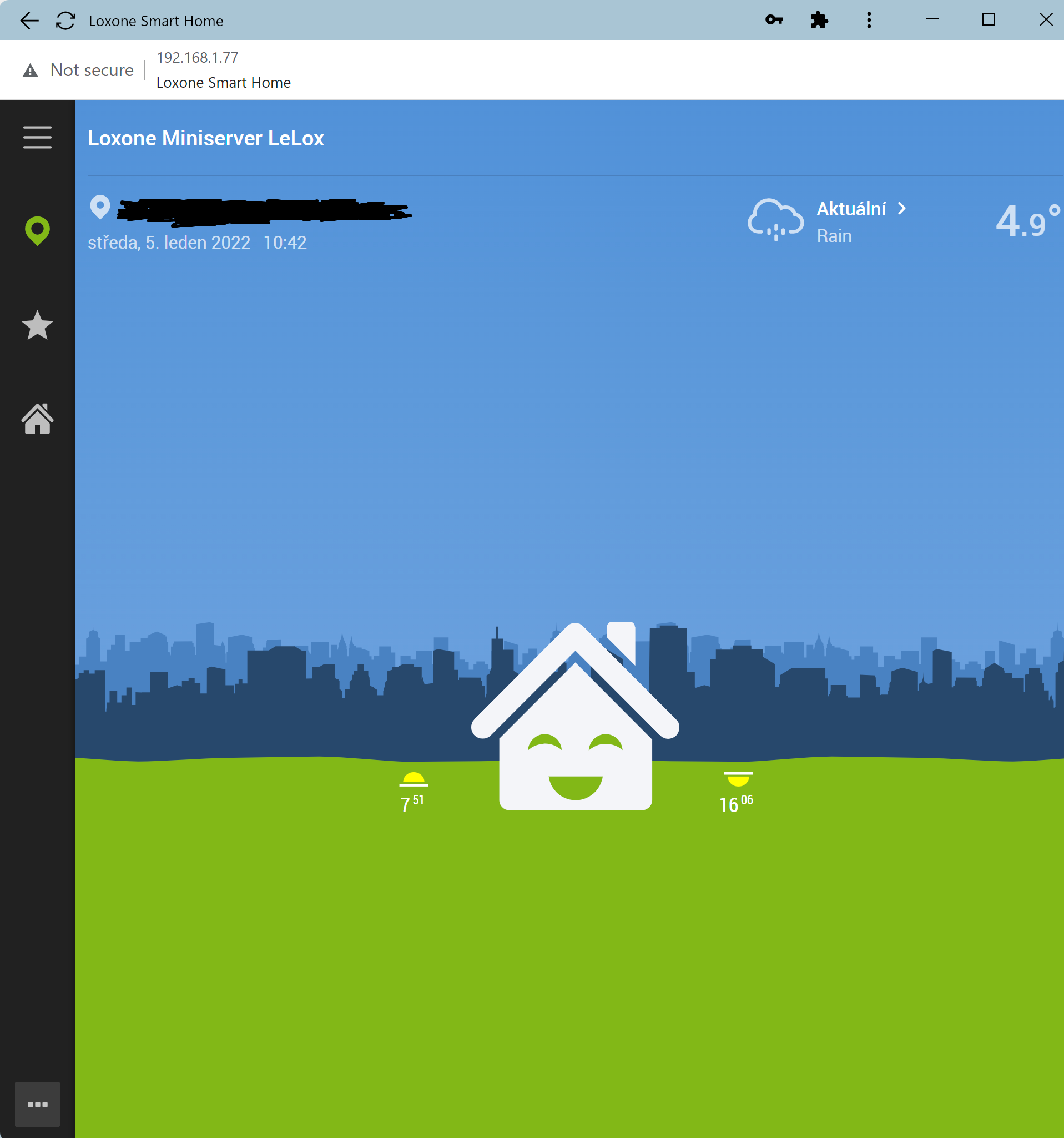

                  Prof.Mobilux
                  Awesome, thank you. I wanted this just for current conditions, not sure if forecasts are even supported from from WU.
                  PWS Current conditions:
                  Click image for larger version  Name:	Screenshot_110.png Views:	0 Size:	58.8 KB ID:	331730
                  Loxone/Weather4Lox before your change:
                  Click image for larger version  Name:	Screenshot_109.png Views:	0 Size:	142.8 KB ID:	331727
                  After:
Ansichten: 934
Größe: 142,4 KB
