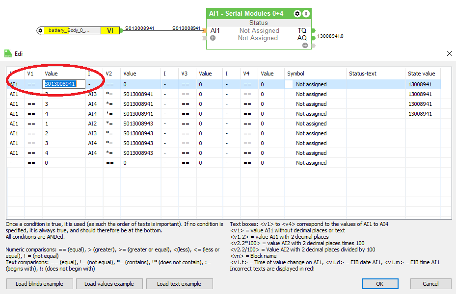

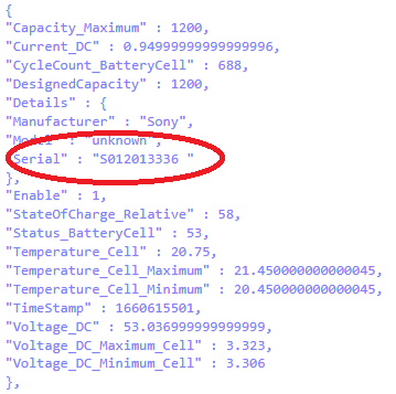

                  Hello Christian Fenzl. I have a strange experience with some MQTT data forwarded to the Miniserver as Virtual Text Inputs. When some VTI's arrive in the Miniserver, they are appended with a white space. This works fine when the Status Block comparison uses *= (contains).
                  This also works fine if the Value has the white space included and == is used. I have defaulted to always using *= (contains) with VTI's because the white space is not apparent when I come back to edit the Status Block (and I'll probably forget to include it).
                  The highlighted value has the white space visible only when the value is double-clicked -
Name: White space in Virtual Text Input.png
Ansichten: 376
Größe: 51,4 KB
                  It's not a problem as there's an easy work-around for it. Just wondering if this is by design?
                  I'm also aware of the Text-to-Value conversion, but I'm just trying to have all logic in one spot versus spread between Loxberry and Miniserver.

                    Hi @Tico,
                    What is the source of the value? Are you sure, that the source data do not contain the blanks?
                    You might follow the log that logs Input and output data, to see how the Gateway processes the data. Possibly you can find out more about.
                    • Tico
                      • 31.08.2016
                      • 1035
                      #326
                      An investigation of the logs confirmed the source data contained the blank also. It's from the Fronius 'GetStorageRealtimeData' for battery storage. I've found the MQTT Text-to-Value conversion made things easier in the long run and I've switched to that. Thanks for the great plugin.

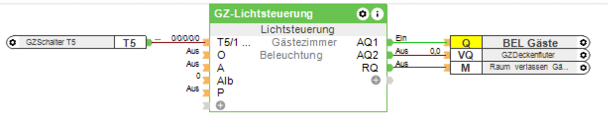

                        Moin zusammen,
                        ich habe ein kleines Problem, welches ich nicht nachvollziehen kann.
                        Ich habe einen Deckenfluter vor dem ein Shelly-Plug-S geschaltet ist.
                        shellies_shellyplug-s-EF66D7_relay_0
                        Er ist im WLAN eingerichtet und ist auch über die Shelly APP ein- und ausschaltbar.

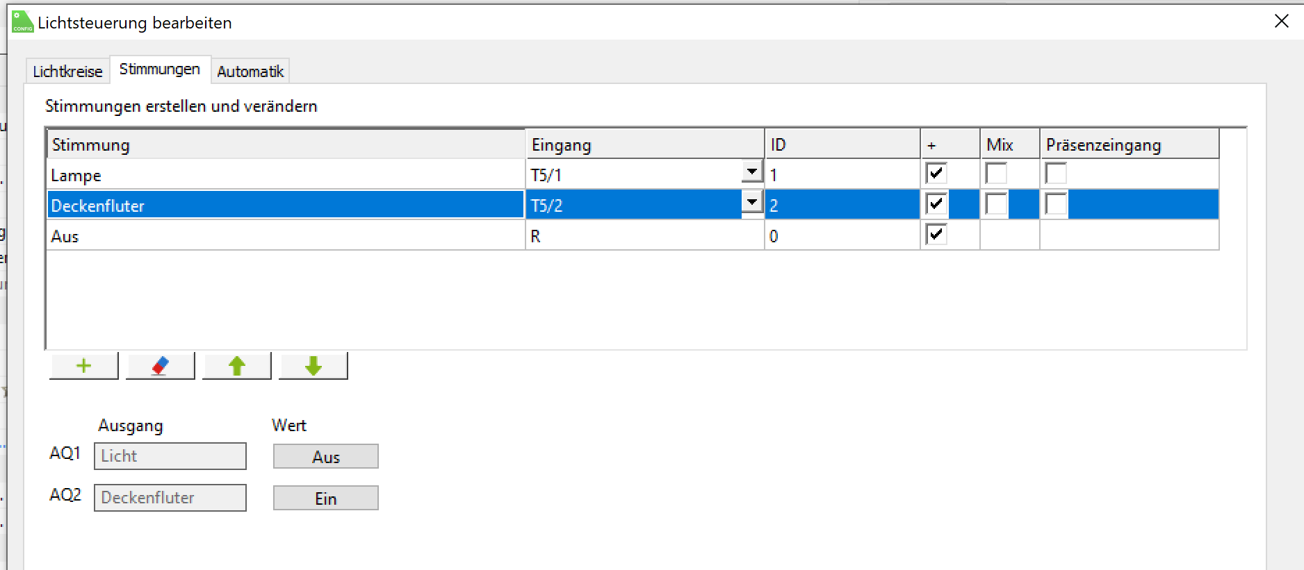

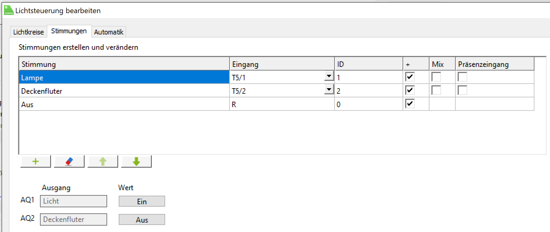

                        Jetzt habe ich in der Konfiguration (12.1.7.16/Webinterface 12.1.4) einen Lichsteuerungs BS angelegt.
                        Klicke auf die Grafik für eine vergrößerte Ansicht  Name: 2022-08-23 15_13_16-Loxone Config - zu Hause.png Ansichten: 0 Größe: 19,7 KB ID: 355765

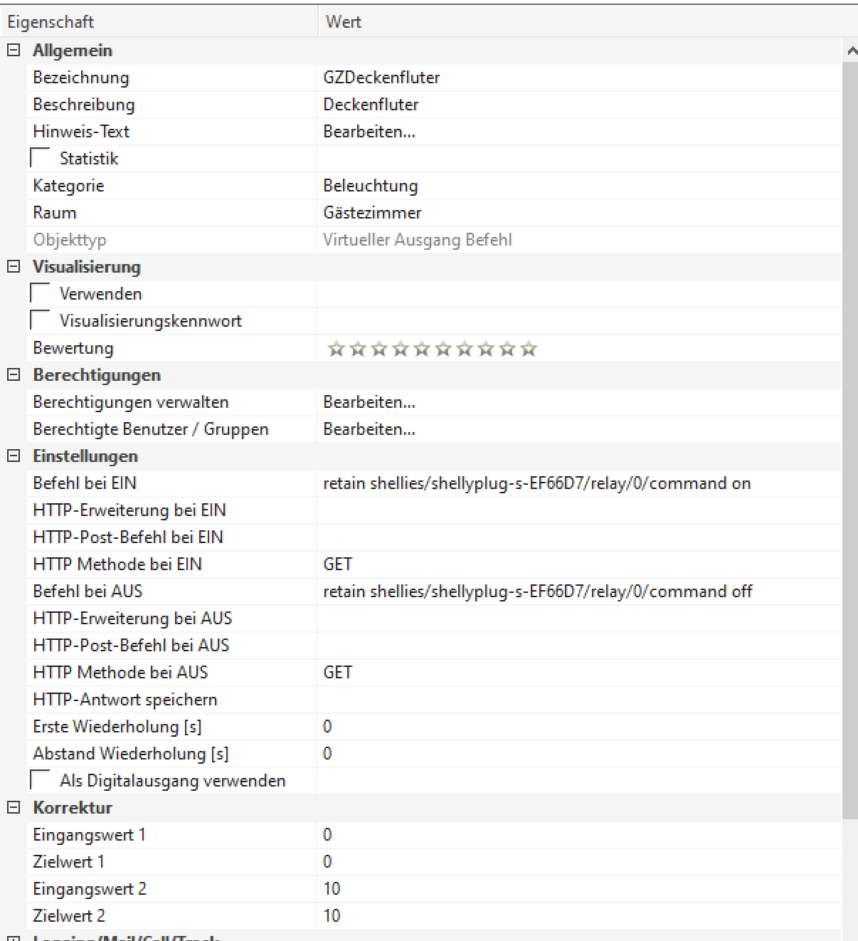

                        Den Virtuellen Ausgangsbefehl habe ich angelegt.
                        Befehl bei EIN: retain shellies/shellyplug-s-EF66D7/relay/0/command on
                        Befehl bei AUS: retain shellies/shellyplug-s-EF66D7/relay/0/command off
                        Den Baustein habe ich wie folgt konfiguriert.
                        Klicke auf die Grafik für eine vergrößerte Ansicht  Name: 2022-08-23 15_14_52-Lichtsteuerung bearbeiten.png Ansichten: 0 Größe: 27,5 KB ID: 355766
                        Klicke auf die Grafik für eine vergrößerte Ansicht  Name: 2022-08-23 15_15_27-Lichtsteuerung bearbeiten.png Ansichten: 0 Größe: 29,2 KB ID: 355767
                        Klicke auf die Grafik für eine vergrößerte Ansicht  Name: 2022-08-23 15_16_28-Loxone Config - zu Hause.png Ansichten: 0 Größe: 53,5 KB ID: 355768
                        Der Deckenfluter geht zwar an, aber nicht wieder aus...
                        Hat jemand eine Idee?
                        Im MQTT Gateway v2.1.0 wird das Ein- und Ausschalten mit 1 und 0 angezeigt - wenn ich die Shelly APP nutze
                        Gruß Günni
                        Zuletzt geändert von GünWün; 23.08.2022, 14:49.
                        • hagor
                          hagor kommentierte
                          Setz mal den Haken bei "Als Digitalausgang verwenden"
                          Damit funktioniert es bei mir

                        #328
                        hagor: Perfekt - das war´s - Danke schön - funzt!
