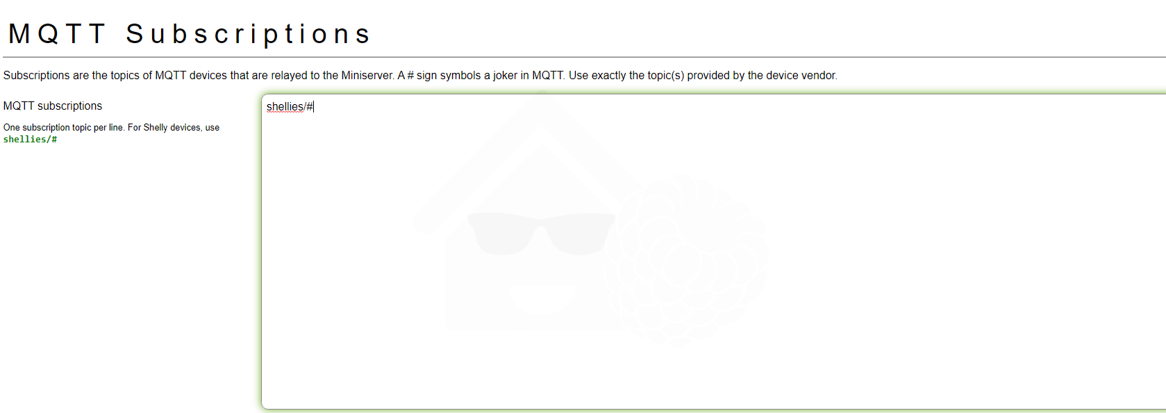

                I checked five times user/pass and read troubleshooting guide, but I don't have any idea what is wrong.
                Subscription page is clear, no one shellies inside :-(
Ansichten: 402
Größe: 44,6 KB
                In the attachmet please find full log. As you can said MQTT looks good.
                Regards.
                Jery
                  #414
                  Could you please enter the SecurePIN on the Settings page, press Save & Apply, and after that, the right Restart button.
                  Check in the footer line if Mosquitto goes to green again and gets a new PID.
                  It seems that Mosquitto still has a problem with a plugin config file (I thought I fixed this).
                  If this does not work, please install the plugin again, but without uninstalling it before. This should re-write all the configs, re-set the permissions and renew the symlinks.
                    #415
                    Yes, masquitto get new PID.
                    But I still don't see any input from shelly.
                    I install MQTT one more time without any error.
                      In Shelly, try to use loxberry's ip instead of the hostname.
                      I tried this, but still don't see any input.
                      I don't have more idea what to do :-(
                      For connect to shelly I use direct IP adress, if I use host name I can not reach shelly.
                      I mean from web browser.
