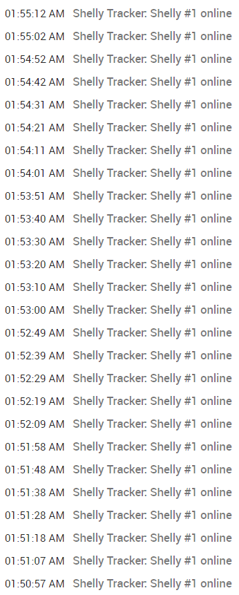

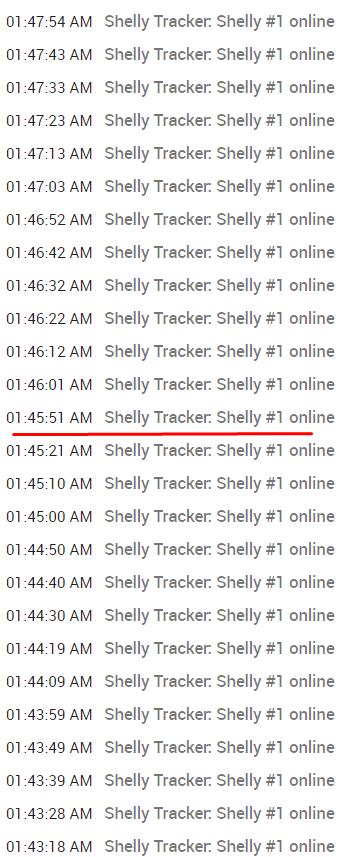

    Regarding your latest build and delays - I have tested your latest build, thanks for it.
    It starts to improving things at about 4ms. It looks almost completely reliable at 8ms, but then there's suddenly a couple of messages were lost. (I have observed it for couple of minutes only):
    Click image for larger version  Name:	Screenshot_20.png Views:	0 Size:	100.5 KB ID:	232160
    10ms looks great, but it may require longer testing.
    Click image for larger version  Name:	Screenshot_21.png Views:	0 Size:	100.4 KB ID:	232161
    I'm worried if this value is valid everytime and for everyone, if it's universal safe value. What if it depends on the miniserver CPU load or similar? This could mean even if we settle with let's say very "safe" value of 20ms, there may be circumstances when it's still not recognized.
    By the way, does this apply only and only to two messages for the same virtual input, ie. if 2 different MQTT messages (for 2 different virtual inputs) come at the "same" time, do they get recognized? Do you know? We may want to test this as well.
    Regarding https://www.loxforum.com/forum/proje...002#post232002
    2) I have noticed that neither "reconnect" UDP command nor "Retransmit all data (for testing)" button in the plugin ui won't resend the "connect" topics. Is it because of LWT? Is it intentional?
    Is it intended or should I open a bugreport at github?

      Retransmit: Current Implantation only retransmits RETAIN messages, as retransmit does a re-subscription. If the LWT from Shelly isn’t coming in on subscription, that would be a bug of Shelly, I think.
      This could be verifyed by mosquitto_sub if it comes in.
      The resetaftersendms delay only is used if a resetaftersend topic is coming in. If nothing comes in, no delay takes place.
      Incoming MQTT messages are queued by design of the broker. The plugin need not to queue the incoming messages. The delay takes place on a per message basis. Two messages on the same topic therefore are handled in the correct order (1-0-1-0, has two delays).

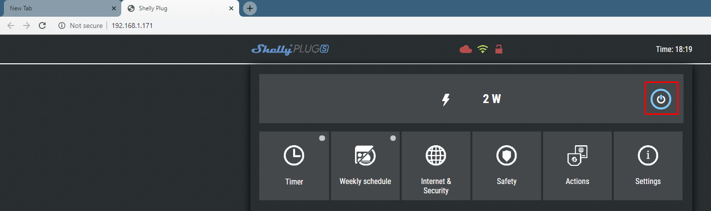

              Check if your Shelly responds timely via its own web page
              (here:
Ansichten: 984
Größe: 67,9 KB
              If this responds timely, check MQTT, for instance via (https://mqtt-explorer.com/) - does it respond timely if you send the command to switch it on / off?
                yes, on shelly respons timely.
                I checked with mqtt-explorer, like I said in previous mail, cca 10s need signal to MQTT.
                Any idea?

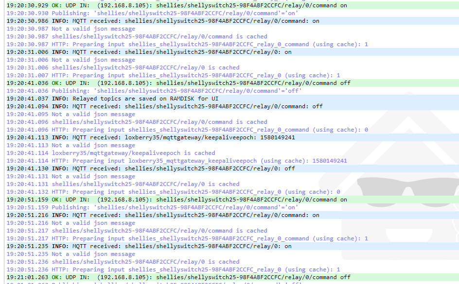

                Check the Gateway log, if the udp Input appears timely.
              #442
              Here is a log file, same situation, cca 10s. When I heard relay I timely change the state from on/off or on/off.

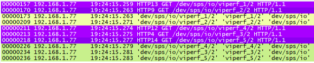

                Still, I have performed the test to have a better understanding of Loxone behavior. Seems that Miniserver (v1 with 8.3.3.21, YMMW, newer versions (9.x, 10.x) on MSv1 are known to perform worse AFAIK) handles higher load without bigger issues. At least on my 5 virtual inputs manipulated in sequence as fast as possible (some test attempts were just 1ms from each other), it worked reliably.
                I have performed
                 for i in `seq 1 5`; do
                curl https://$USER:$PASS@192.168.1.77/dev/sps/io/viperf_$i/$num &
                done
                many times in the row.
                The timing on Loxone was like:
Ansichten: 980
Größe: 16,6 KB
                This is good news. That issue I have discovered with skipped messages really relates ONLY to fast consecutive manipulation of the SAME virtual input.

                  The log states, from publish to receive it back from the broker, are 70ms.
                  This is a broker<->Shelly problem.
                  Of course, I don’t see the delay from Miniserver button press to gateway UDP receive, but you would see the delay if you follow the log. I don’t think there is any.
                  Zuletzt geändert von Christian Fenzl; 27.01.2020, 20:44.
