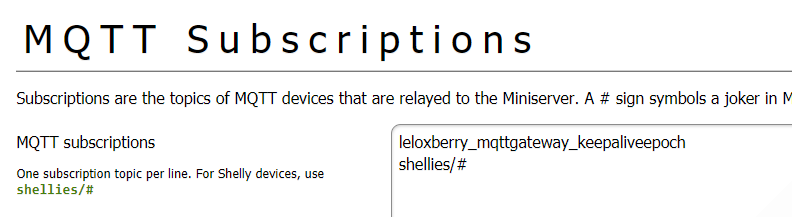

        Subscriptions:

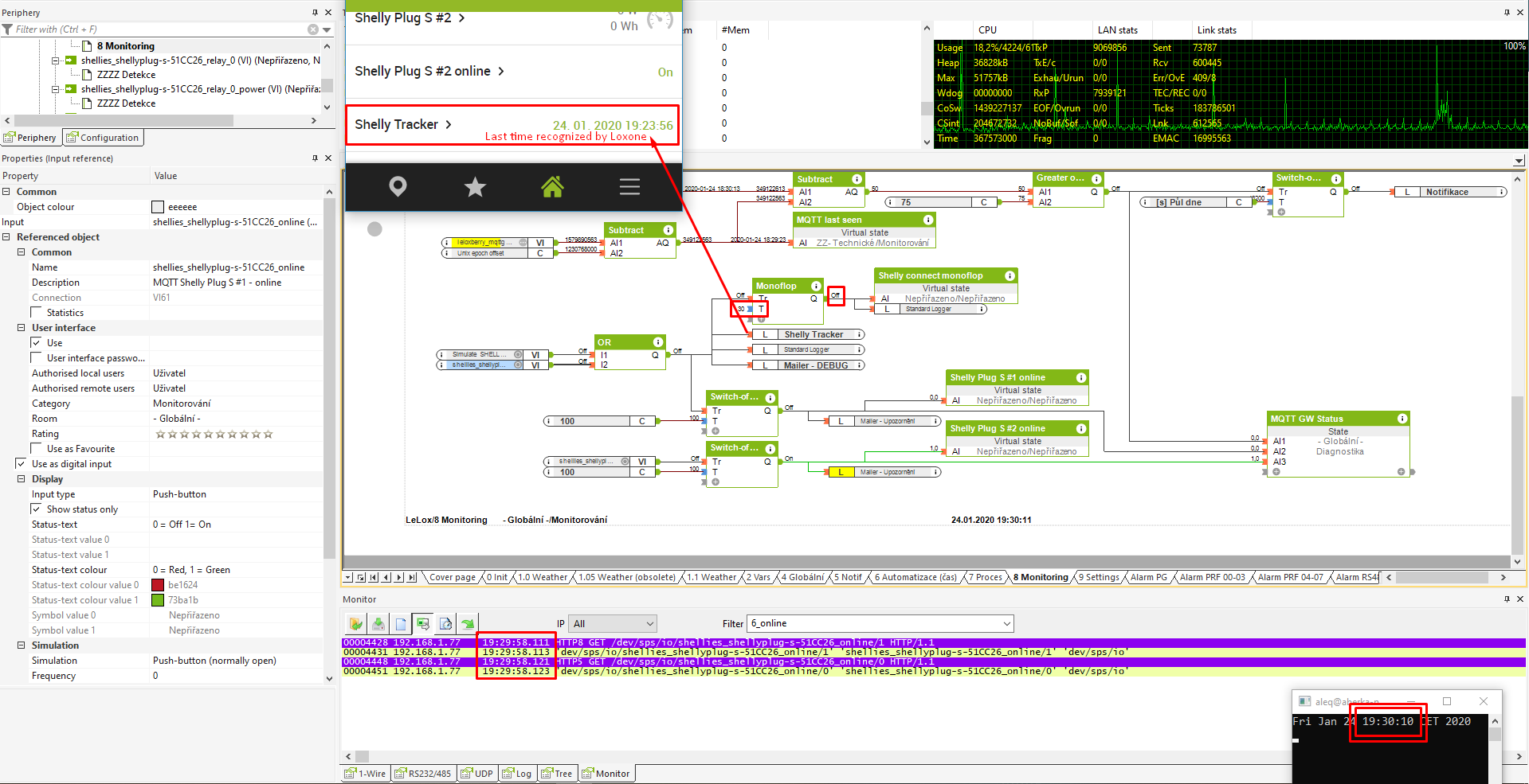

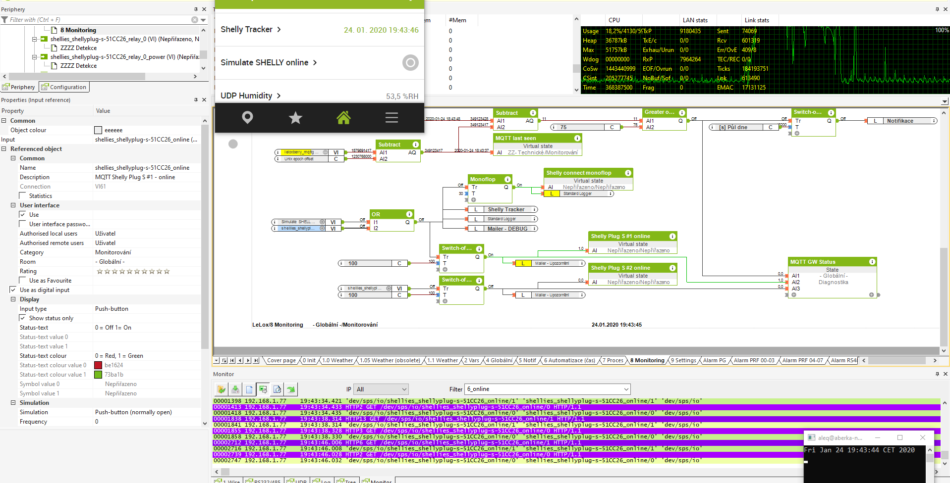

        Loxone Config program, screenshot captured 14 seconds after the HTTP REST has been triggered. Monoflop has 30s cooldown, yet it's off. No notification in tracker, nothing in mailbox. It really did not get recognized

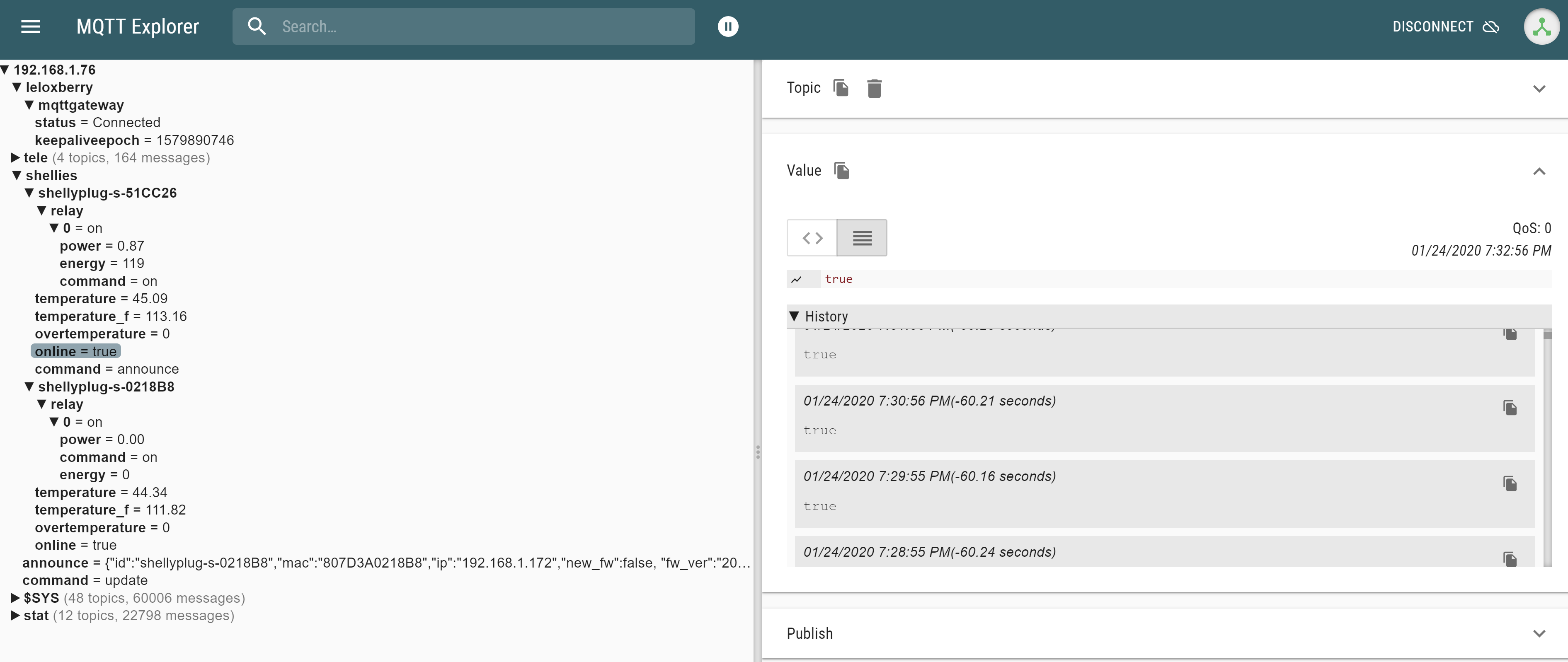

        MQTT Explorer showing history of those messages:

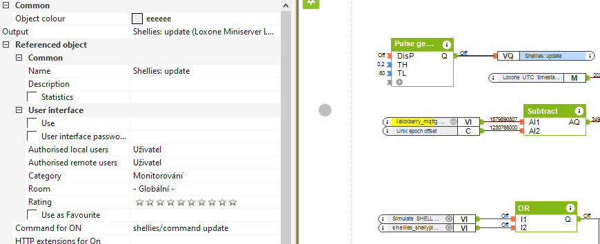

        This is a part of the program responsible for querying the status every 60 seconds

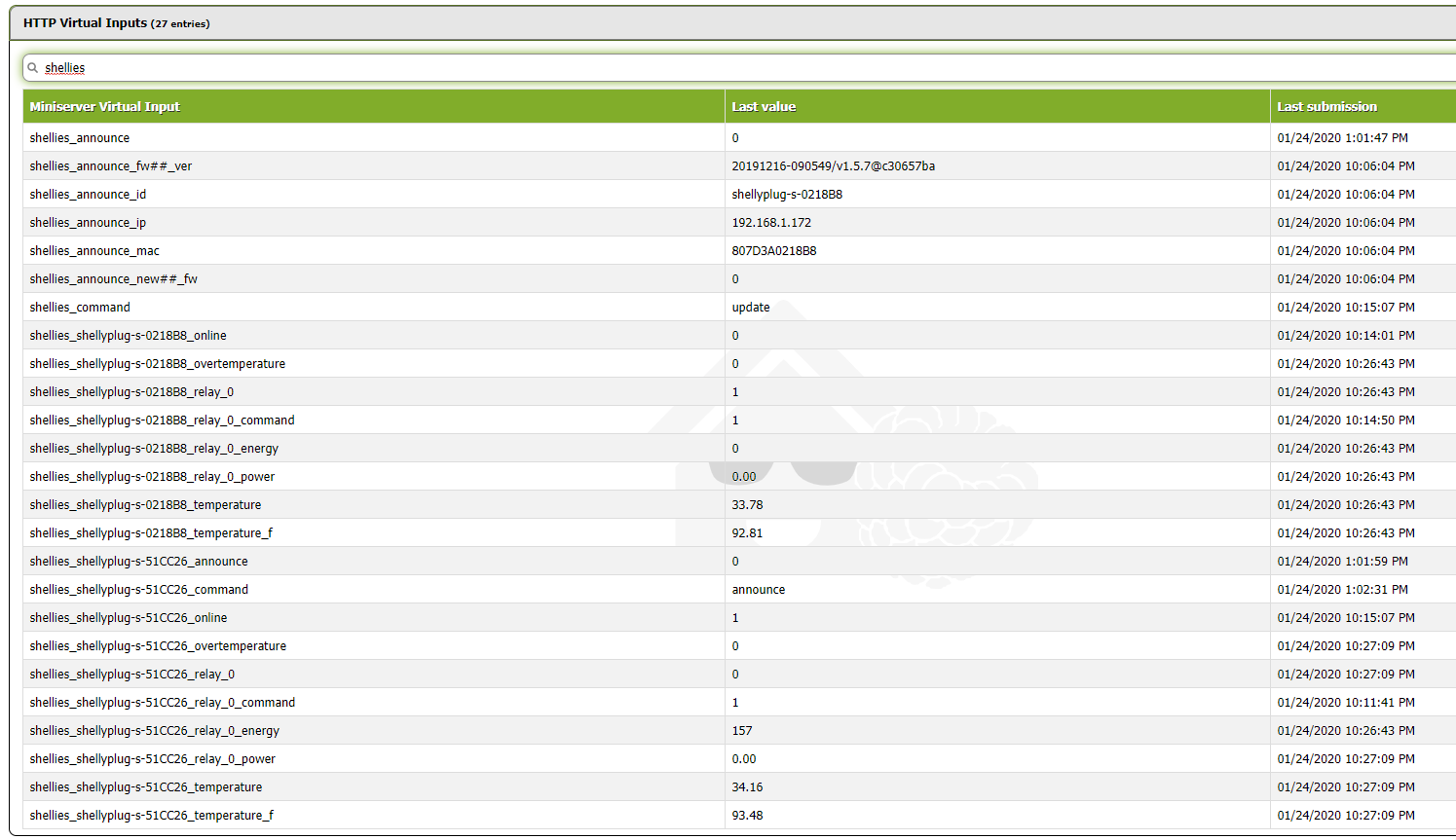

        And this is after several tries (I have manually sent "shellies/command": "update") - about 3rd response got recognized by Loxone:

          Online state: It is Shelly’s LWT topic (Last Will and Testament). The Broker will set the LWT topic to offline when the connection is dropped.
          Therefore, no Reset-After-Send is required. It will go to “Offline” (convert it to 0) if Shelly dies.
          Try it by disconnecting Shelly from power.

            Beautiful, it works (in MQTT explorer). I was not aware of LWT. I'll try it in Loxone Config, I assum it resolves this issue for me as I'll abandon the Reset after send.

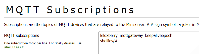

                The MQTT Gateway itself has an LWT. It’s <hostname>/mqttgateway/status
                In MQTT Explorer you’ll see it changing if you kill mqttgateway.pl.
                Unfortunately, no-one would submit this message to Loxone 🤪
                Therefore, to check the Gateway, the keepaliveepoch is there, sending it’s timestamp every minute.
                You need to check this for change (see wiki).

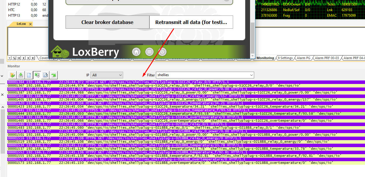

                  2) I have noticed that neither "reconnect" UDP command nor "Retransmit all data (for testing)" button in the plugin ui won't resend the "connect" topics. Is it because of LWT? Is it intentional?

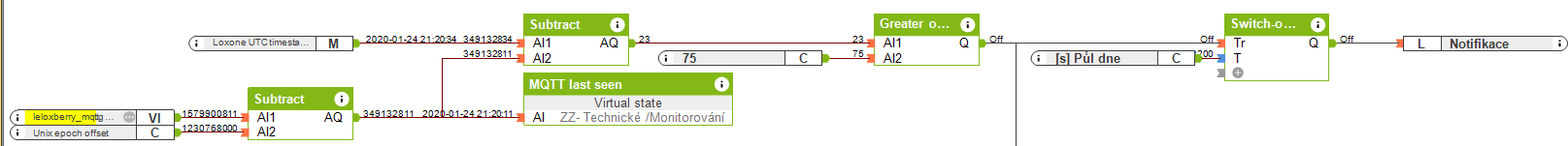

                      I have it as a digital input, yet that online "1" lights the virtual input and it stays lit until "0" comes. Plus I believe the primary purpose of "Reset after send" functionality was for push buttons, which are also digital. Or am I missing something?

                          See this example for a “non-over-engineered” change recognition: https://www.loxwiki.eu/pages/viewpag...pageId=9339459
                          Use Google Translate 🙂
                          If there is no pulse for e.g. 120 seconds, the Gateway is dead.

                            I know this change detection already (from here, from you https://www.loxforum.com/forum/softw...g-value-change - it is ingenious, by the way), but did not think of it in this process. Instead I calculated how long time has passed since last keepalive... This involved painful timezone difference calculation to the UTC, etc... Jesus!
