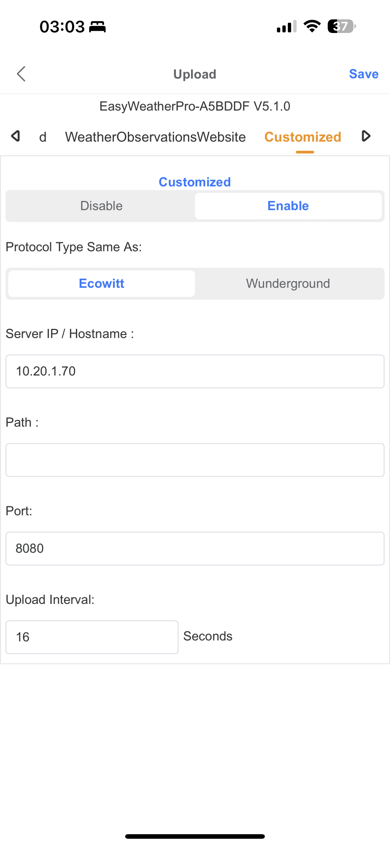

      I have been experimenting with FOSHKplugin - generic version, and was able to successfully run it and submit data to WeatherWizz. However, because I was on a Mac and not Linux, I could not run it as a service, only an application from the terminal.
      So, I created a Debian Linux virtual machine on my Mac with Parallels and was able to successfully install FOSHKplugin - generic version and run it as a service. I can access the server and see the help pages. However, for some reason, no matter what I do, the Ecowitt HP2560_C is not passing data to the server. It passes to other services without issue. I am using the settings I was using on my previous Mac install, just a different IP address, but data is never transferred. I have run through all of the troubleshooting tips but still no luck. I have checked the log files and everything is starting as expected, but just no data is arriving.
      I've attached the two log files and and my config file as well as the setting on my weather station.
      Cheers,
      Jeff
      • olicat
        olicat kommentierte
        Hi!
        You have to specify the path in WSView Plus: /data/report/
        Oliver
      • jmottle
        jmottle kommentierte
        Thank you! That solved it.
