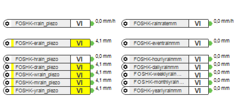

        Thanks! Are those names going to be with mm suffix or without in the future?
        What values should I use?
        I see drain_piezomm=4.09 and FOSHK-drain_piezo [4,09] in the UDP monitor (and all data in pairs for that) and I'm a bit confused
        Btw, strangely I'm unable to remap those values to translated names as you suggested on wxforum (but with translated names with mm not in[ch])
        I've added
        FWD_REMAP = rainratemm=@rrain_piezomm,eventrainmm=@erain_piezomm,hourlyrainmm=@hrain_piezomm,dailyrainmm=@drain_piezomm,weeklyrainmm=@wrain_piezomm,monthlyrainmm=@mrain_piezomm,yearlyrainmm=@yrain_piezomm
        In sections [Forward] and [Forward-1] and restarted plugin to reread conf file. But still translated data don't show in the UDP monitor nor in the Config
        Click image for larger version  Name:	rainfall4.png Views:	0 Size:	24.3 KB ID:	395105
        Zuletzt geändert von TomekWaw; 23.06.2023, 13:00.

          These names going to be with mm suffix.
          I guess you see them twice because the Loxone-UDP monitor shows them (also) as the Loxone-variables - the names of the virttual inputs.
          Regarding the remap function have a look to the help pages - the input names may be different - so just use in instead of mm.
          Oliver

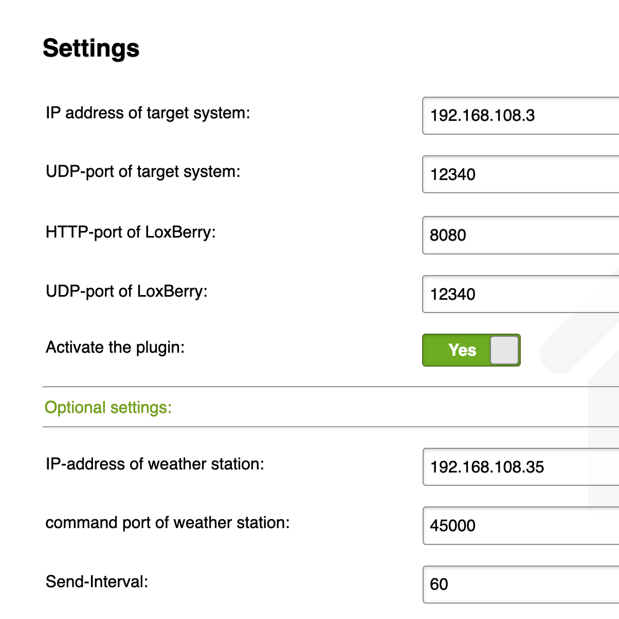

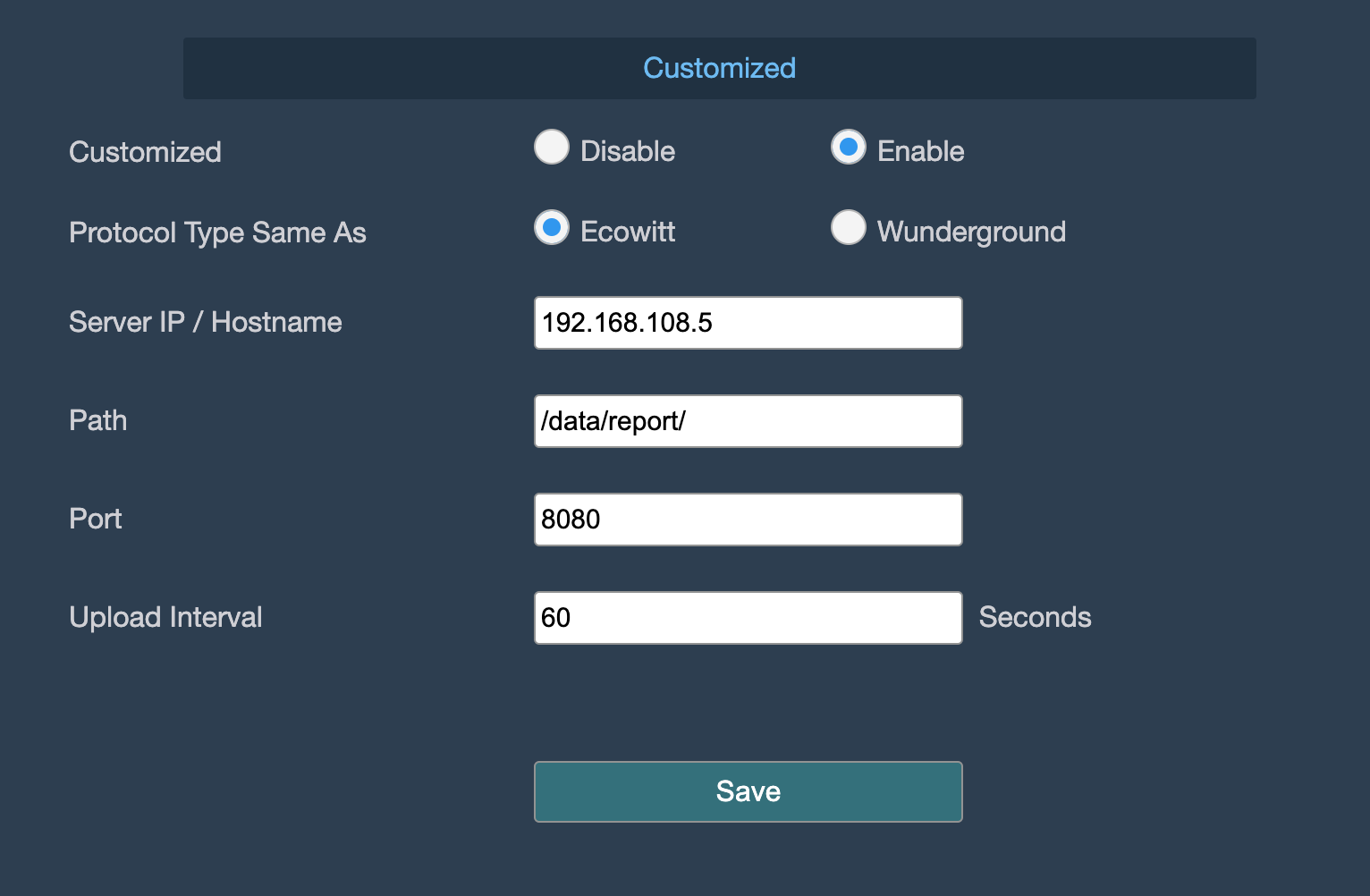

                I'm not really sure what kind of forward I am using. I have my gateway configured with this:
                Click image for larger version  Name:	Untitled-15.png Views:	0 Size:	77.7 KB ID:	395231
                and the plugin with this:
                Click image for larger version  Name:	Untitled-14.png Views:	0 Size:	125.1 KB ID:	395232
                .3 is Miniserver, .5 is Loxberry, .35 is GW2000
                is this a special forward or automatic configuration?
                So anyway, I wanted to have that data also under generic names in case I would add WH40 to my system in the future. But I might misunderstood their purpose.
                Shell I just use the input in the left column on previous screenshot and forget about the inputs in the right column?
                  • 4083

                  That's the forward to the FOSHK Plugin.

                    You just use the standard and obviously no forward. You may click to the Optional settings - there you could configure a dedicated forward.
                    Or. - as I usually do - use vi and configure in the config file directly.
                    Anyway, I understand your approach and think of adding this feature in the future.
                    If you add a WH40 to your setup all the rain values of the WH40 are coming in with the old names and additionally also the values from the WS90 as something_piezo.
                    ​​​​​​So you can compare and make use of the much more faster rain detection of the WS90.
                    Oliver
                      O my god I totally missed all those options I thought "Optional settings" is a header for last three input fields
                      I think I understand it all now.
                      I will keep using the data inputs I have and upgrade the plugin to future versions when you release them.
                      Thank you Oliver very much, you're very patient to my questions and helpful with your answers.
                      And [in general] thank you very much for this plugin, I believe I going to be a long time user.
